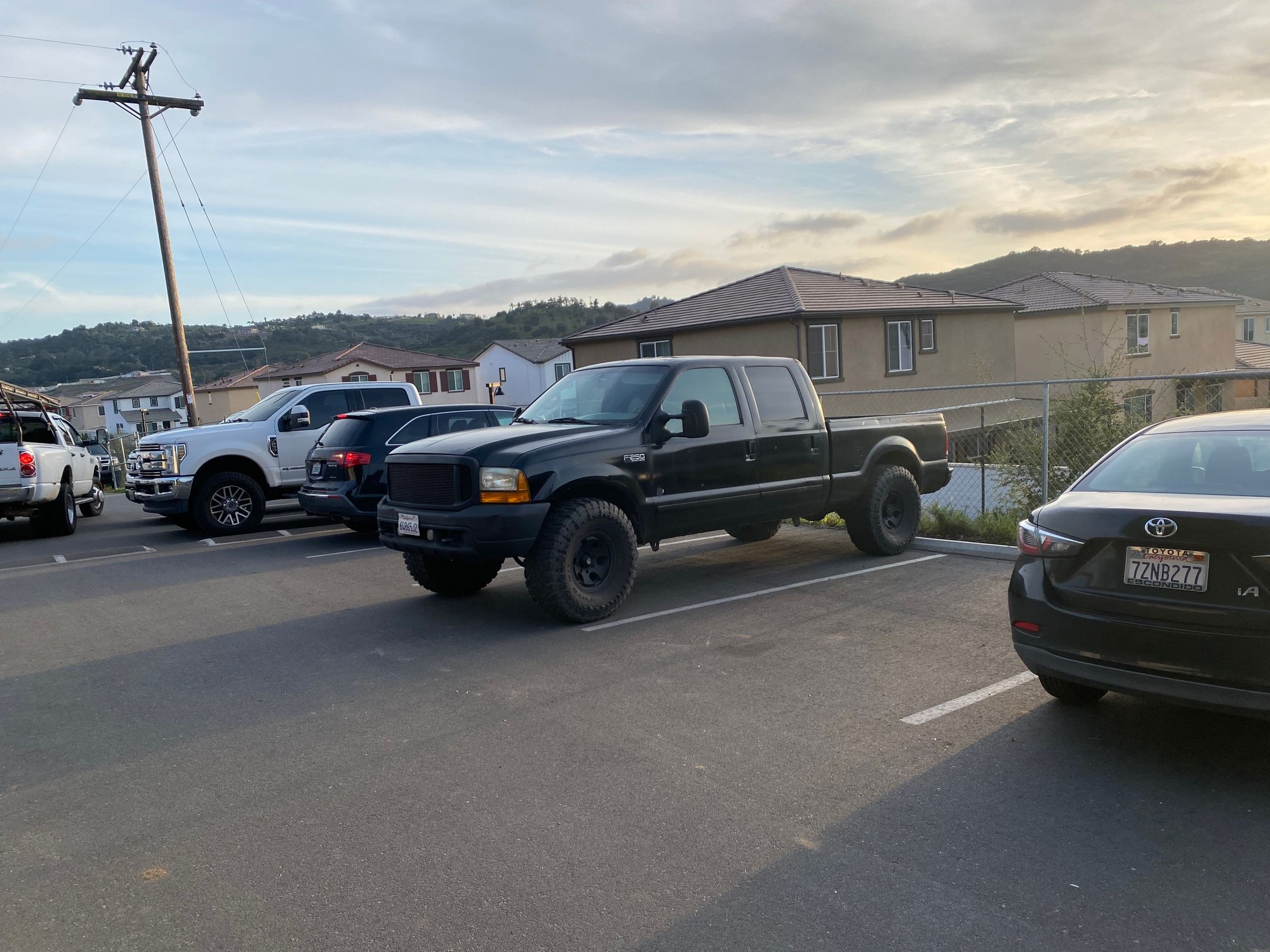

Another 4x4 conversion thread
I know this subject has been covered countless times so sorry if i offend anyone but I’ve read about 30 different ones and can’t find the answers I’m looking for. I know some people are gonna say just buy a 4x4 but that’s out of the question, these trucks are still 8-15k in my area (San Diego) so if I can convert it for half that I will be happy.
finding a crashed or blown up f250 is even hard haven’t seen any 4x4s in the last year almost, but there are some cheap excursions,
does everything bolt right up from an excursion?
What will or won’t work from excursions ?
my truck is a 2001 f250 v10 crew cab,(4 door) standard bed,
if I did find a blown up truck does it have to be the exact same truck for the driveshaft and everything to work? I obviously want to get the truck or excursion that the most parts are gonna work for me so I have to buy the least amount of other stuff.
I need 4x4 for my property, this thing is pathetic if my dirt is wet at all, even on mud terrain 37” tires completely air’d down to almost nothing, it’s useless. My 2wd navigator did better than this thing. Which is what I traded for it. Which I drove 2 hours to trade for a 4x4 f250, but when I got there the guy had this 2wd I noticed right away. Didn’t even want to trade but even a 2wd f250 is worth way more than a navigator, I couldn’t sell that Navigator for 2k bucks. I tried.
But also want to swap out this transmission because it barely stays in Park, my son was playing in there and yanked on the gear shifter one day and it just popped right out and rolled back into my wife’s suv! Luckily she was behind me. So now I just chalk the wheels every time I park it.
any help is much appreciated thanks for reading

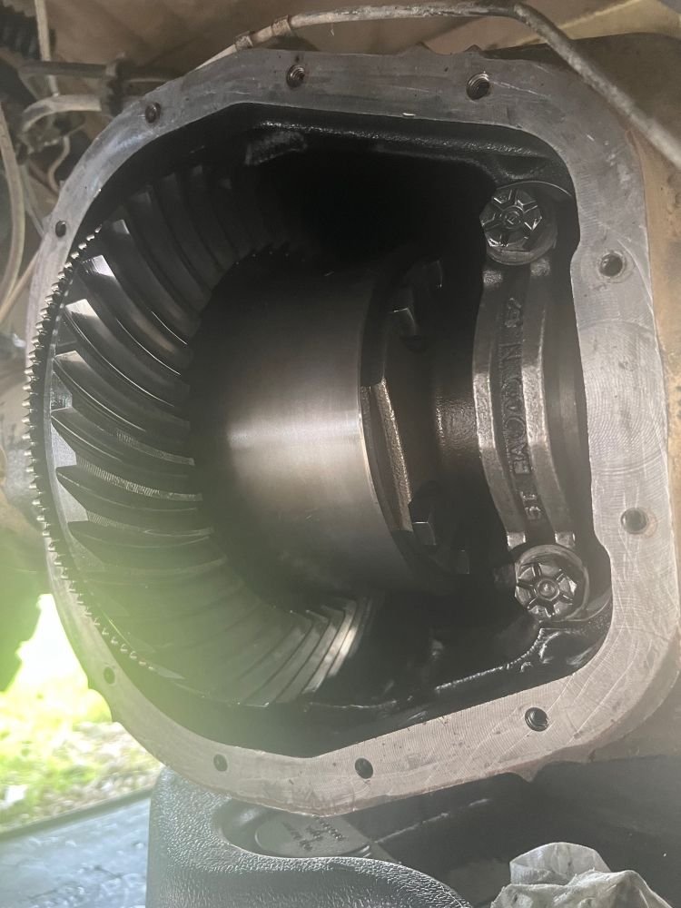

Originally Posted by F250760
so maybe invest in a locker and winch for now? until I find a doaner truck? But I’m assuming the locker is different for the 05+ and mine, so I probably need to know which doaner truck I’m gonna use..
Shouldn't be, the last time I checked all Sterling 10.5's use the same locker. For a general all-around type truck, I like the Detroit-Eaton TrueTrac. Technically the TrueTrac isn't a locker, it's a helical gear limited slip, but it just flat works everywhere, plays nice on the street and when towing too. I like them so much I have one in the rear of my Excursion and one in the rear of my Dodge truck .The Excursion also has a lunchbox style locker in the front Dana 60, so it does pretty well off-road for what it is, it certainly isn't going to keep up with rock buggy, but it's way better than most would think.
And if you're not changing the gear ratio, a rear traction aid (locker or limited slip) is an easy driveway install (messy / smelly for sure, but easy) with the only special tool needed being a dial indictor with a magnetic base (available cheap on Amazon or Harbor Freight)
As for winches (probably get some hate for this), for non-hardcore guys that aren't using their winch every day, the Harbor Freight Badlands series of winches are kinda hard to beat for the price (see link below). I have three of their 12K pound winches and all have been great for me.
https://www.harborfreight.com/automo...ope-59407.html
