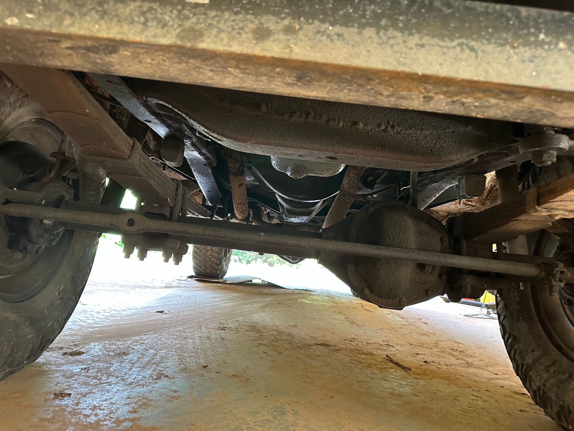

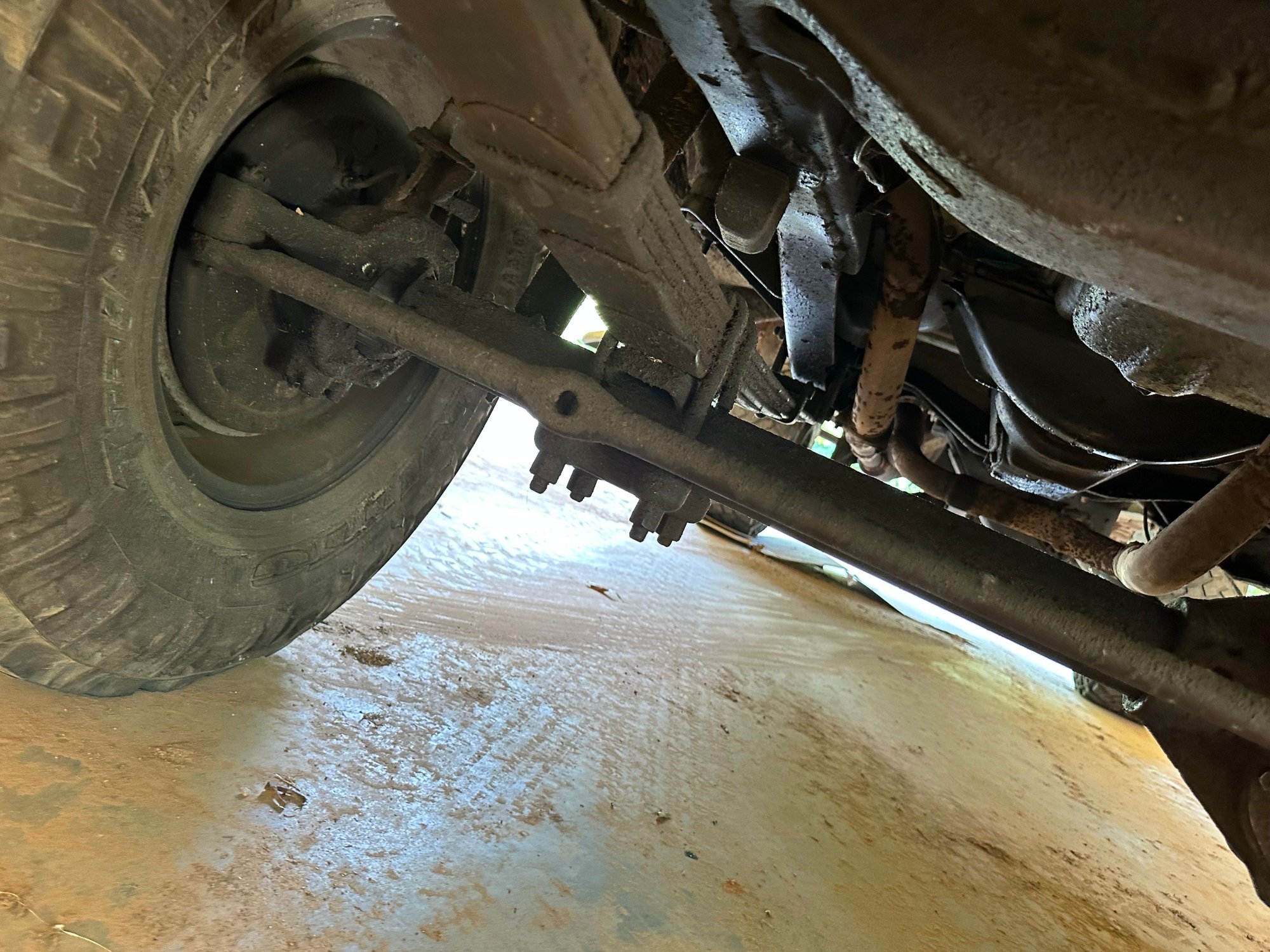

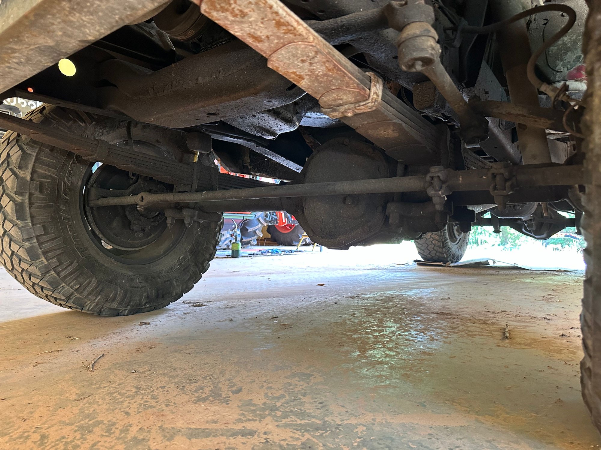

Sorting out a 1973 F250 4wd. I think there is a missing front stabilizer shock/sway arm component. However I'm having trouble figuring out what is supposed to be there and what is missing. Please see attached photos. Thanks so much for any help in advance!!

I think what I mean is the steering damper. should I have one? This truck does have power steering/power assist. thanks.

A high boy never had a steering stabilizer. that hole is for the steering cylinder, and you don't have power steering.

thank you. I do have a power steering pump. is that just power assist then? Sorry for my ignorance but I am new to the highboys.

Yes, you would have an actuator and a steering cylinder. it was a horrible system that drove awful and leaked oil even when it was fairly new.
I wouldn't waste the money on getting it back in order. spend a little more and buy a Benchworks conversion kit, it solves everything that was wrong with high boy steering.

Post up a picture of the steering box and pump, it's possible someone converted it to power steering already since you've said you have a power steering pump.

The pitman arm between the frame and spring tells the story.
