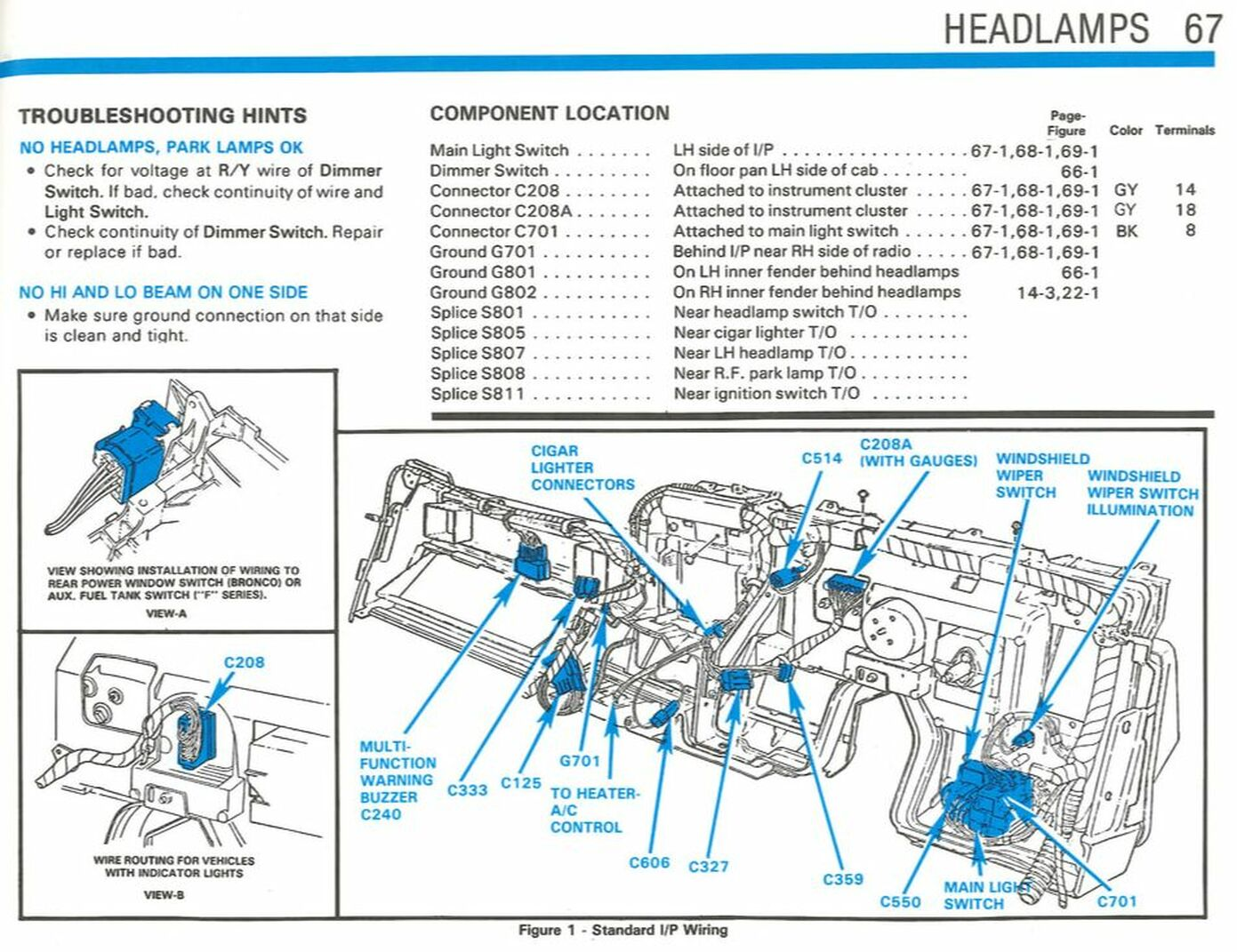

That might be connector C125, for the optional lights in the glovebox, digital radio, and under the dash. You can see it towards the left of the large illustration here:
I think C125 is part of the main harness, regardless of whether those optional lights (and associated harness) were installed. If not so equipped, the plug sits there empty. See page 84 here for the related 1985 wiring diagram, which should be close for your truck:

If C125 is the plug for under dash lights then maybe there is a harness that runs across the bottom of the dash that the 2 lights plug into?
I think once the main harness plug for the under dash lights is found then the rest will fall into place if there is a harness or not.
