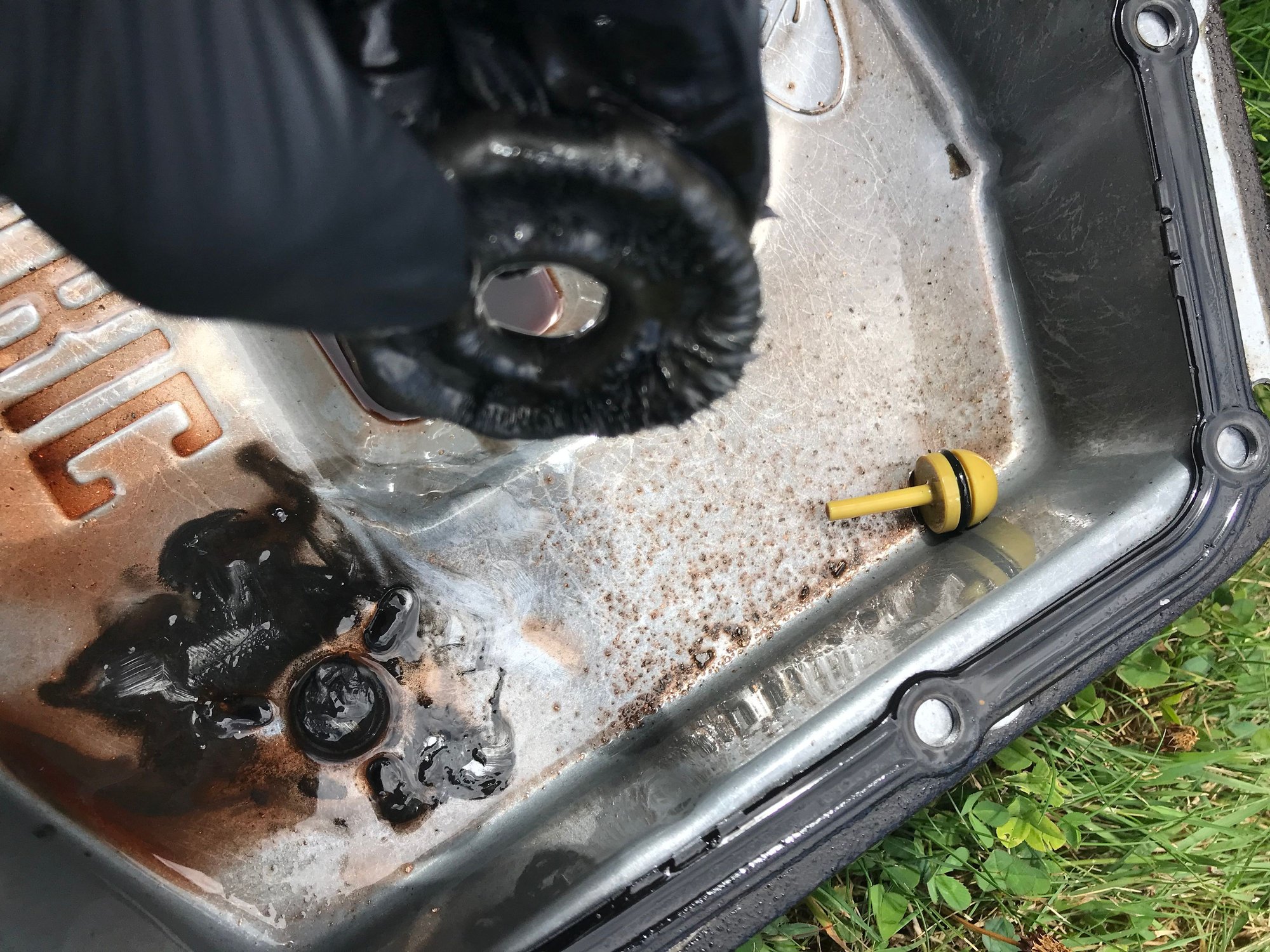

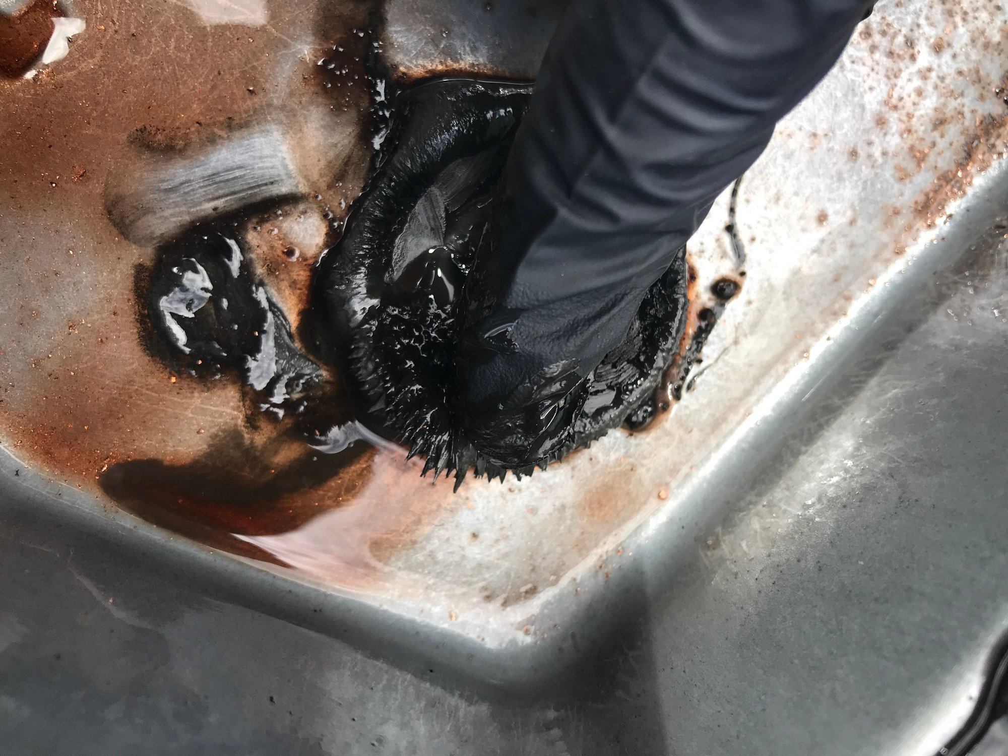

mike
Just dropped the transmission pan on my 2006 Expy 4R75E trans (please correct me if that’s not my transmission). Fluid looks dark, lots of metal shavings, and the original yellow dipstick stopper is is the pan (indicating it’s never been open and serviced at 107,000 miles). I bought 3 servos, filter, and 2 gallons of Mercon V. I’m going install the new servos, filter, and fluid. But I’m probably looking at a rebuild. Anyone know of a good transmission shop in the Tacoma, WA area? thx

The fluid and filter change won't help, it needs to go into a transmission shop.
