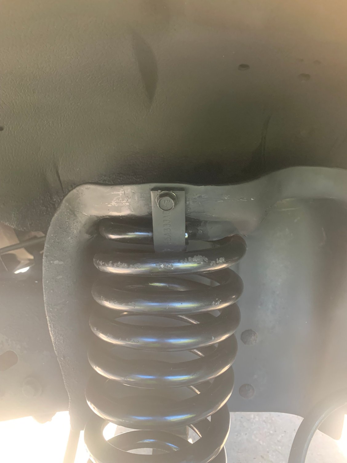

Under the truck this morning and noticed the spring is touching on the passenger side. I’ve included a pic.

Drivers side is good.
