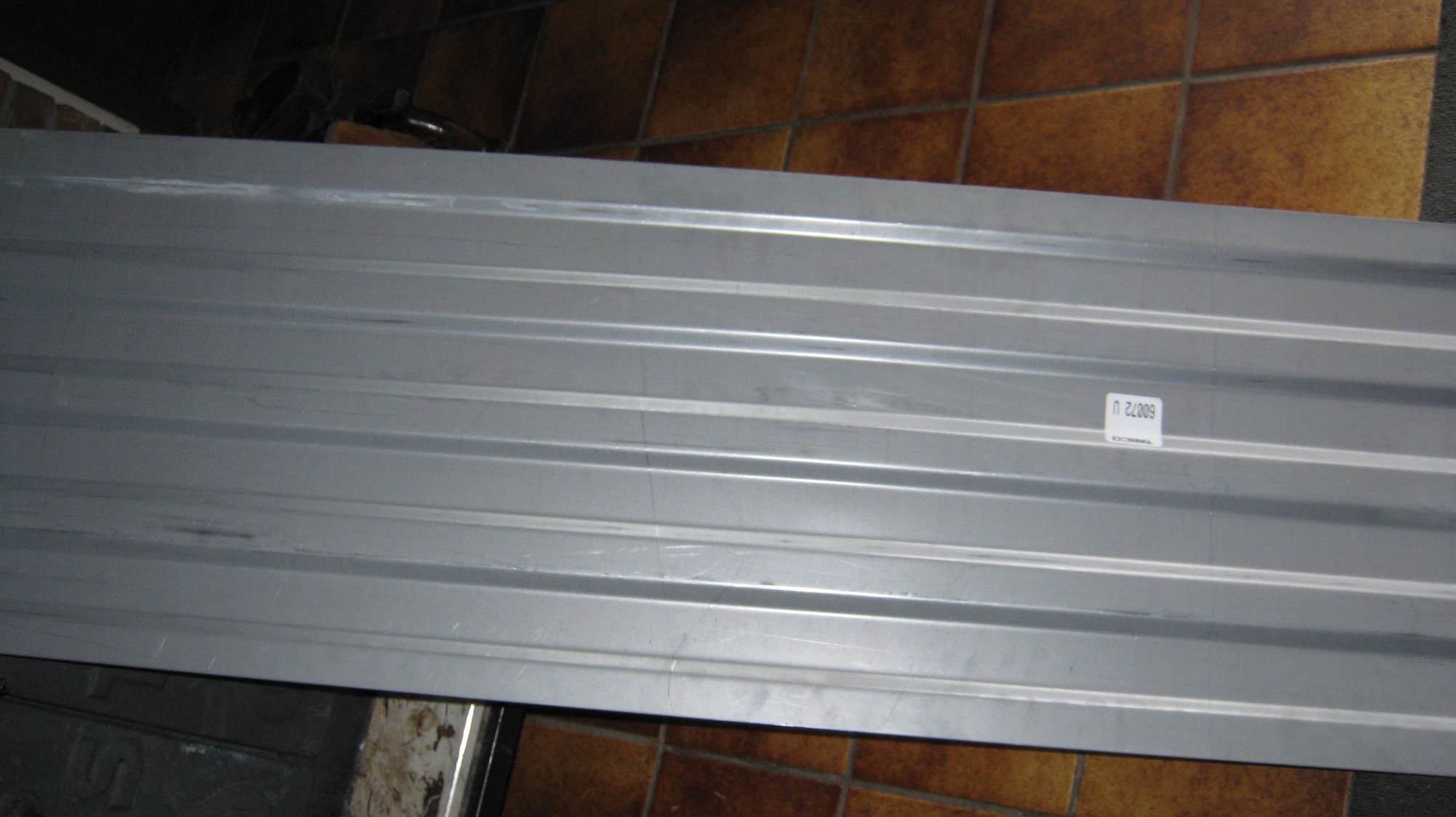

My "76 F-250 longbed floor is like swiss cheese, and I ned to replace it - the suggestion "just find a rust free one in a yard" doesn't work in the Northeast. I have seen Golden Star PB15-738 truck bed floor assembly at JEGS, bed floor assembly Part# X790-4573-8 at autometal direct, bedfloor assembly 49-9925-T from LMC. None of them are cheap, but I can't verify where they manufacture the beds.
Any opinions or experience? I've searched the threads, but don't see much on replacement other than finding a donor bed, which I don't think will work for me. Thanks

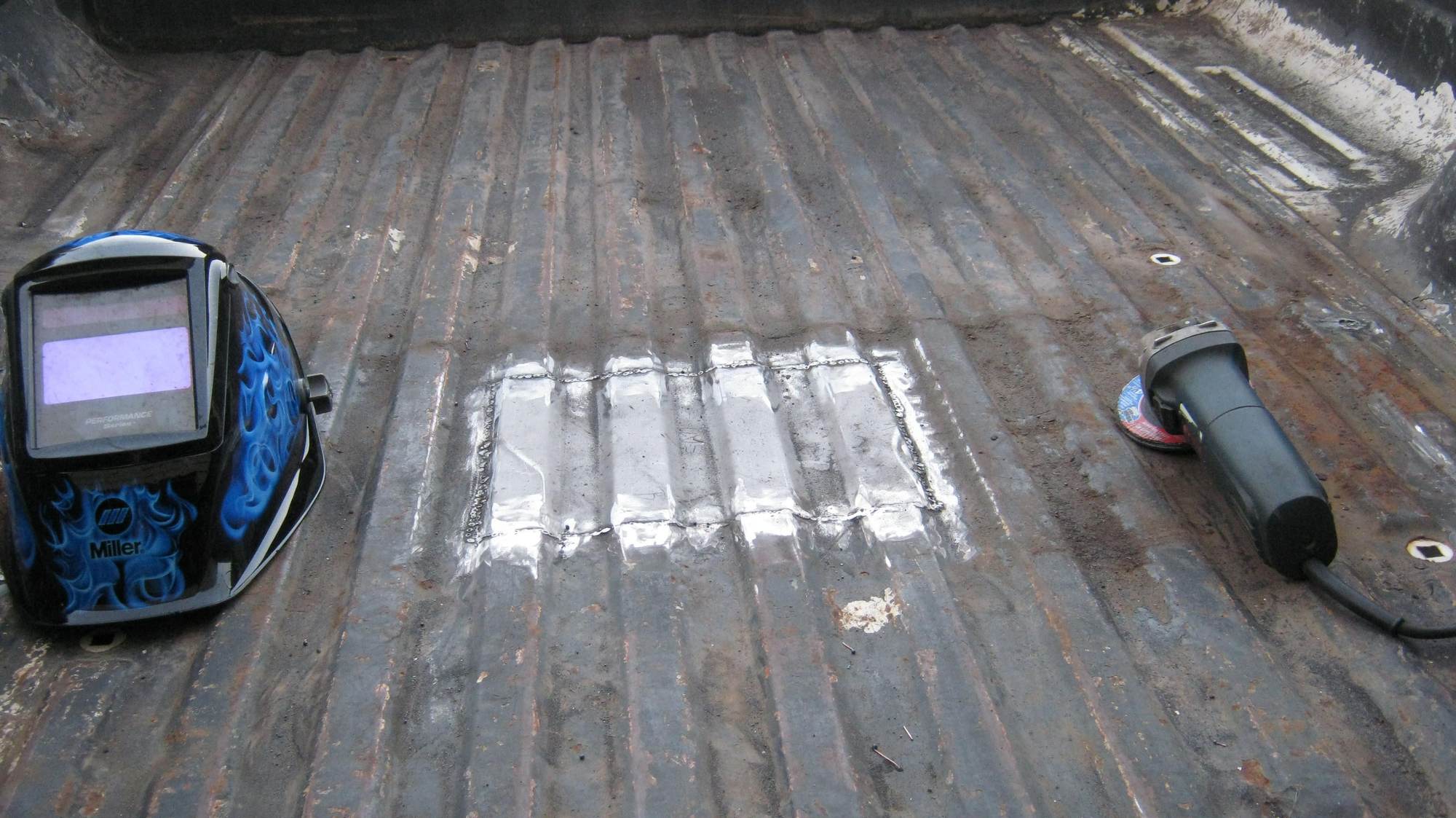

Weld over the hole and rhino line it?

If it's not a high dollar restoration I'd just seal it up with POR 15 or something and put a Penda liner in it.

Sheet steel over it, coat it, cut drains in, & use a Pendaliner bed liner.

auto metal direct is claiming original gauge ,,,,,,I would call them up if that is your direction Tabco sells small pcs 3foot by 4 foot going on memory
