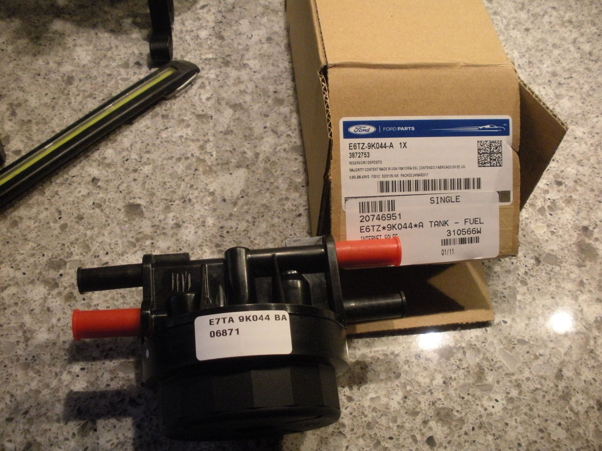

Do you still have the fuel reservoir? The round black plastic thing before the high pressure pump? Some people think they do not need that. And some of them did have a fuel filter inside also.

That reservoir and it's filter(if it had one) are on the suction side of the high pressure pump.
The low pressure pump sucks out of the tank feeds the reservoir and loops back out of the reservoir back to the tank. The high pressure pump is on it's own loop, sucking from the reservoir going up to the engine and the fuel regulator, and then back down and dumping into the fuel reservoir.

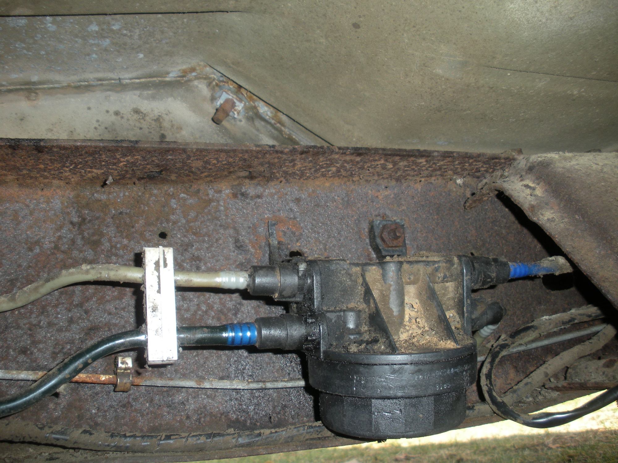

When my fuel filter was dirty, the truck would not accelerate when I pushed in the gas, I knew in an instant it was the fuel filter. Be careful with your 45 y/o housing, Seems they are no longer available. NAPA will have the element if you need.
It's located under cab on the frame rail.

I do not mean to hijack a post but I have that set up in my 1986 F-150 EFI. IF I were to check my filter how much gas would come out if I unscrewed the bottom "cup"? If I ever wanted to replace the reservoir (not thinking that now) will gas pour out of those lines once they are disconnected?

Yes, I keep my gas tank very low, as I don't drive the truck much. I had to pop the nylon clip out of the lines and pull the lines off and hold them up or fuel would come out of them. You can see the cup holds a little fuel too.

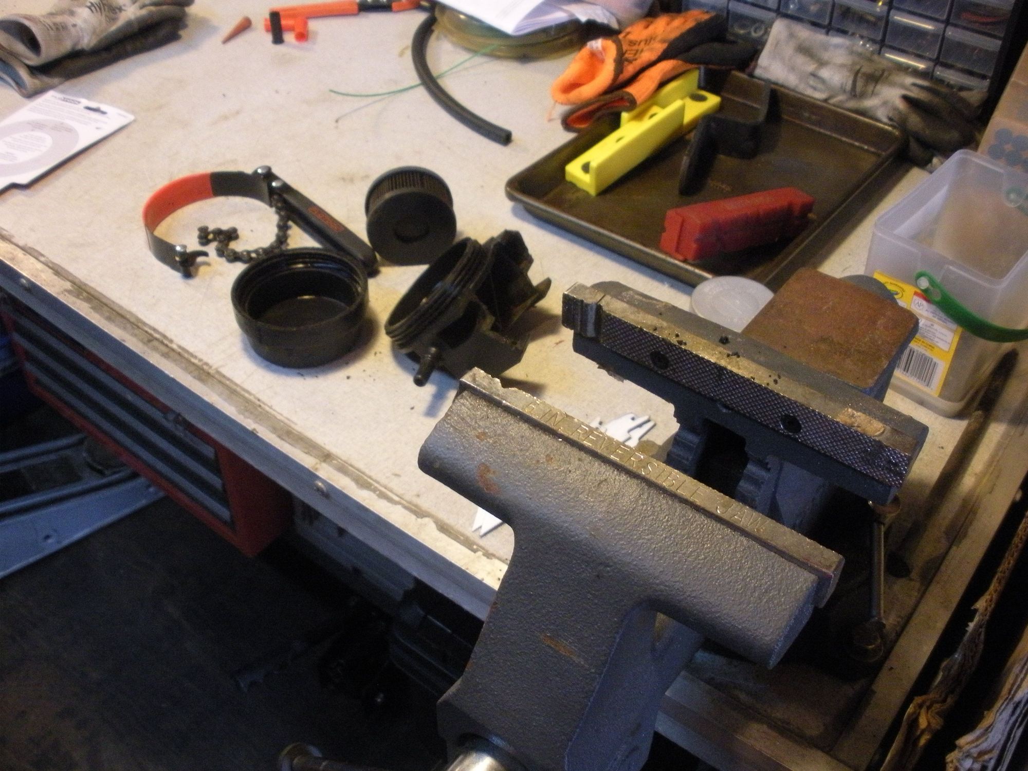

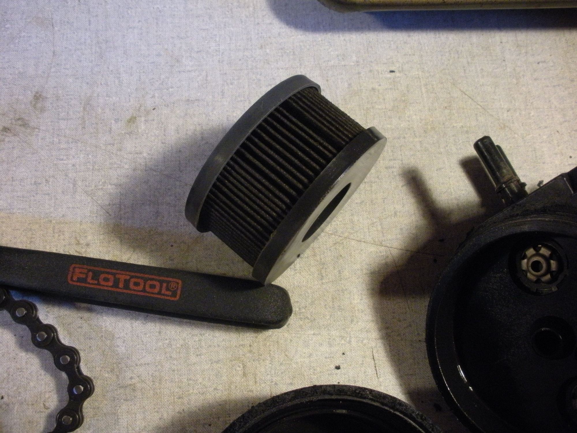

Oh, it's a lot of fun. Pretty much plan on taking that whole black reservoir assembly out and taking it apart on the bench. Main reason is it gets stuck bad and you need to be as gentle as possible while trying to get it apart. It's only plastic and if you break the single tank version, they don't seem to be making them anymore.
Ford considered the filter in there a "lifetime" filter and it would never need changing. I guess it wouldn't if you got a new truck before it was 10 years old. Now you are driving a old truck around that is over 38 years old. I guess you are not supposed to be doing that.
