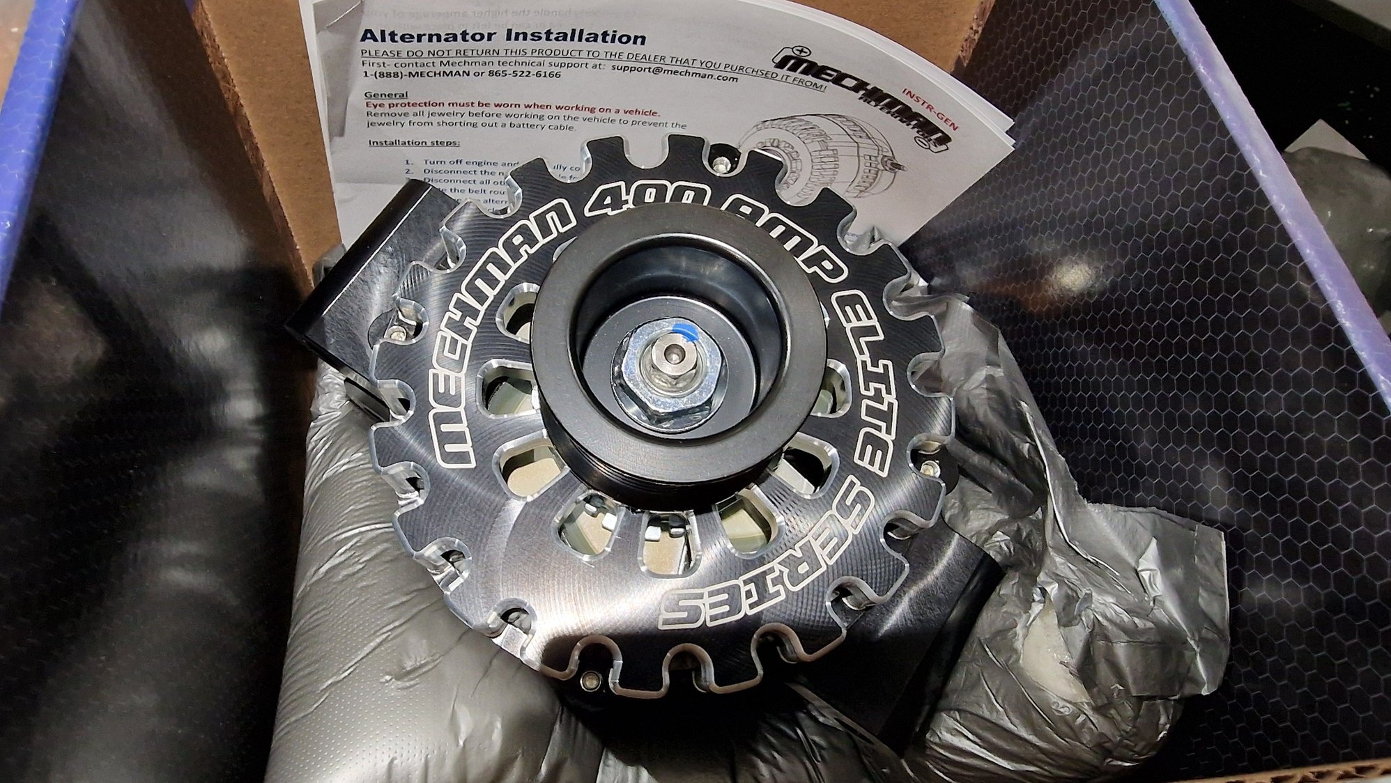

I'm just installing a MechMan 400 amp alternator for charging the LiFePo battery on our 5th wheel, they're a quality item & although I'll probably never need the 400 amps, it's better to be oversized than under......
