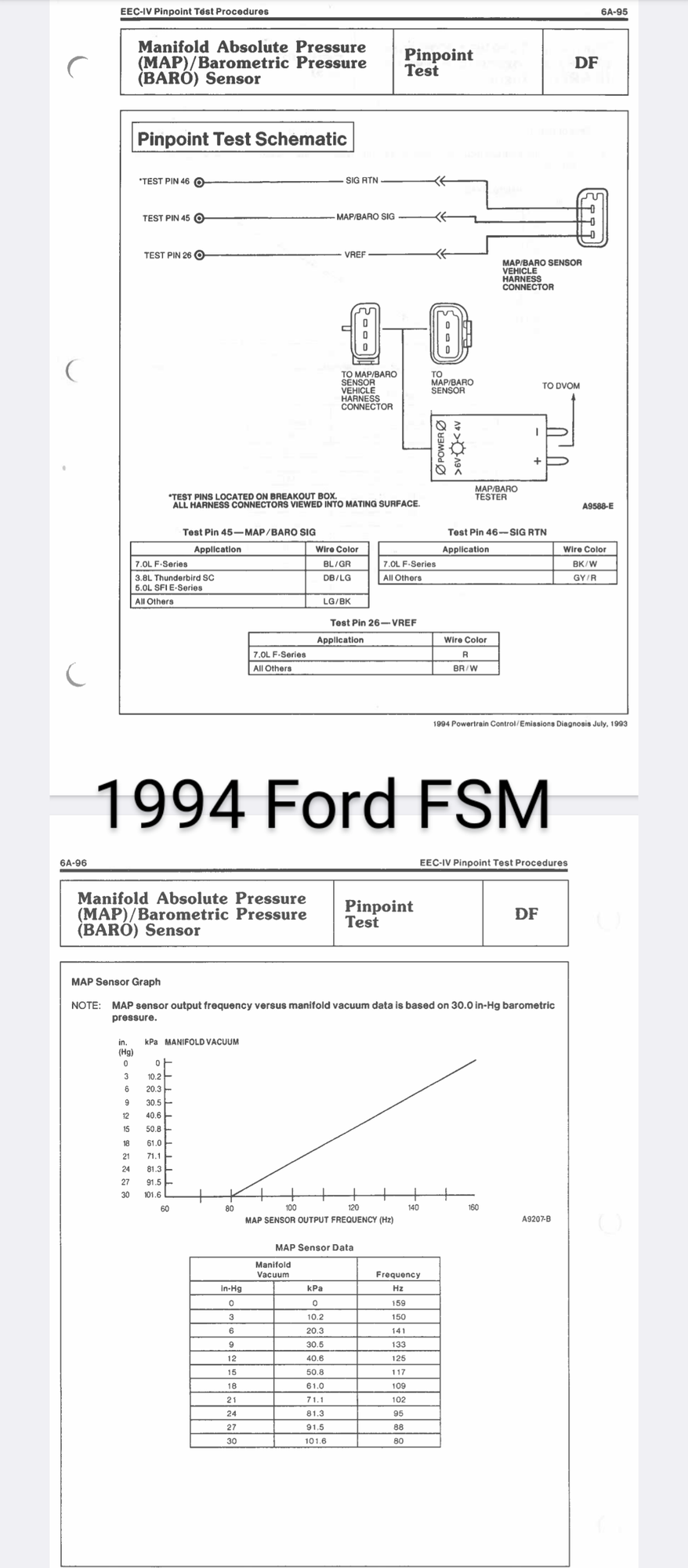

So I tested the MAP sensor to the best of my ability without a vacuum pump. I read in another thread that key on engine off I should have between 152 and 155 Hz and with the engine running it should be between 93 and 98 Hz. Well with my engine off and key on I have about 157. 156.9 to be exact and with the engine running I have 104Hz exactly. Seems high according to the other forum but not super high.
The forum in question: https://www.ford-trucks.com/forums/1...-testing.html#

Forgot to mention I also have about 2.77 V to the middle wire. Is that to high. The other forum mentioned it’s supposed to be at 2.5 V but didn’t mention a range.
