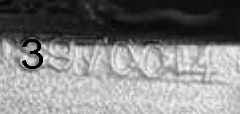

Hoping a few of you can verify what I see with my SBC engine casting numbers, I'm reading 3970014 which should be a 1970-1973 350 SBC. Anyone seeing anything different or have I lost my mind, my brother swears that is not what he sees. All help appreciated in advance.

I make it S970014

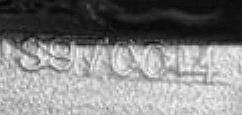

Originally Posted by mtflat
I make it S970014
I see an "S" sort of, but it does look like a "3" if you look closely. The "1" is kind of wonky.

With 4 younger brothers I can understand you don't want yours to be right but if he says he does not read what you posted, he is correct. I also read the S9 number. As far as Effie's photoshop, sure you change any number if you add and omit part of the casting.

If it is indeed a S, then what is it. When I look up the codes, I don't see anything starting with an S. Anyone got any ideas?

I took the picture so no photo shop or numbers omitted, the picture captures all the casting numbers there. When I look up SBC casting de-coding numbers, none start with an S hence I thought it must be a 3. Do you know any sight where I can find casting codes that may be helpful?

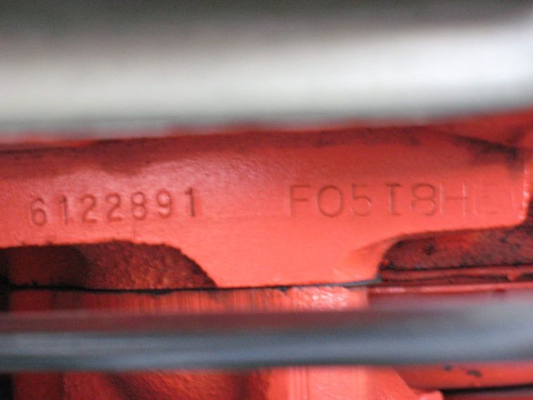

Passenger side...right below the cylinder head. You will need the ID that starts with a letter.
like the example starts with an F.
Hopefully it hasn't been ground off.

64f1002017
