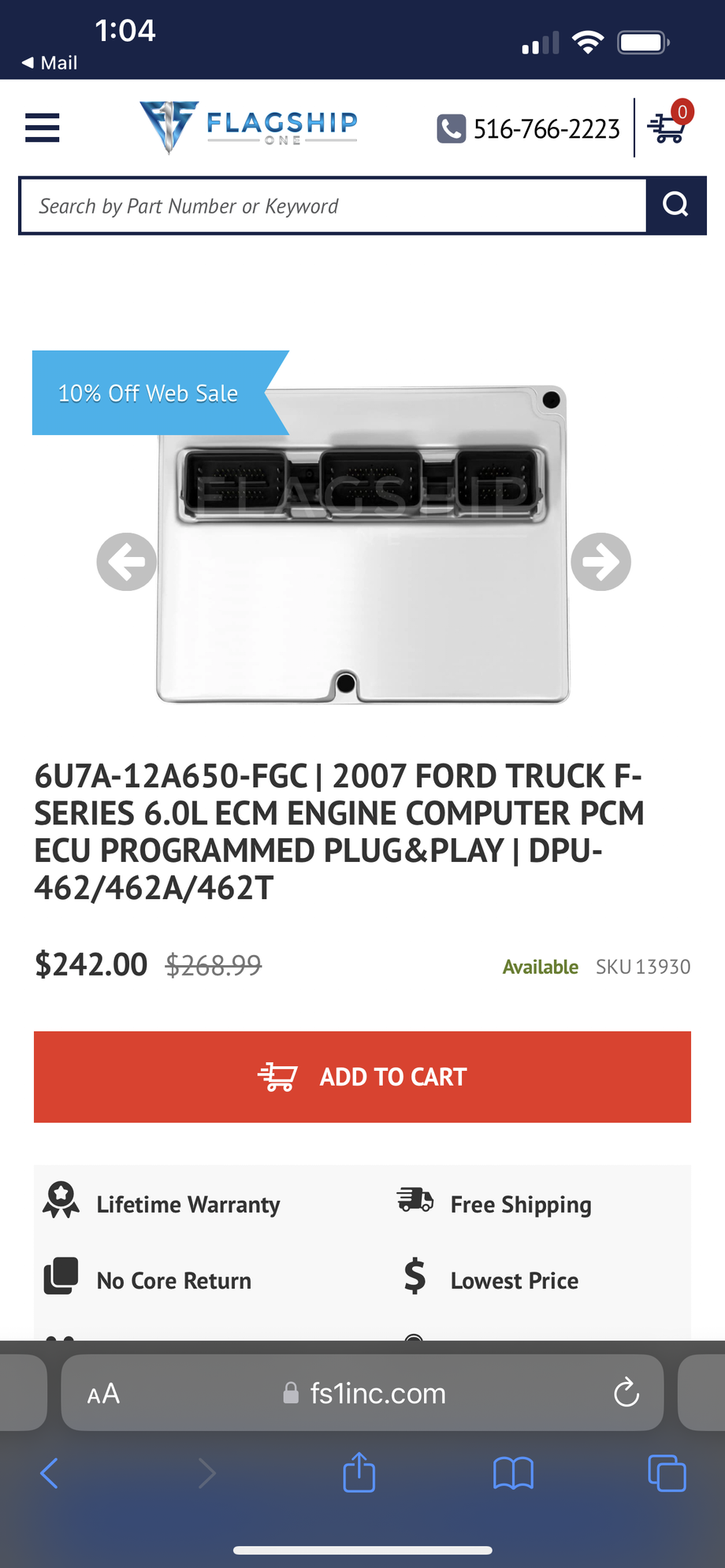

PCM
Will this one work

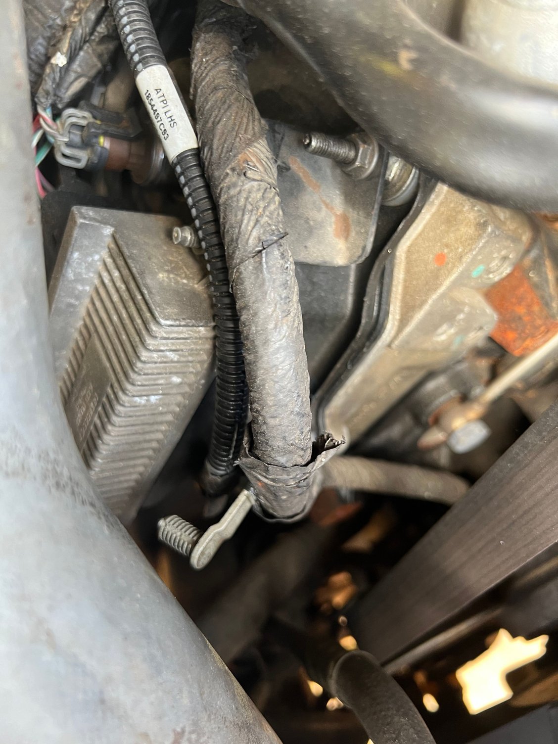

my ICP sensor is located on the passenger side

Ok I found this one do y’all think it will work for my truck
https://www.fs1inc.com/oem-engine-co...6-0l-cyh0.html
