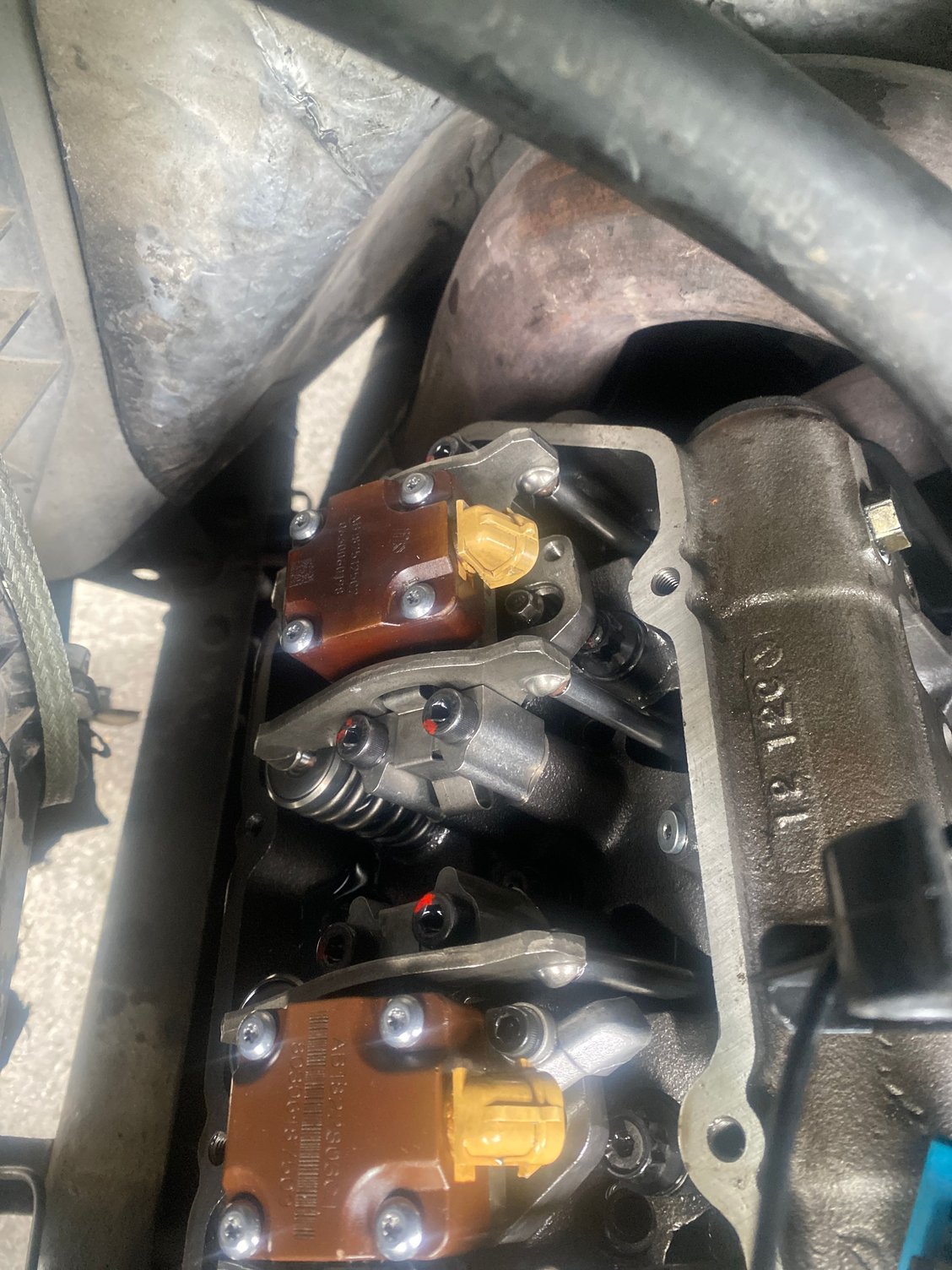

So this morning I started working again and got the glow plugs out, planning to stop by ford and get new ones just in case they aren’t oem, they say germany on them? I got the drivers side injectors in and torqued down with relative ease, waiting to torque the oil deflectors as I don’t have the size needed on a socket.
im stuck on what I believe is #7, back injector on the passenger side. I got it in but the hold down collar is not allowing the hold down bolt that you don’t touch to slide into its place… really scratching my head here.

Big update. It wasn’t the morning/afternoon I was hoping for. I got all of the new glow plugs installed, under valve cover harness hooked back up to everything, put the valve covers back on and started dealing with dead batteries. After getting a charger from hobofreight and a neighbor helping with his CTD with jumpers and we eventually got it to start up. Compression cranking sounded good and even. Upon start I got the expected cloud of white smoke and the engine STILL shakes and sounds like it’s knocking on the passenger side still.
I let it idle a while while inspecting everything. Not sure yet, but found a substantial new oil leak that appeared the be below the turbo but I’m wondering if that was just the remaining oil that went through the system because shortly after noticing that new dripping puddle below my transmission, my neighbor yelled to turn off the truck while he was smelling the exhaust smoke. There was a puddle of oil and it was dripping out of the tailpipe. All that being said, I’m hoping with everything I’ve got that all the new oil leaks/oil in exhaust are from oil going through the turbo and then exhaust.
i shot the exhaust manifolds with my laser gun and there’s almost a 100 degree difference between the drivers and passenger side bank, with the passenger side being cooler. When I shot the temps the drivers side was ~240 and the passenger side ~140 with the rear most being around 160. I have not driven it yet and would need to install the air intake and inter cooler pipes and also this has beat me down and not provided much confidence.
I ran a cylinder contribution test while it was still running and it failed #3

Most of everything you're describing is pretty normal, except the exhaust temps and possibly the knock. It's likely to run rough for at least the first 50 miles up to 100 before the air has managed to work itself out of the hpo system.
When you have a chance grab a recording of the knock and load it here or youtube or whatever works. We might get an idea of it's source and if it's serious. If you are concerned there might be bigger issues going on you might want to hold off on the valve covers and do a compression test. Oh and you might have a look at the pushrods and rockers on the side that's knocking.

I have to shorten and split up the clip to post
still sounds like a knocking happening on the passenger side.
