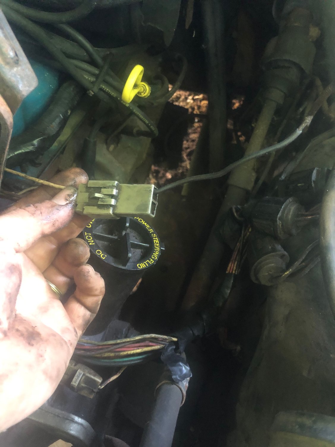

Under hood wire
So I have a wire under my hood of my 86 efi 150 an I’m trying to figure what it powers due to it having 12v with key on 12v . This wire has a white wire on one side of this molex connector and the othe side of the connector is black the wire wire is coming from the harness the is near the power steering pump. Thanks for any help not to go off topic but idk if this wire controls the rear in tank fuel pump? The truck will only get 20 psi of fuel at the rail and will not rev that great, this issue is the last major issue I have before I can drive it

First off, have you checked for a dirty fuel filter ?
I'll look and see if I have a picture of that wire you're asking about.

I went out and took a photo.

I would think almost any auto parts store can get you a condenser.

The condenser is just to keep noise out of your radio. That's it.

Thanks so much for that pic, saved me a bunch of time. And yes the hp pump does prime when you turn the key idk about the filter but that was my next step. Will I need those removal tools to change the filter? Thanks again!

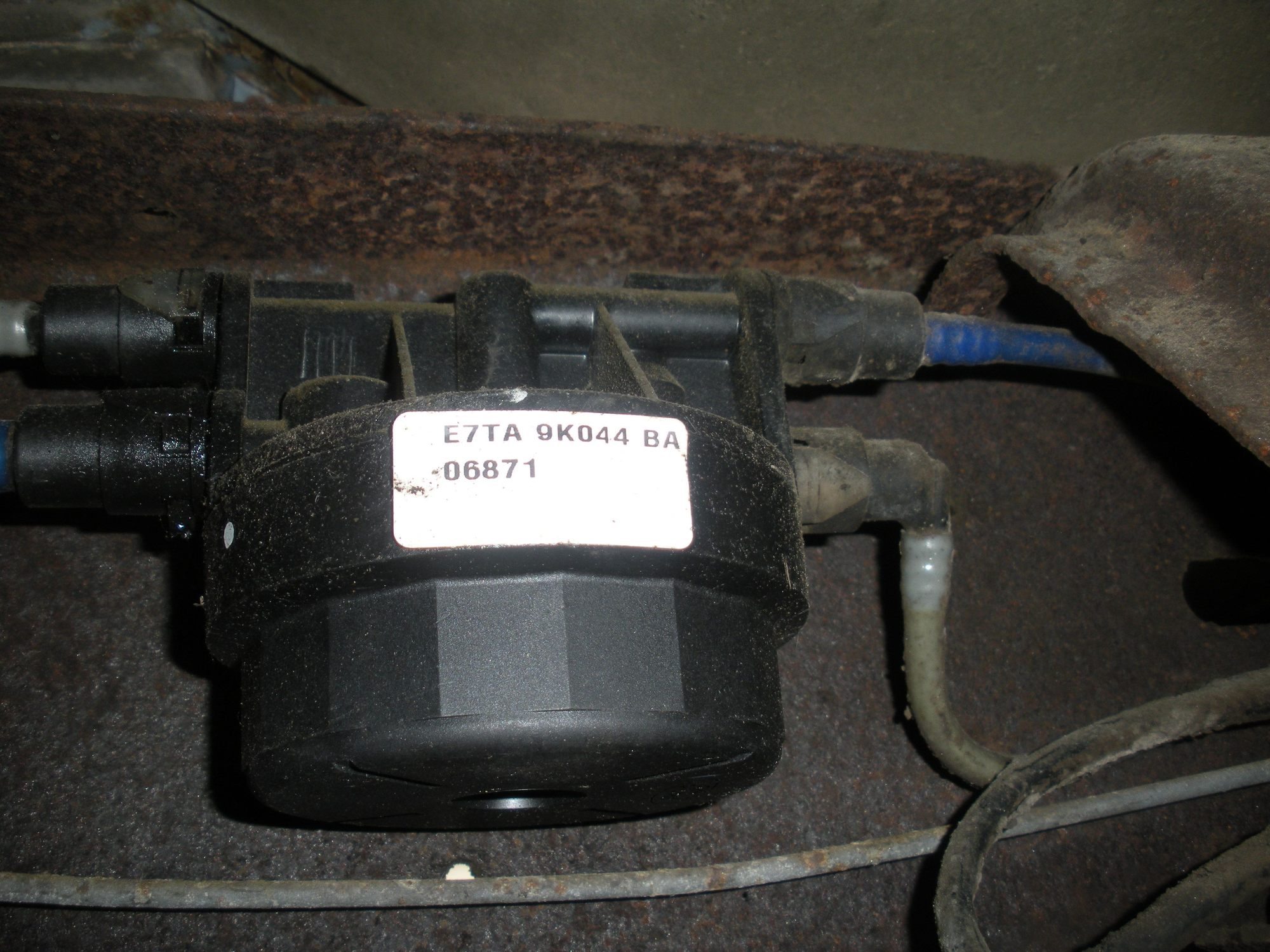

Your 86' 302 EFI will have one of these under the cab, seems they are hard to come by these day's. Be careful with it, don't break it.

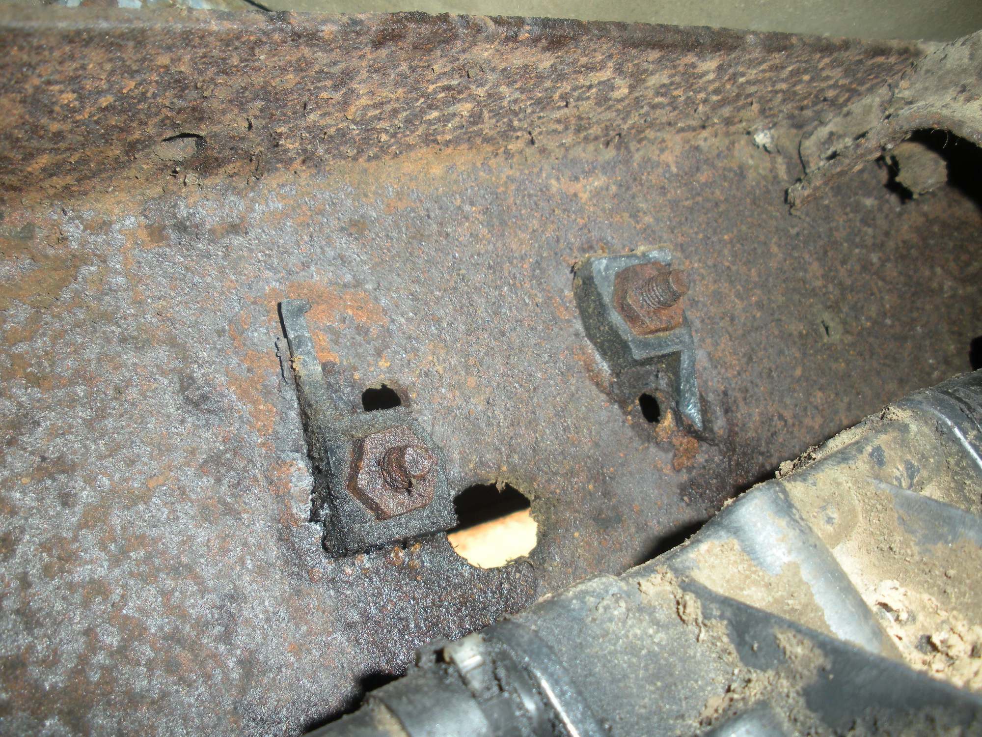

Here's my old one, broken tabs.
