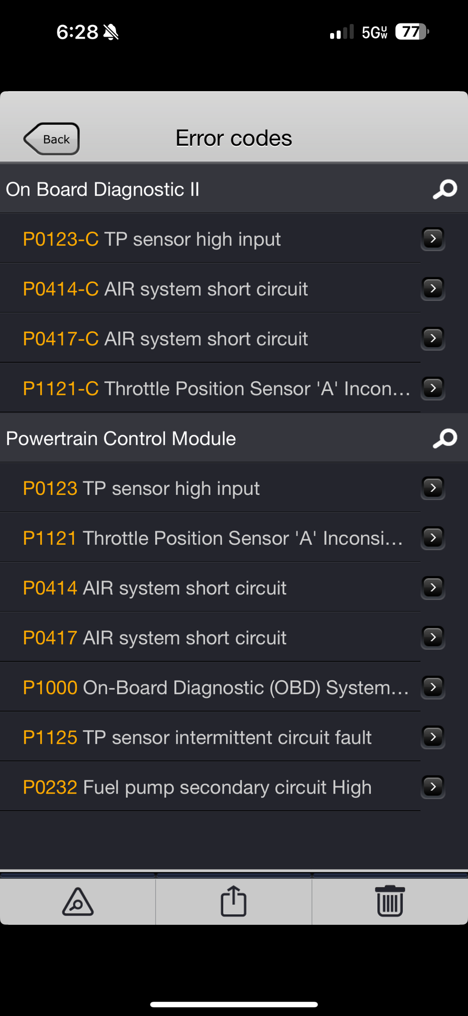

Old Jun 7, 2024 | 07:52 PM
jp1996's Avatar
jp1996
5th Gear
Joined: Jun 2024
Posts: 5
These are the codes it is throwing
Old Jun 7, 2024 | 09:33 PM
Mark Kovalsky's Avatar
Mark Kovalsky
Frmr Ford Trans Engr
Joined: Aug 1999
Posts: 24,728
Likes: 2,657
From: SE Florida
All of those TP sensor codes are a concern. Find and fix that problem before going any further.
