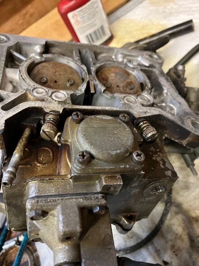

I recently had a little trouble with my truck running excessively rich all of a sudden. I found the power valve had come loose on the 2150 (2bbl) carb. The power valve is located on the bottom of the carb, between the idle mixture screws, inside the cover shown in the middle of this picture:

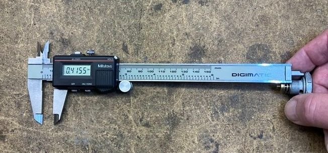

Here's the removed power valve, showing the shorter .4155" dimension:

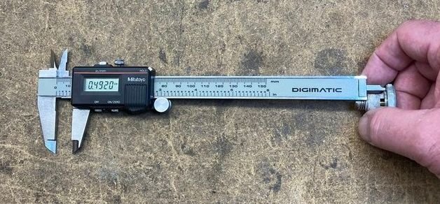

Here's the longer version, at .4920":
The difference is only .076", but it made all the difference. Sorry, I don't have records for which manufacturer made which version. But if you have to replace one, measure it first to avoid the short version. Avoid a thick gasket, too, for maximum thread engagement.
