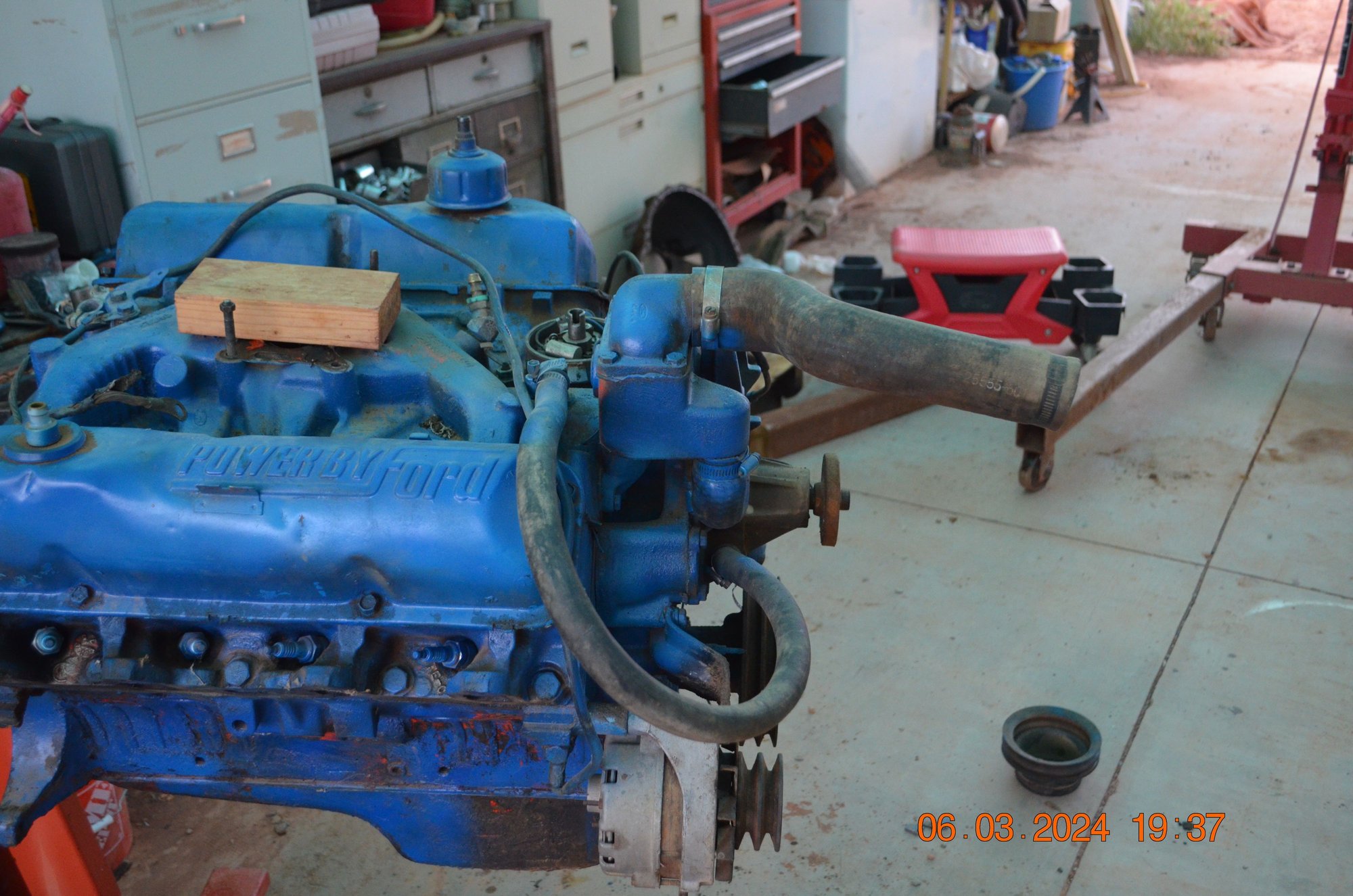

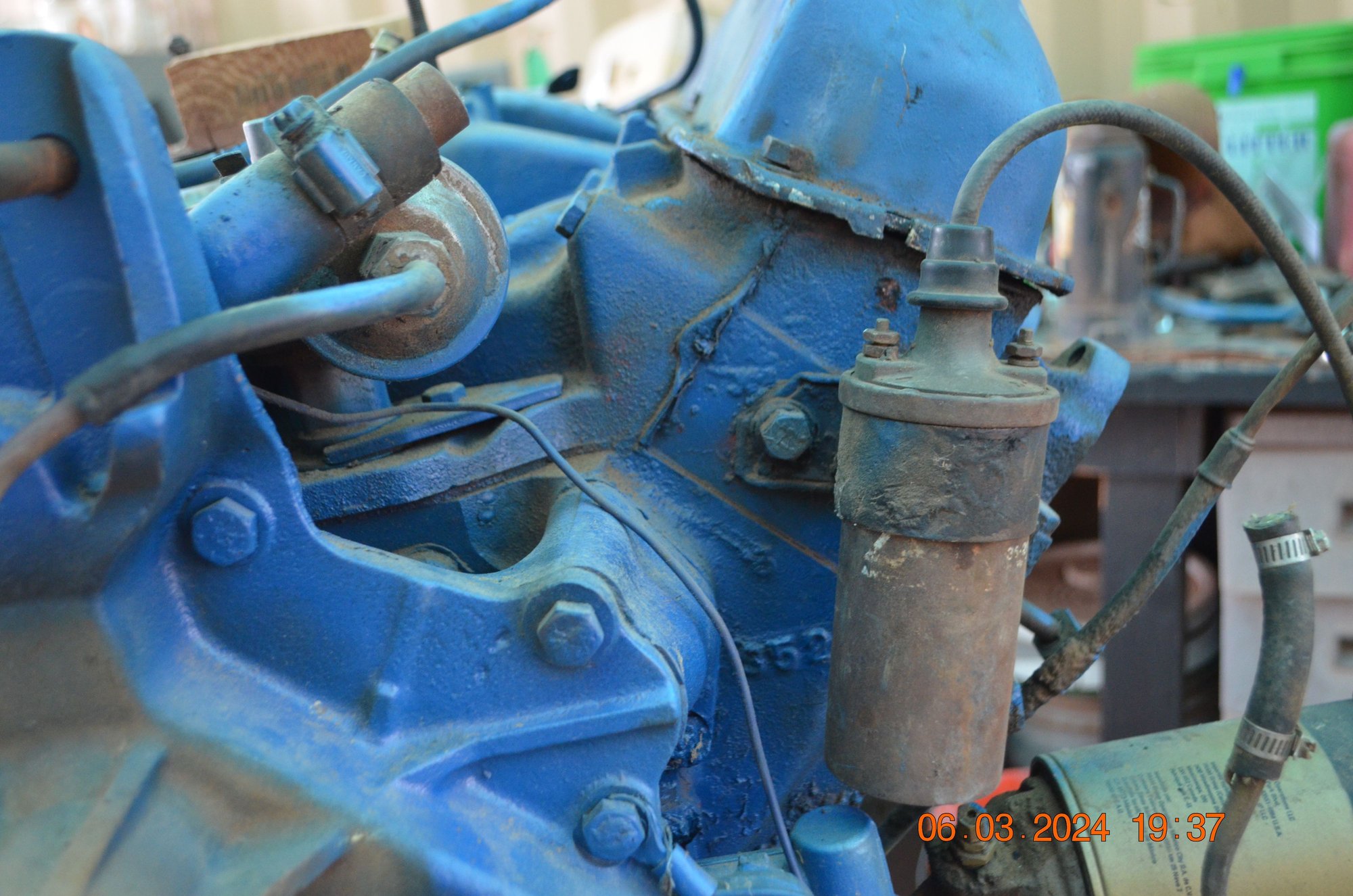

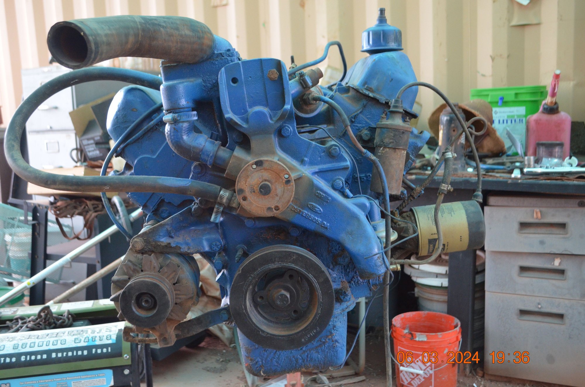

OKay so here are a few pics. IF I can get them to load. but I have an ft motor in the form of a 370 in my 79'f-600 and the valve cover sits solely on the head as with the 360 in my '70 f-100 the intake holds some of that valve cover. this new/old motor has the
valve cover sits partly on intake
valve cover does partly sit on the intake

If the valve cover sits solely on the head, it's not a FE or FT engine. Looking at the oil pan in the pics, I'd be concerned about the rust under the paint. Or maybe it's just paint over crud.

The 370 is of the 429/460 engine family. Totally different engine. I think what you have there in the pics is an FT engine, 361/391. The water pump and water neck/thermostat apparatus is definitely big truck FT stuff. The bigger balancer suggest FT, as well. All of the part numbers you rattled off earlier with T in the third place says they were specific Truck parts, and 360/390's were known to have used interchangeable car parts for heads and intakes, timing covers, etc., and many would have had an A or O there.

Yes, an FT with the high mount fan.
The crank diameter is either 1 3/8" for the 330 MD, or 1 3/4" for all other FT engines. The measurement above is off the damper or pulley somehow.
Also evident is the heat crossover runner to the side of the carb. The FT is done that way, with an additional port in the center of the head. The exhaust manifold will usually have two additional bolts in the center. (But not always--seems like later ones didn't have the bolts)
Recheck the stroke. 330 & 361 were 3.5"; 389-391 were 3.78"

I'm guessing that what you have in the picture is an FT. Might be a 361 or 391. The FT's also have sodium cooled exhaust valves. So. if you take off the valve cover, the exhaust valve stem will be bigger in diameter than the intake.

Definitely in the FT/FE family. The FT is not desirable for a pick up truck. Lower rpm and very small valves in the heads. Also I noticed ribs on the block, which is usually an indication of a high nickel content block.
