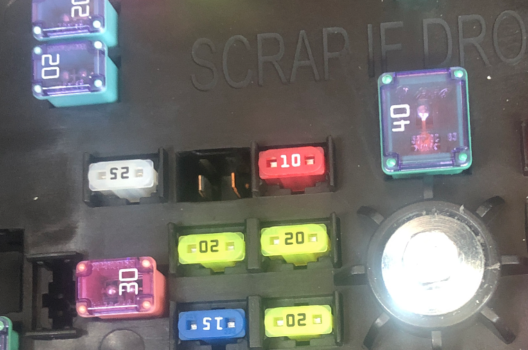

Pull fuse #40, pink 30 amp, and starter solenoid circuit is with out power. Cant start and engine obviously wont turn over. Better still, insert a known blown fuse in its place to cover your tracks.
Always the chance some dude is scoping you out as you park vehicle, sitting behind tinted glass waiting, and sees you raise the hood......this stuff happens!
Its the empty slot with two pins visible in picture. Fuse box in engine bay near battery, and is actually easy to access.
Vehicle is 2022 f350 xlt 4x4. 7.3
