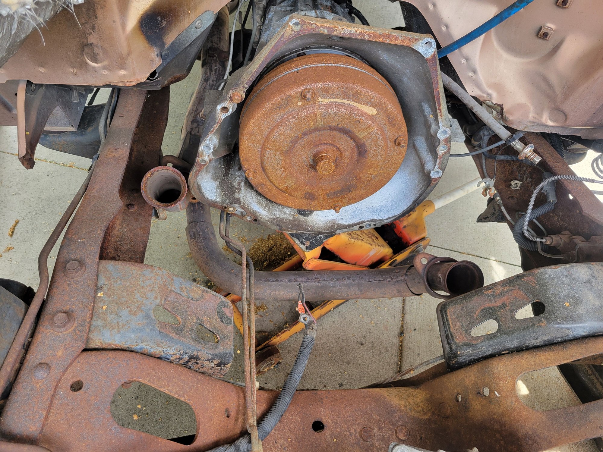

Thought they had dual head pipes into some square flange and a single pipe out?
Do you need just the CARB number on the catalyst? A stocker will be expensive.
Old May 26, 2024 | 01:19 PM
cougrrcj's Avatar
cougrrcj
Joined: Jul 2009
Posts: 1,020
Likes: 409
From: NE Ohio
Pic 1

Silver pipe on the left edge is the start of the catalyst . Mine was stolen as well, and the new one welded in place
