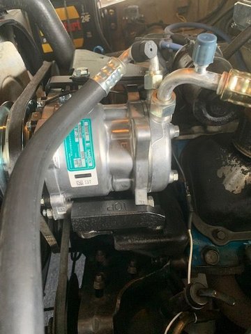

Custom Auto Air is now installed. Man does it work great. This morning it was 82 degrees outside and my air was blowing 36 degrees! I am very pleased with how it works as well as how it looks under the hood.

Any underhood pics of how the compressor looks and mounts? I’d like to do the install in the future seeing as how this is going to be a Georgia truck but my restoration budget is currently exhausted.

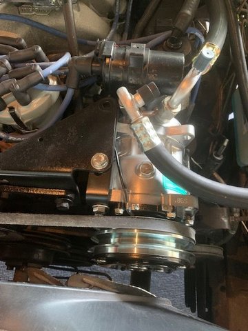

More pictures under the hood.

Nice install! Looks very clean. Thanks for the pics.

I chose Custom Auto Air because of the way they routed the hoses. Vintage runs them through the fender and in the fresh air location on the factory air trucks. That seemed like way too much effort and not needed in my opinion.
