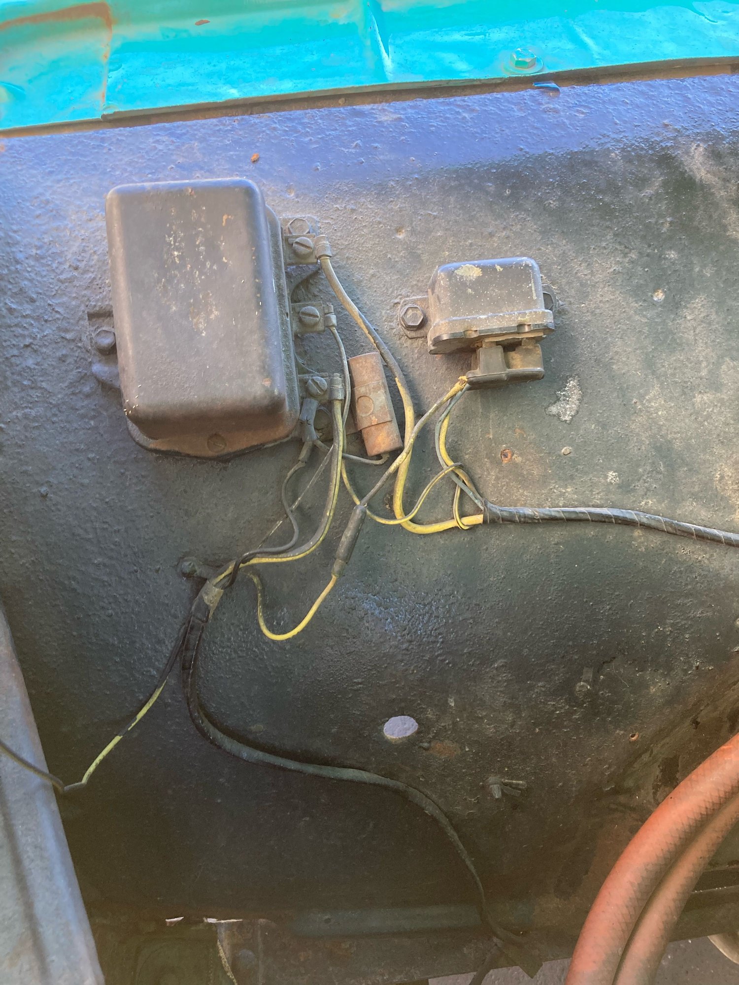

Electric
My 59 has had some issues starting (just a click) then trying it again it will turn over
ive replaced the solenoid? Between the battery and starter but am curious if this part (which I cannot identify) is part of the problem thanks in advance
Trying to identify

Box on left
That is voltage regulator for a vehicle with a generator

Small one on right
Horn relay switch
