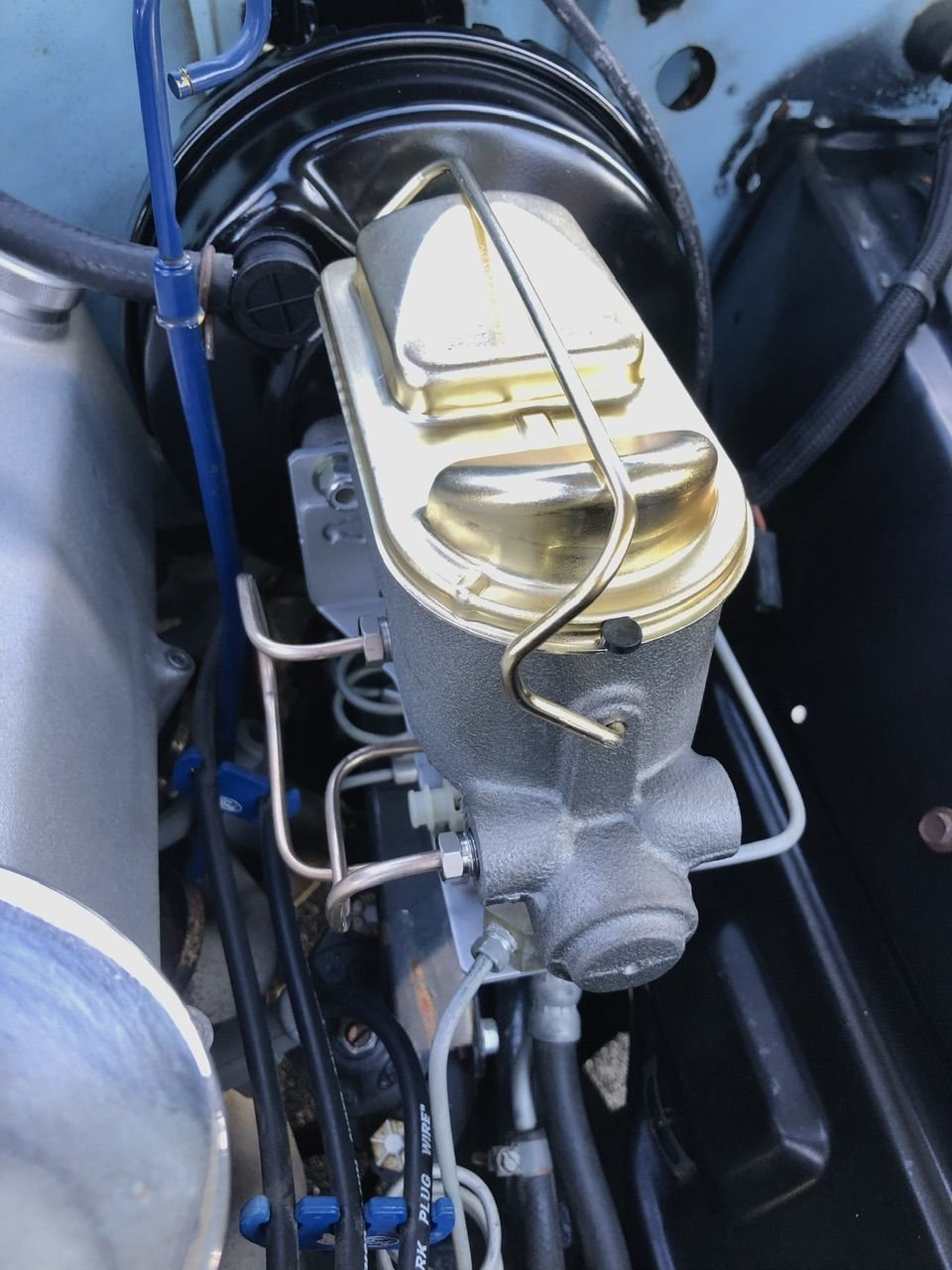

I disagree. The initial pump of the brake pedal is done with one (the farthest) bleeder open, to start the gravity bleed.
I’ve been a mechanic all my life. Ford, GM and Chrysler trained. I’ve done disc upgrades, hardline, etc. on many many makes/models. Complete systems with dry lines, wheel cylinders and calipers.
The final bleed always yields zero air in the system, solid pedal.
Solid pedal on both of my own trucks. This is my 72 disc/drum setup.
