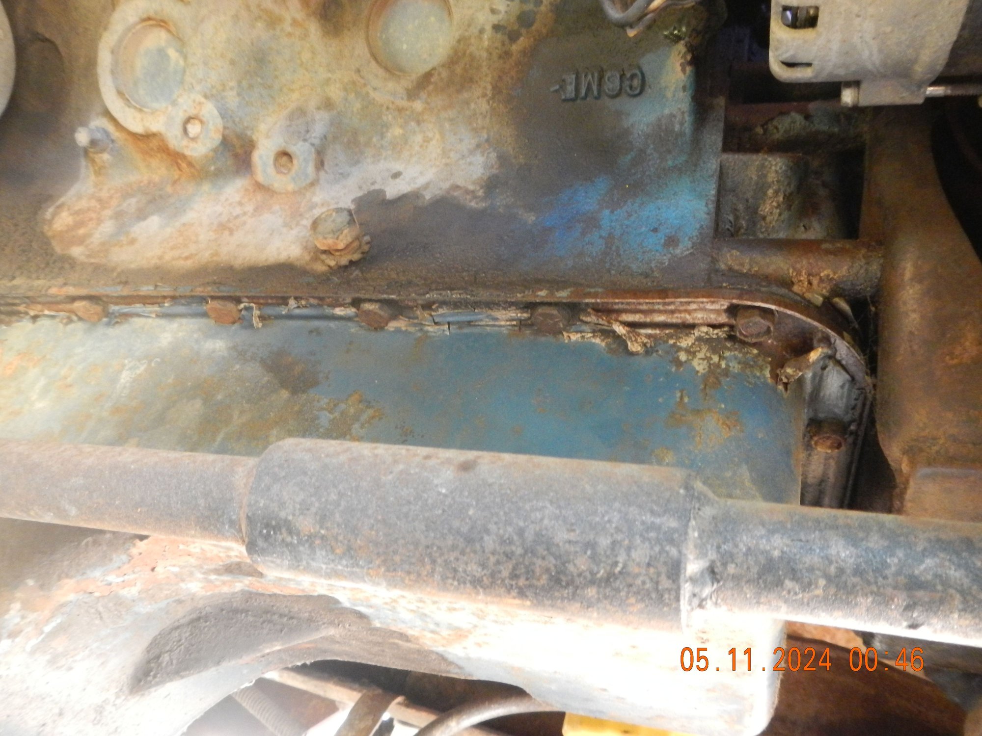

1) passenger side front bottom of block - C6ME- (there was the Dash, but nothing after it)

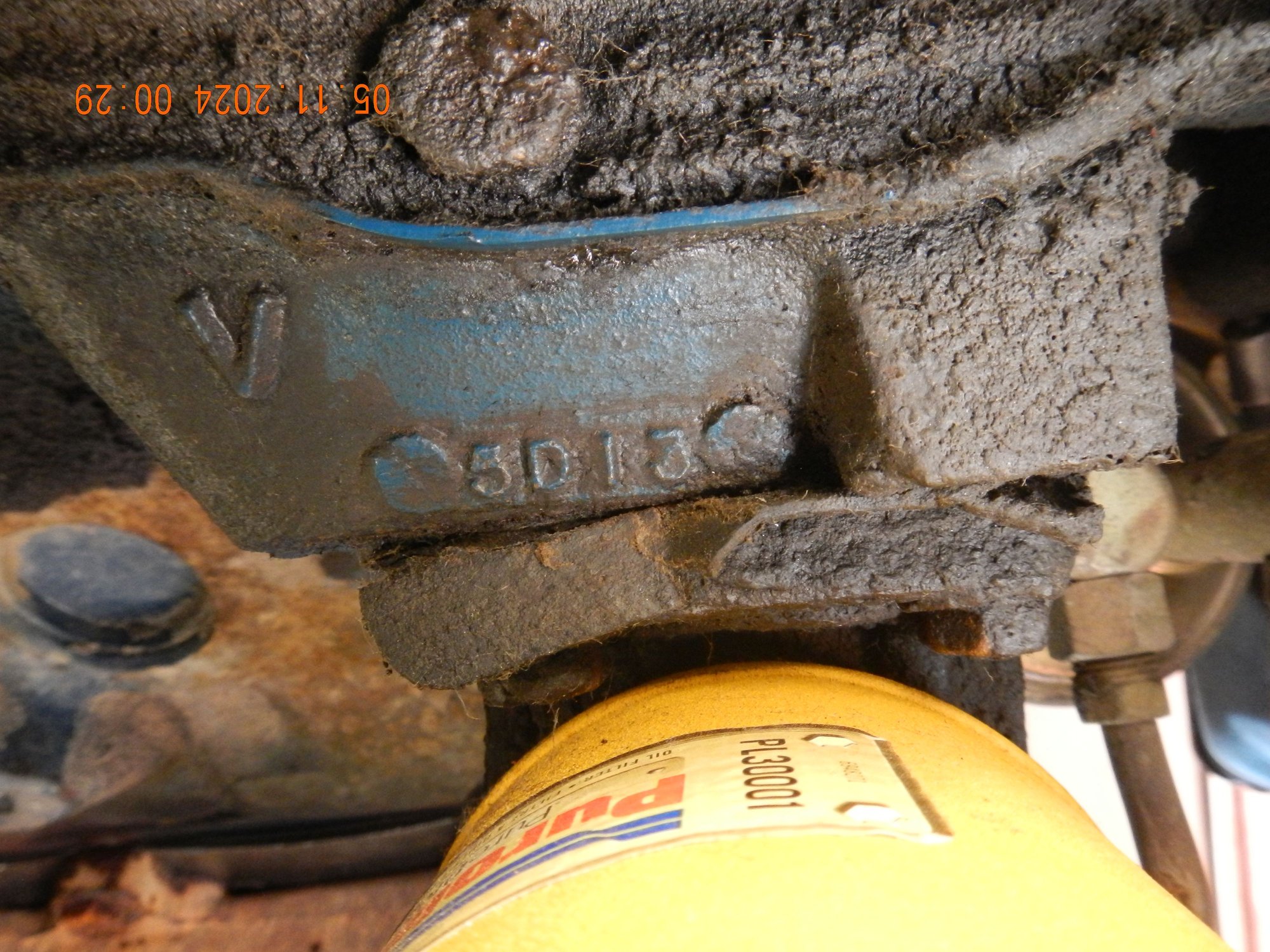

2) next to engine oil filter , bottom side - 5D13

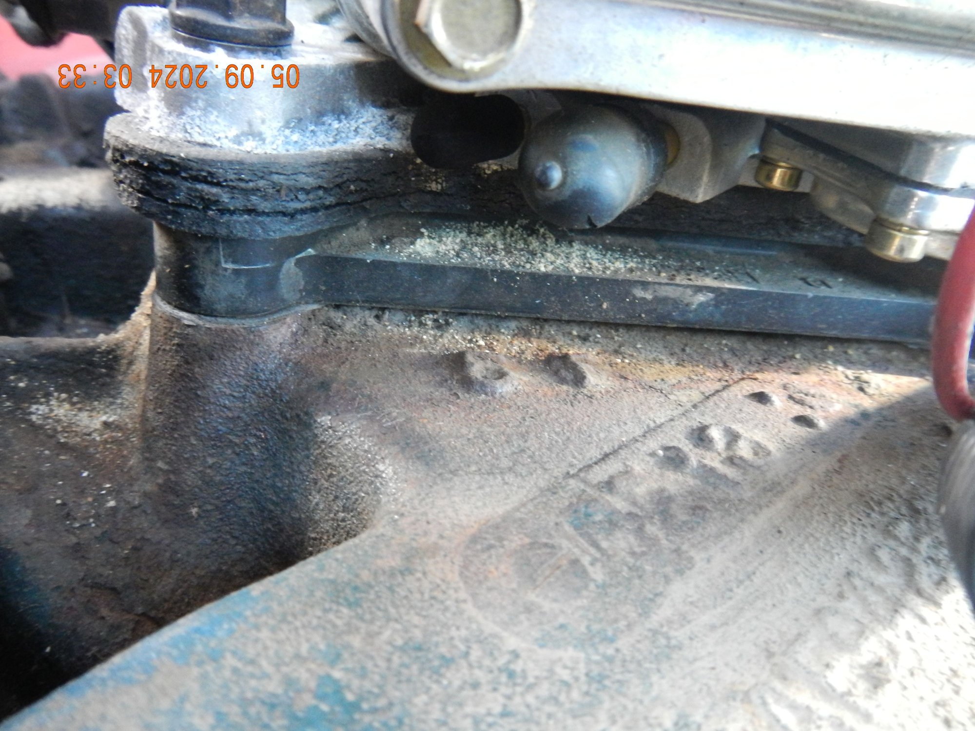

3) drive side front area of block - 19 DIF

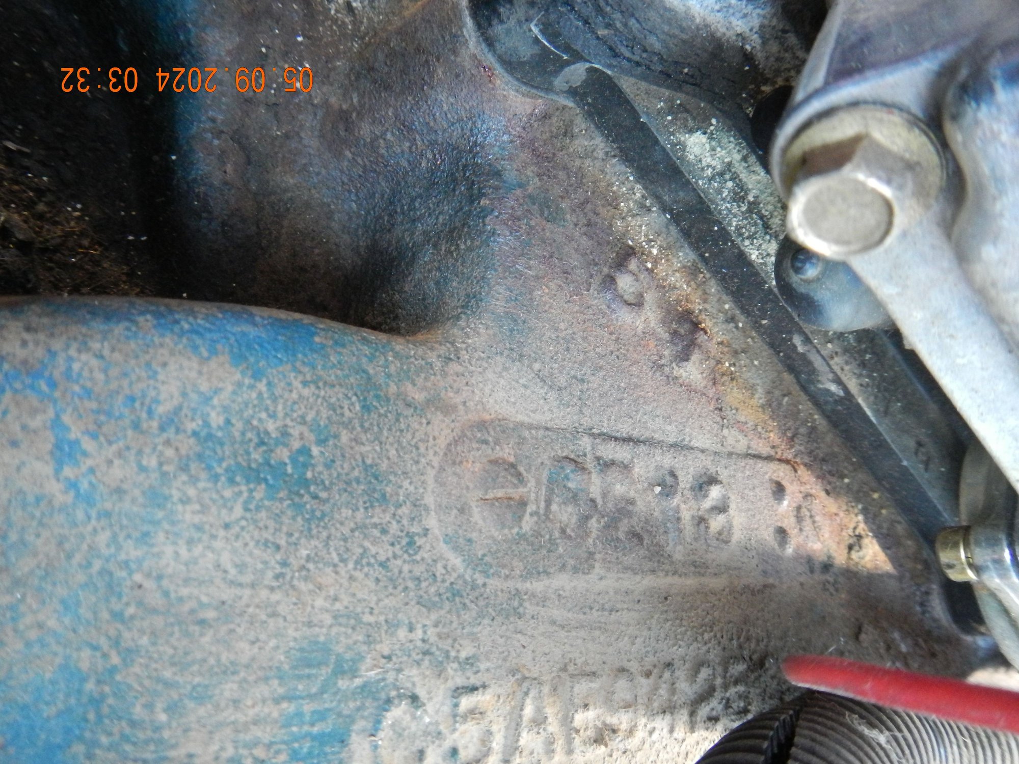

4) intake manifold - 05AE9425

C6ME = 1966 revision, Mercury line. This shows up on a lot of blocks starting in '66. Even though it's "Mercury", it didn't necessarily go into a Mercury. This lists the wide variety of blocks bearing a "C6ME" casting number:

5D13
5 = 1965
D = 4th month, April
13 = 13th day
4/13/65, the date of casting.
Since Ford let the blocks sit for several months after casting, this would be right for model year 1966.

19 DIF = Dearborn Iron Foundry, 19 probably has a meaning but I don't know it.
C5AE9425 = again, 1965 revision, Ford engineering group. 9425 is the basic part number for an intake manifold. This revision could have been used for several model years. There could be more numbers after the 9425. Those numbers might shed a little more light on it.

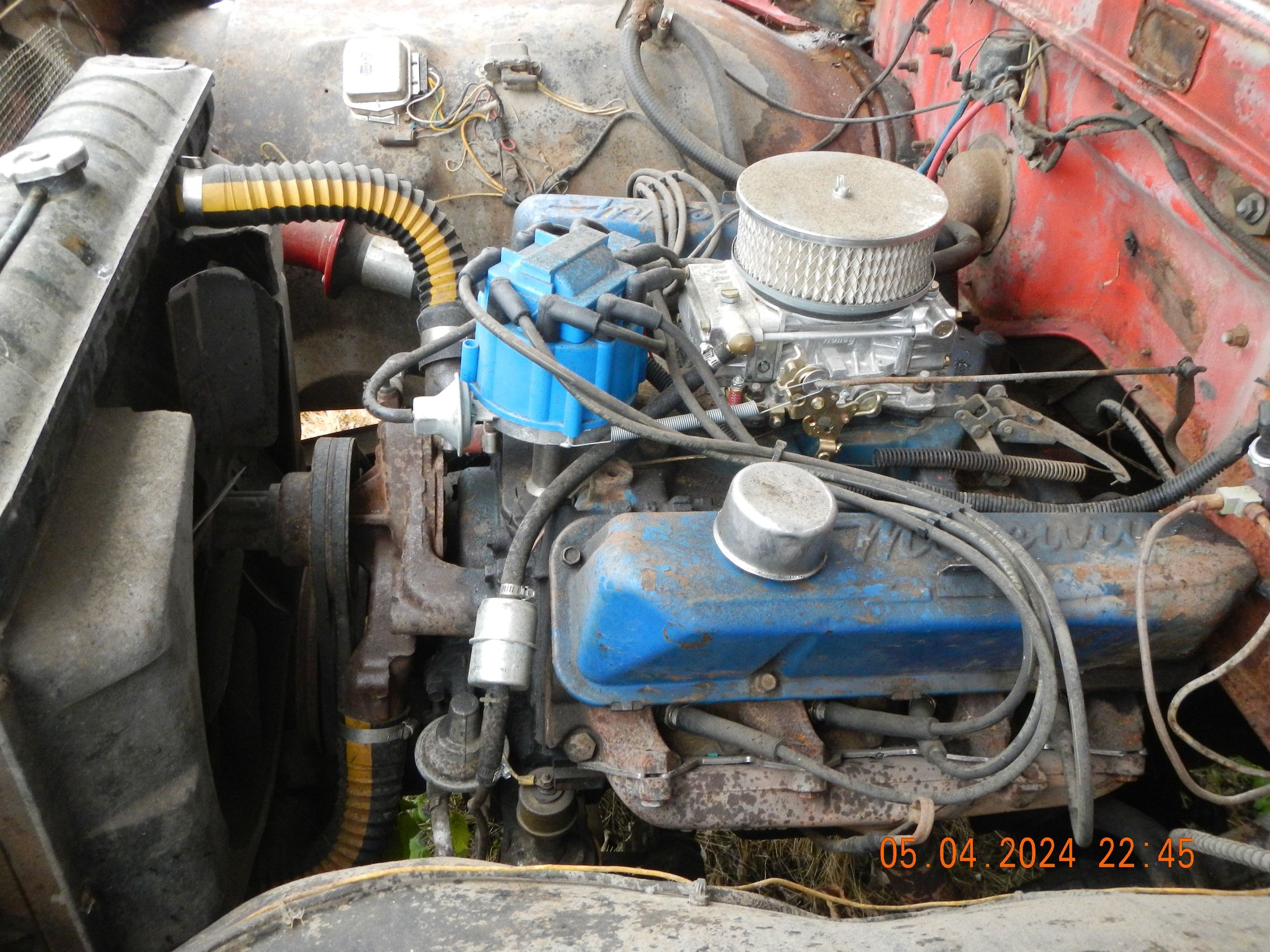

It appears to be the original Ford blue started for the '66 model year. A '65 block would be factory black.
Mercury valve covers..... Opens up the 410 possibility.

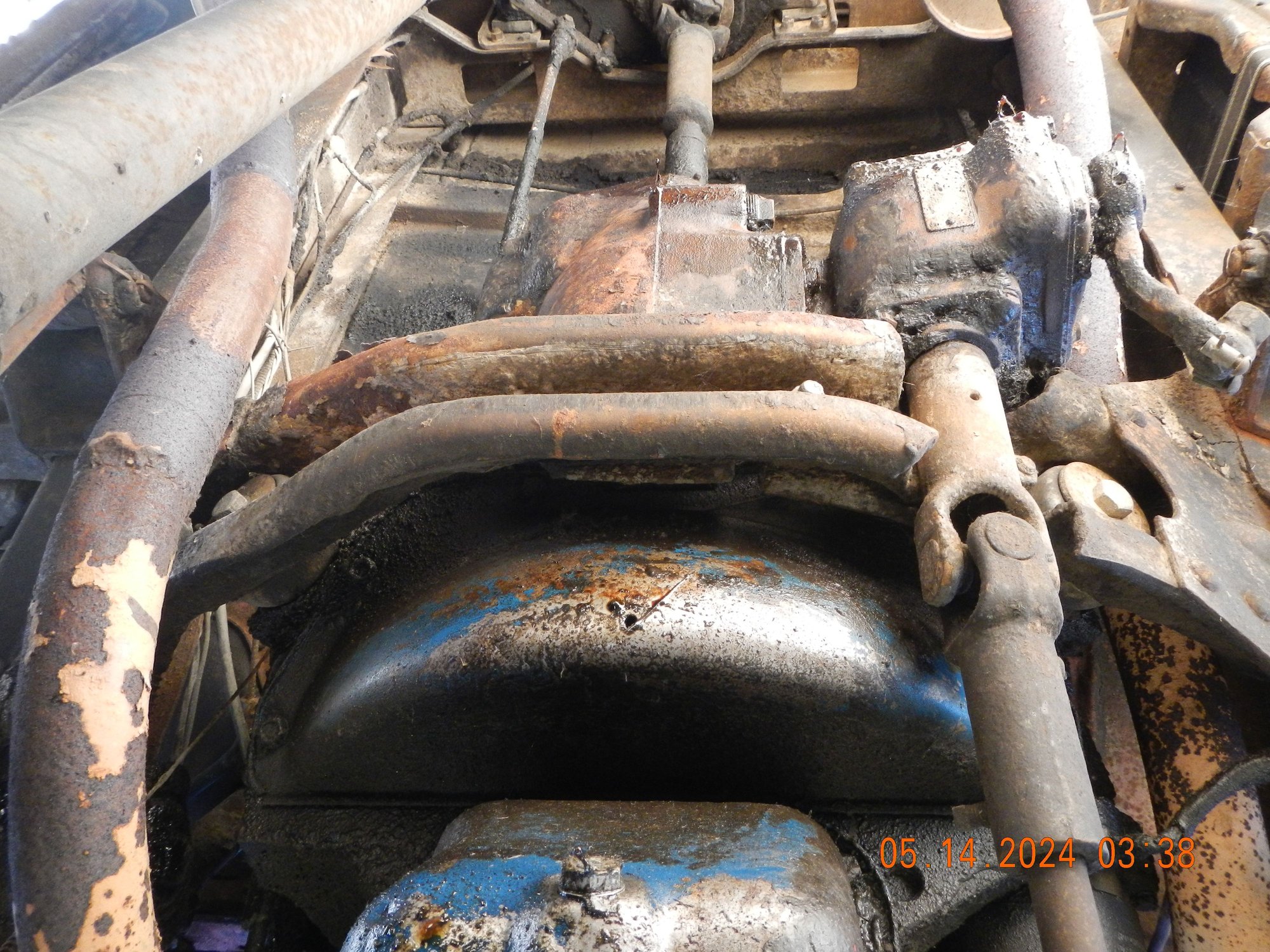

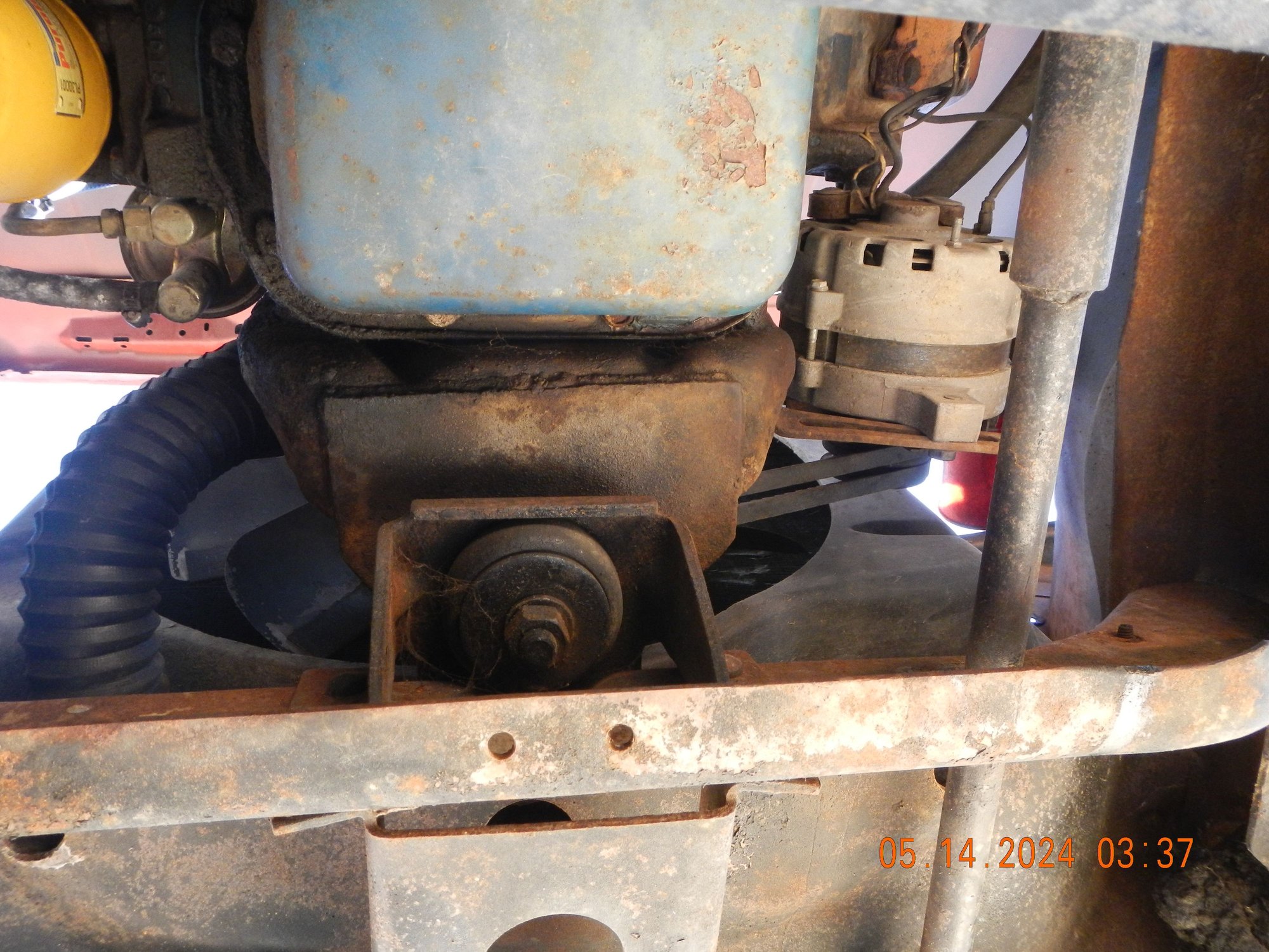

I took a few pictures of the engine mounts - 1 engine mount is at the front of the engine and one on each side at the very rear of the engine.

that just means you have front and rear mounts instead of side mounts. the only way to know for sure what engine you have is to measure the stroke.

What sticks out most to me is what appears to be an original cast 4V intake manifold. That intake, C5AE-9425-C (1965-66) was only used on two engines, the 352 and 390. If it is a 1965 Mercury, then it indeed came out of a police car. Both engines were available in PCs.
All 1965 T-birds with that intake were 390s, but would have the Thunderbird valve covers.
That makes it easy to determine by checking the stroke. 3.5 inches for the 352. 3.78 inched for the 390.

Intake Manifold: C5AE 9425-3 , and there is the number 6E13 just above that number.
Oil Filter Deck: 5D13 = April 13, 1965

As mentioned in your other post, the C5AE-9425-C intake only gives you two engine possibilities...352 or 390. You'll need to pull a spark plug and measure the stroke with a piece of dowel.
3.5 inches is a 352
3.78 inches is a 390

The previous owner gave me the original air intake cleaner housing and distributor - the air intake cleaner housing has a Chrome top cover with the Blue base that sits on the carburetor.
I will not be removing the engine oil pan any time soon so I wont have the crank id number for a while.
I am thinking that this engine was built in spring of 1965 but was installed into a 1966 police car which would be why the engine is painted Blue, which I believe would make this a 1966 428 Interceptor Engine. The intake manifold was supposed to be Aluminum on the 428 in 1966, I'll have to try to find out if this one is aluminum or not. It also said that the 1966 428 had Solid Lifters and after that they went to hydraulic lifters for 1967.

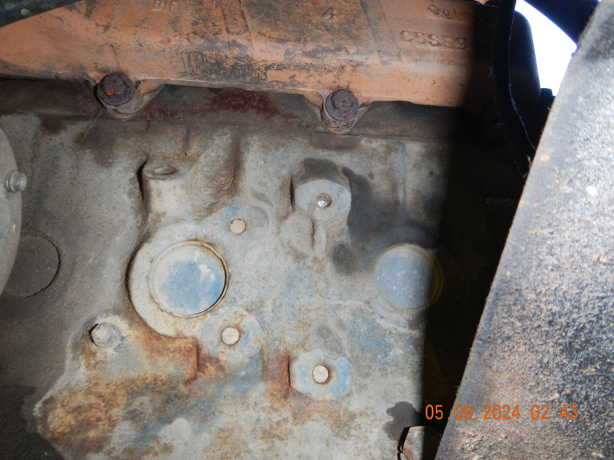

I also attached a picture of the side of this block that shows the 4 motor mount bolt holes on my engines block vs 2 motor mount bolt holes on the other engines that is in the video.
