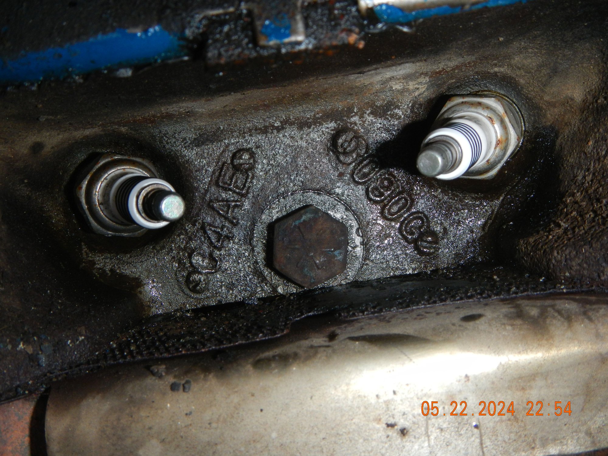

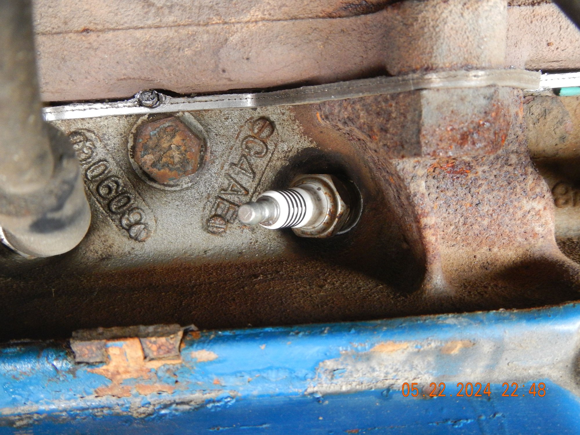

This was what I did today - I was able to get the numbers between the center spark plugs on each head ( see attached)
I see from this cylinder heads casting chart that I still dont know which engine it is... lol
C4AE – 1964, 427, FE medium-block. 2.19/1.73 valves, 73cc chambers
C4AE – 1964-1965, 289, Windsor small-block, 1.67/1.45 valves, 49.2cc chambers
C4AE – 1964-1974, 352/390/428, FE medium-block
C4AE-590 – 1964-1965, 352/390, FE medium-block
C4AE-A – 1964-1965, 352/390, FE medium-block, 202/1.55 valves
C4AE-C – 1964-1965, 289, Windsor small-block, 1.67/1.45 valves, 49.2cc chambers
C4AE-C – 1964-1965, 352/390, FE medium-block
C4AE-D – 1964-1965, 352/390, FE medium-block
C4AE-F – 1964-1965, 427, FE medium-block, 2.19/1.73 valves, 73cc chambers
Old May 24, 2024 | 12:39 AM
85e150's Avatar
85e150
Joined: Apr 2004
Posts: 34,499
Likes: 2,811
C4AE 6090 G.
Good heads, garden variety FE. 352, 390.
https://www.fordfe.com/c4ae-6090-g-h...ry-t24574.html
Did you measure the stroke yet?
Almost any FE head will fit on any FE block and work.

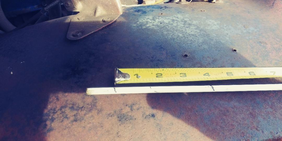

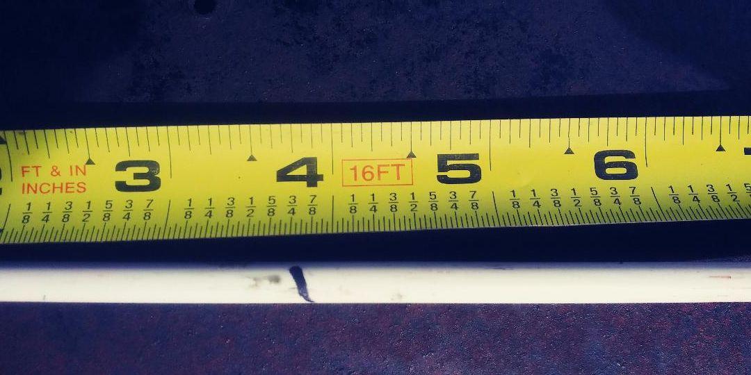

Yes I measured the stroke: pics added, looks to be 3 3/4" to 3 7/8" stroke
this engine has the: Dual Belt Drive Alternator - of the 5 engines put in 1965 police cars, only one engine had the dual alternator belts, that was the 390 PI. (from what I have read online)
