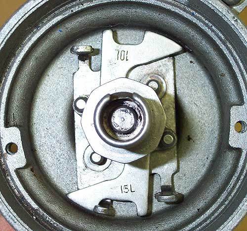

When the carb is in great shape you will find the you don't move too far from the initial 1 1/2 turns outward. Once there I can get my 390-2V to 20" of vacuum at idle by tweaking the distributor. The distributor will give you more leeway so advance it slowly and watch for the peak closely. Once there I dial mine back about 1 degree, with today's gas, and then take a drive on the freeway to listen. To get far more in depth one can pull the distributor and take off the plate to see the advance springs inside and see where they are set. Varies from distributor depending on application. Once you know that then you can see what your total mechanical advance will be when adding what the springs say plus your initial.
As an example and why Ford did this from the factory is beyond me. The 68 Cougar I have was bought from the dealer, by my father, so never tampered with. Ford set mechanical advance at 10L or 20 degrees. Initial was typical Ford of 6 BTDC. giving a total of 26 degrees. The engine should have been around 34-36 total degrees. The car got crappy gas mileage of around 12-13 mpg for a 302-4V. Not till years later did I then know enough to play with a distributor. Since I now had a cam with more duration it made sense to leave it at 10L and move the initial to 15 degrees for a total of 35 now. What a difference! Plus mileage at 17 mpg now. Most likely a 352 has a 13L and 18L plate inside and is set at 13L for 26 degrees mechanical.
