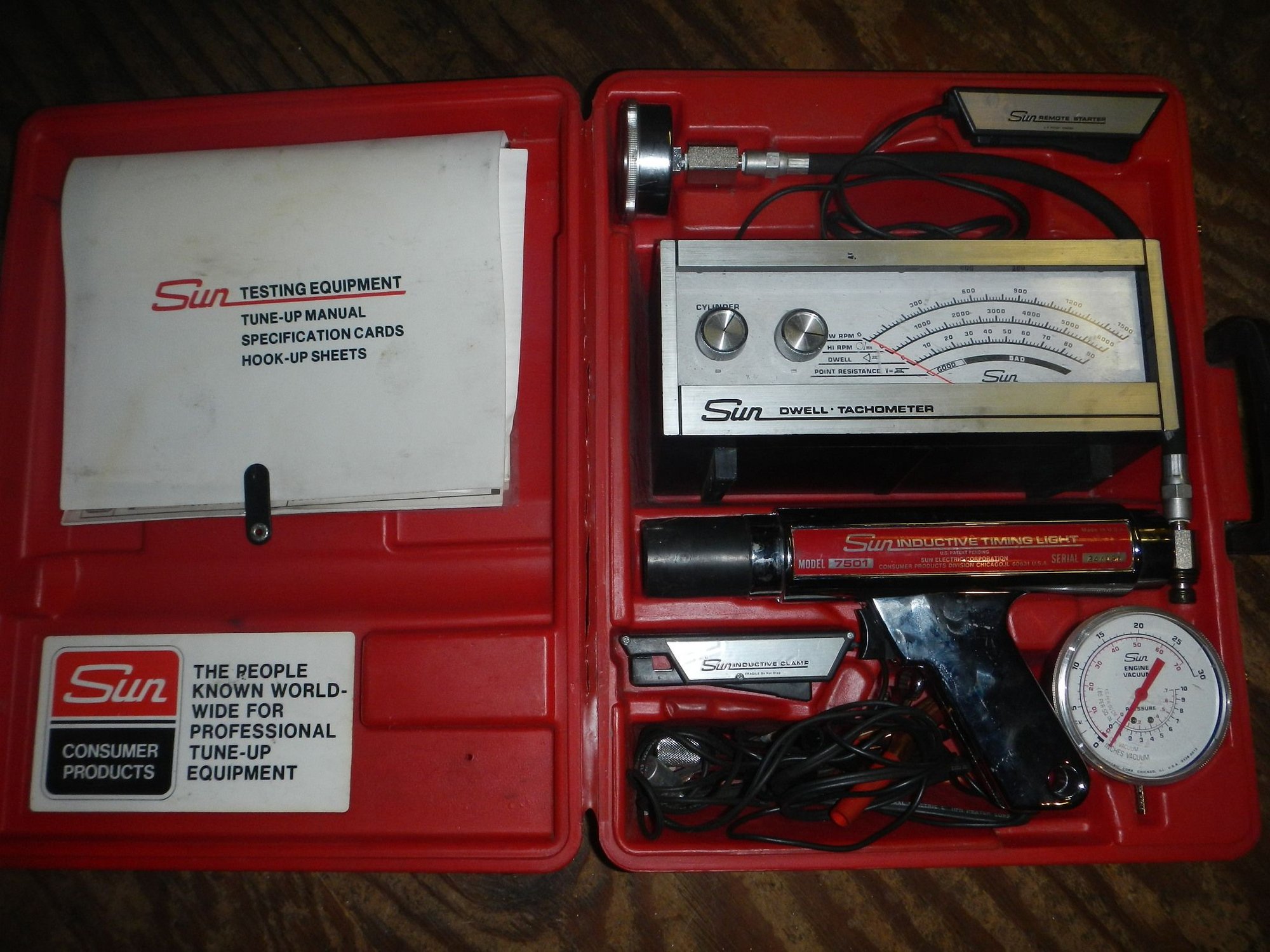

My fingers would fall off tring to explain everything. Hope this helps.
Get one of these it comes with a how to manual. Ebay; https://www.ebay.com/itm/Vintage-SUN...MAAOSwNPZdHnDu
