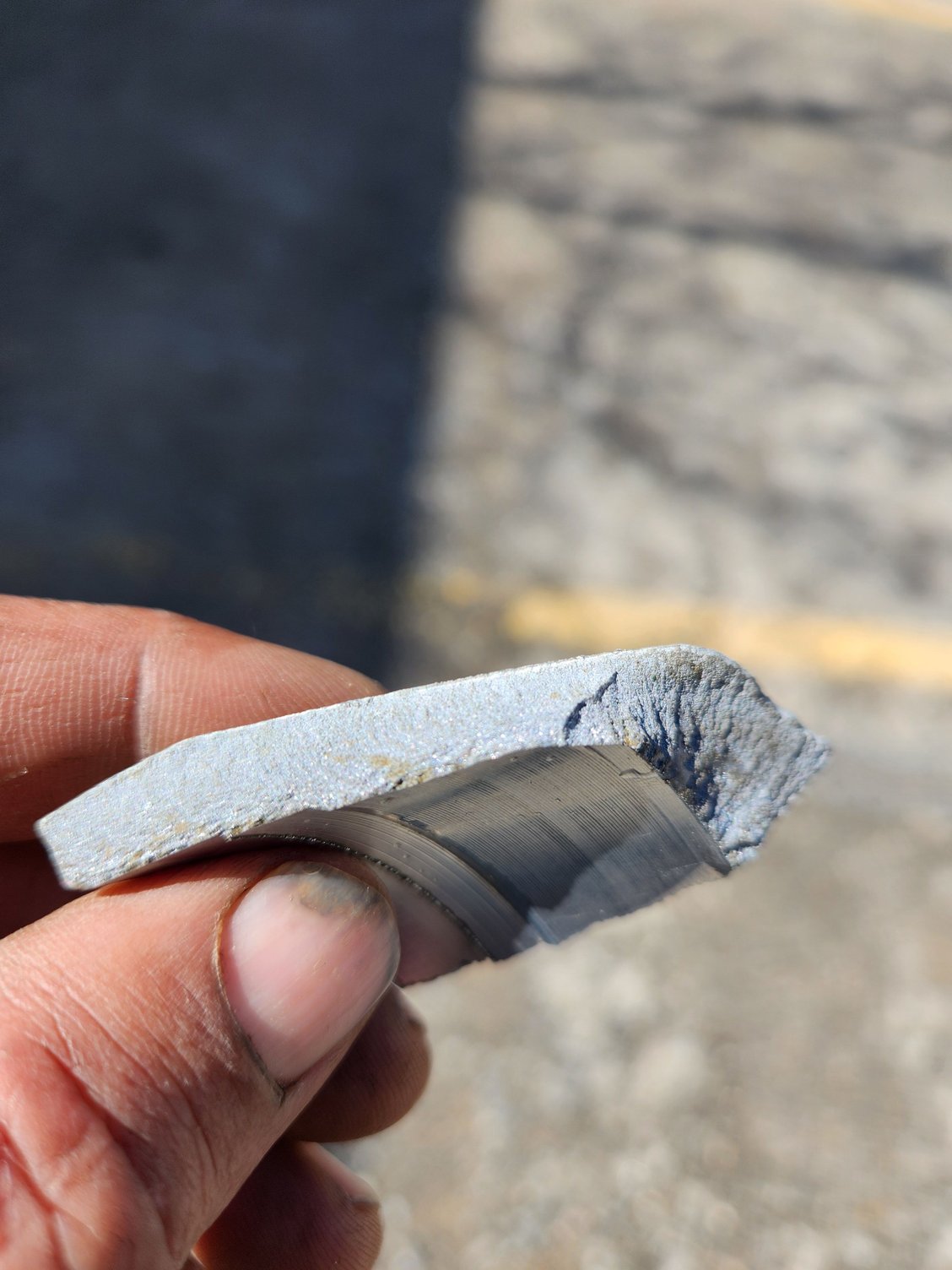

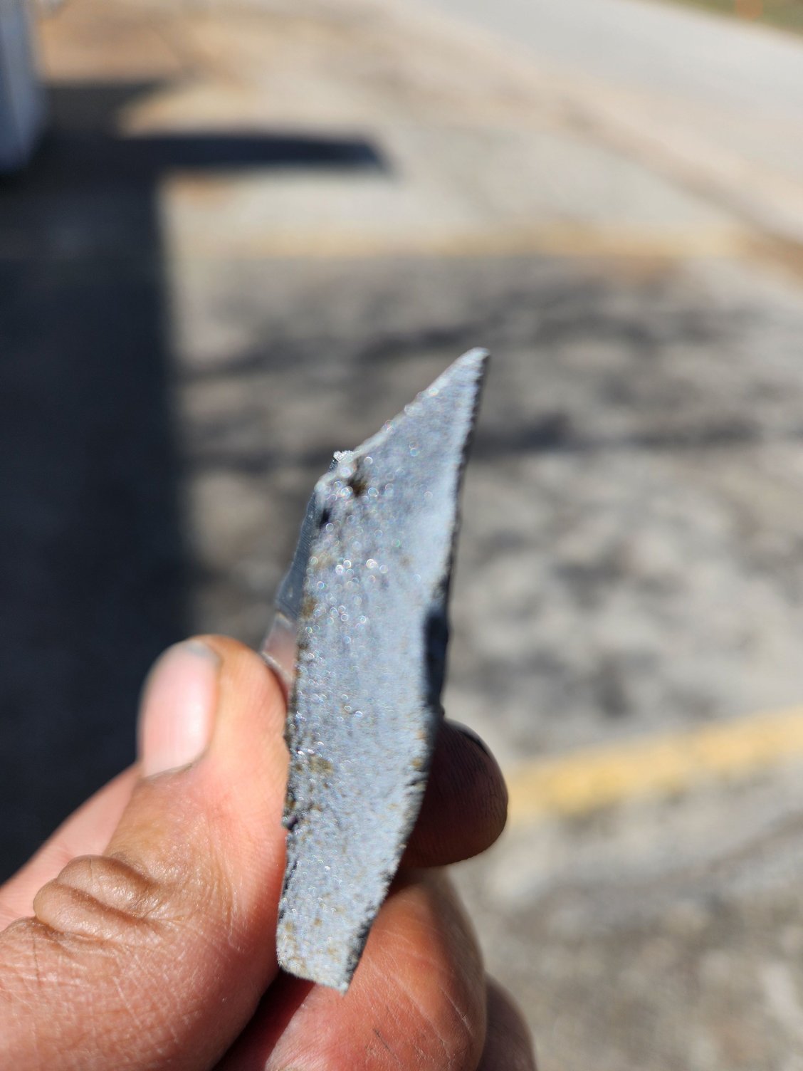

A chunk. I think it's from around the input shaft bearing.
Whatever kind of metal this is, it's not confidence inspiring. As an FT Enthusiast, I fear this is going to become a thing with these trucks.
Especially if you like big heavy ties, and actual moderate off roading.
