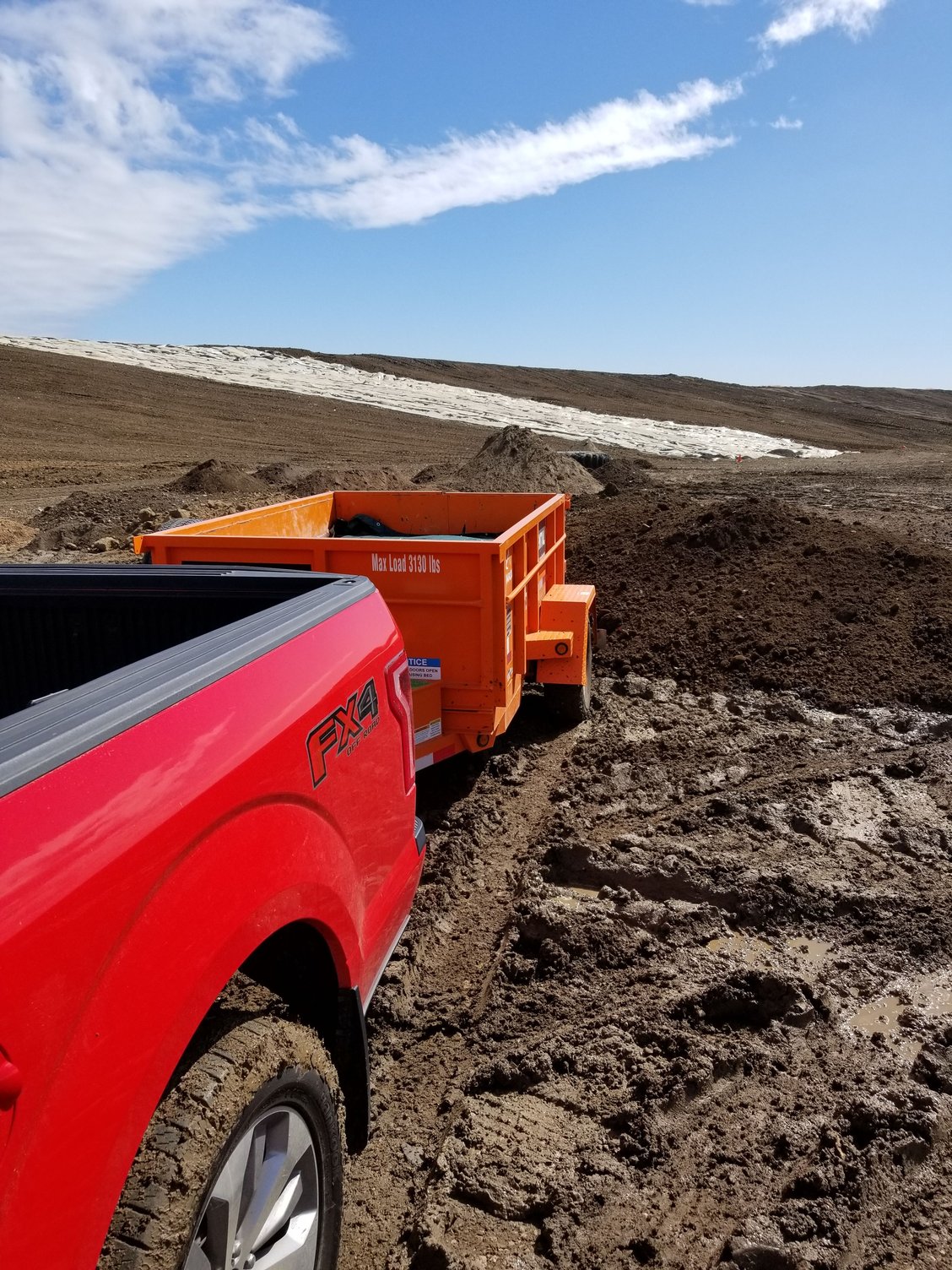

Lucky I'm alive I guess......

Mine's a '17--- but they didn't change axles since then did they?
