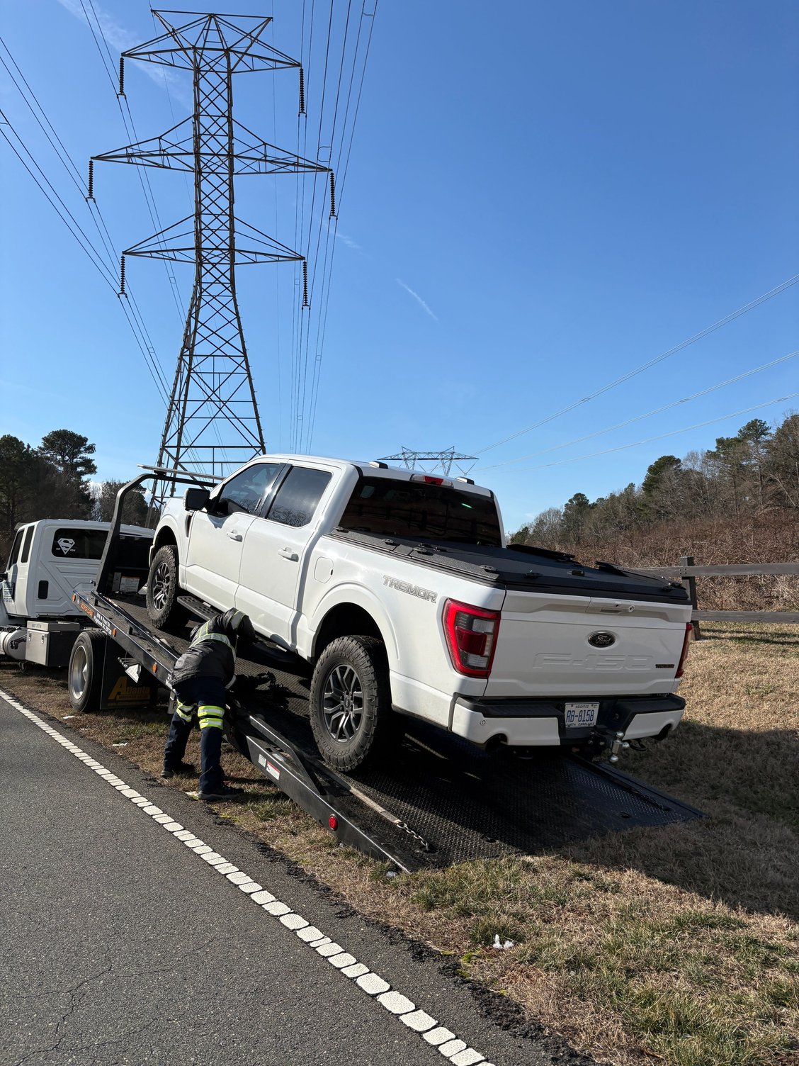

Cracked front differential
Same problem 2022 F150 stuck on ice, real wheels spinning then kaboom, front differential cracked in half.. Being covered under warranty but has to be a problem here only 50,000 kms on the truck. Front wheel were not moving despite being in 4 wheel drive.
I fear this is what happened to me yesterday. Parts of my neighborhood are still a solid sheet of ice, I was in for auto going really slow across some ice and as soon as my front tires were on dry pavement, I accelerated, I guess just the driver side had traction and it started making a really bad grinding noise. Again, I don’t have the official diagnosis yet.
it’s covered under warranty, thankfully, but the part is on backorder with no ETA

Crakes Feomt Differential
Front differential came in quickly and I should only be without the truck for about 5 days total but leaves me concerned on upgrading to a 2026 model this year. Sounds like this is a common problem.
QUOTE=Bannerman;21756449]I fear this is what happened to me yesterday. Parts of my neighborhood are still a solid sheet of ice, I was in for auto going really slow across some ice and as soon as my front tires were on dry pavement, I accelerated, I guess just the driver side had traction and it started making a really bad grinding noise. Again, I don’t have the official diagnosis yet.
[/QUOTE]
So the front differential ripped free from its mount and it fell down and was resting on the sway bar. No eta on parts. Possibly because this front differential has the Torsen
