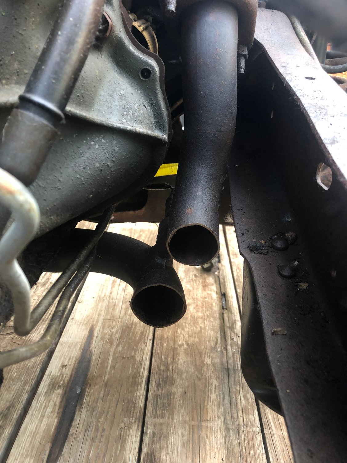

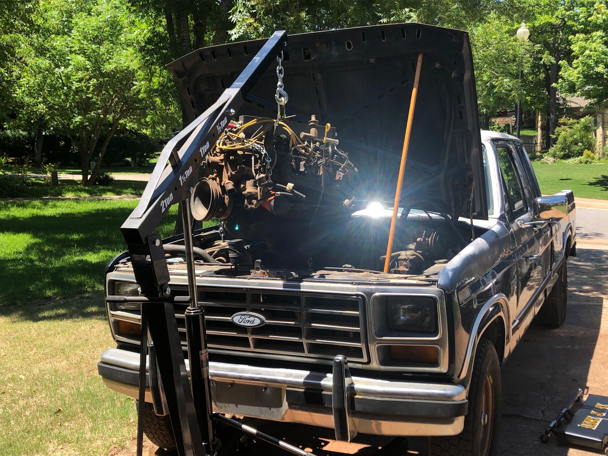

Engine is out. Definitely easier than the 5.4 I swapped in my 2010 Ford F150. Got it on the stand and started pulling it apart and it was pretty greedy on the inside. I’ll rebuild it eventually but for now it’s gonna be the 302. I ordered the correct flywheel today. Tomorrow gonna pull the engine from the donor and start getting it prepped to go in. Going back and forth between try to keep it injected or not but pretty sure I’m gonna carb it. Pretty sure the original starter will be used correct? Since it bolts to the bell housing and flywheel size will be the same (164 tooth). Biggest challenge will be exhaust I think. I’ll try to post more pictures do you can see what I’m dealing with.

Here’s the exhaust situation. I think adding onto these will be doable but if I had a two into one adapter that would be best. Guess we’ll see just how good my welding is.

Here's a y-pipe.
