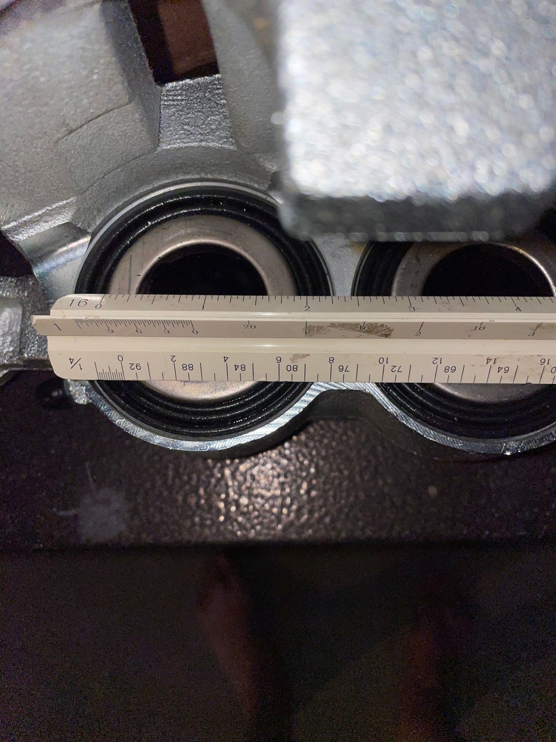

Originally Posted by djed
Piston diameter MUST be the same side to side or you are going to have a pull to the side with the fatter pistons every time you step on the brakes. Laws of nature equate this to having one lever be a little longer on one side than on the other and the caliper with the bigger pistons will apply more braking pressure to the rotor. Resulting in the vehicle wanting to dive in that direction every time you use the brakes. I cannot tell if the pistons are the same or not by the picture.

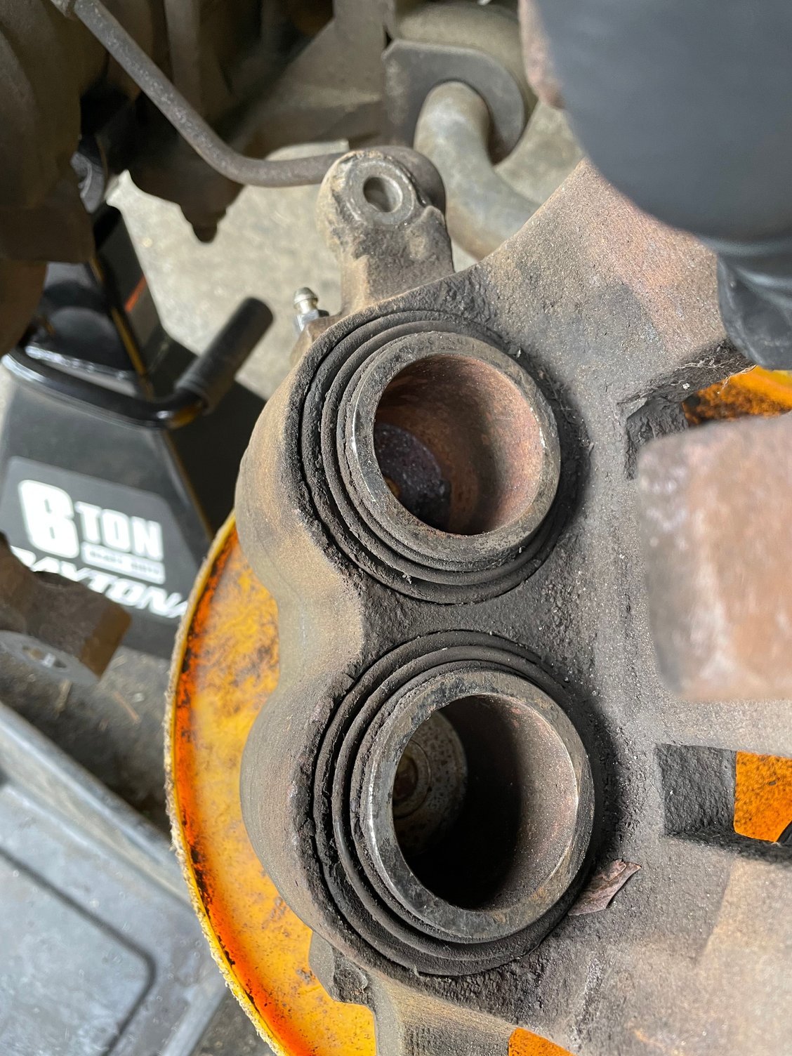

Originally Posted by Brandonpdx
What exactly was wrong with the old one? Started to drag?
Truck was pulling to the right. Pulled driver’s side caliper and one of the pistons was frozen.

Those are chonky pistons!

New caliper arrived. Piston diameter appears the same.

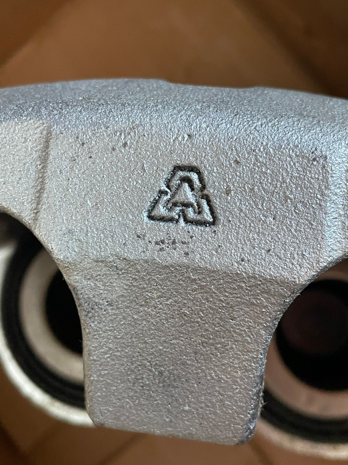

Does anyone recognize the logo stamped on the caliper?

Dharma Initiative. We are all in purgatory.

Not familiar but I like the protective coating

The piston diameter on the calipers in pics above were the same. The piston bores cannot change much, but there are different piston and seal designs - as seen in pics. I still always replace calipers in pairs. There is no reason to buy anything but locally-sourced ‘lifetime warranty’ calipers. If you keep your truck, they’ll need replaced. I inspect them at pad changes and replace if the rubber seals look compromised.
