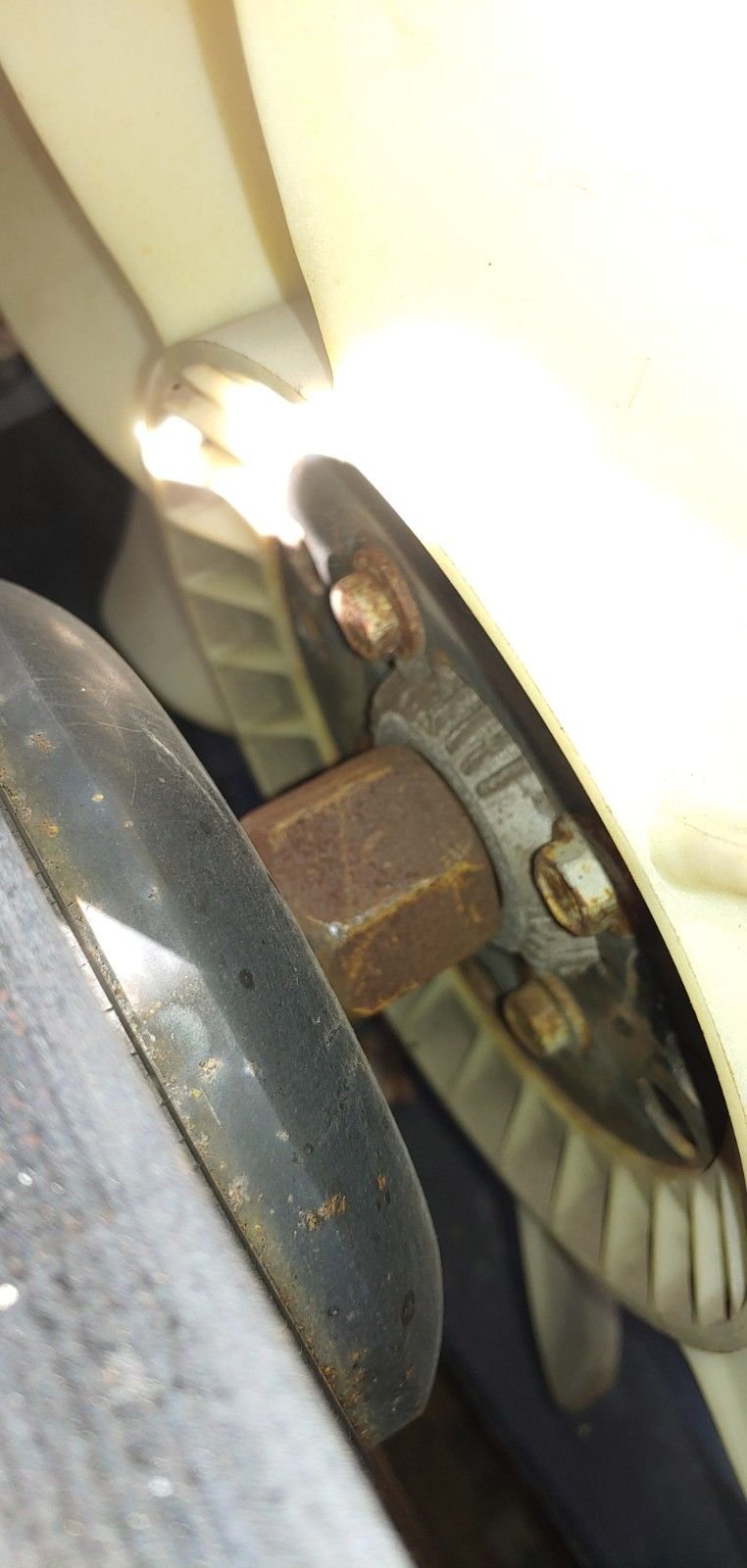

The probelm lies in the clutch is extended out to take up space on the v8 where the i6 needs the space to fit, and the bolt pattern for the fans being different, one could make a plate to adapt it i suppose but the thread I found that pic on was very confident that a 96 vortec 4.3 5.7 fan fit the 4.9 fan clutch, which, may be true if the fan clutch bolt pattern changed in 94 for the 4.9 when the fan clutch thread changed (because you have a pre 94 4.9, and i have a post 94, we know its not apples to apples.)
I didnt think you were being a ***** lol, I was just saying we need answers!!!

Stock GMT 800 fan on my 6.0
heres the same fan up against the bolt pattern for the 1996 4.9 FAN CLUTCH, (thats an autozone special for 96 4.9 with AC)
