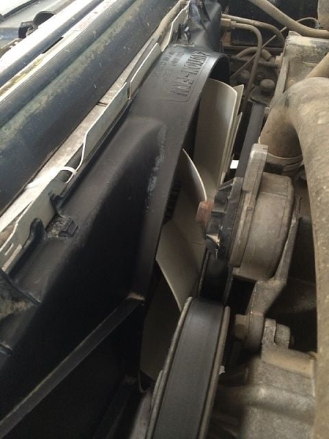

The pictures of someoen elses setup I have , used a 96 (and around that year wise) 4.3l vortect plastic 11 blade fa
n on the Stock fan clutch for our trucks. What year truck you have? because I could be wrong but I believe the fan changed when the hub for the fan clutch changed i think in 94.
To my knowledge, only a 4.3 or 5.7 vortec from the 90s will fit the 94-96 i6 fan clutch, but I am not sure 100%. if the fan never changed during the EFI periods of the 4.9, then the same fan should work 87-96. However, im not sure of f250 or f350 applications or if it is only with 1 core rads or if it worked with 2 cores. I have a 2 core. I also have a 1996 c1500 silverado with a 5.7 vortec and this fan. I will try and pull it one of these days and see if it will fit without mods or anything on my i6 (1996 f150 with 2 core rad and 7 blade fan)

Originally Posted by AuroraGirl
There is something not right with that fan. The blade shape is not correct for the rotation. Might just be me.
I thought that too, but it is correct/ ideally it wouldnt be so close to the shroud
It's the blade angle. It can't be that efficient.
If that blade is turning so it can pull the air through the radiator, the curvature of the blade is not right.

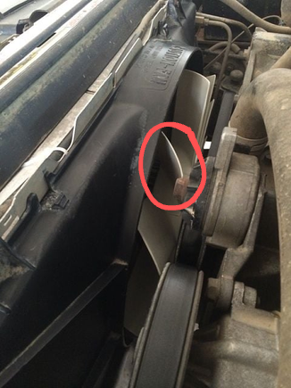

Here is the stock fan vs the picture above again
checks out to me

Not the angle of the blade, the curvature of the blade. The factory blade is cupping/scooping the air, the other one is like a reverse spoon.
Thanks for posting those pictures, I was too lazy to look it up.
