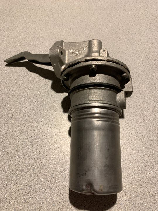

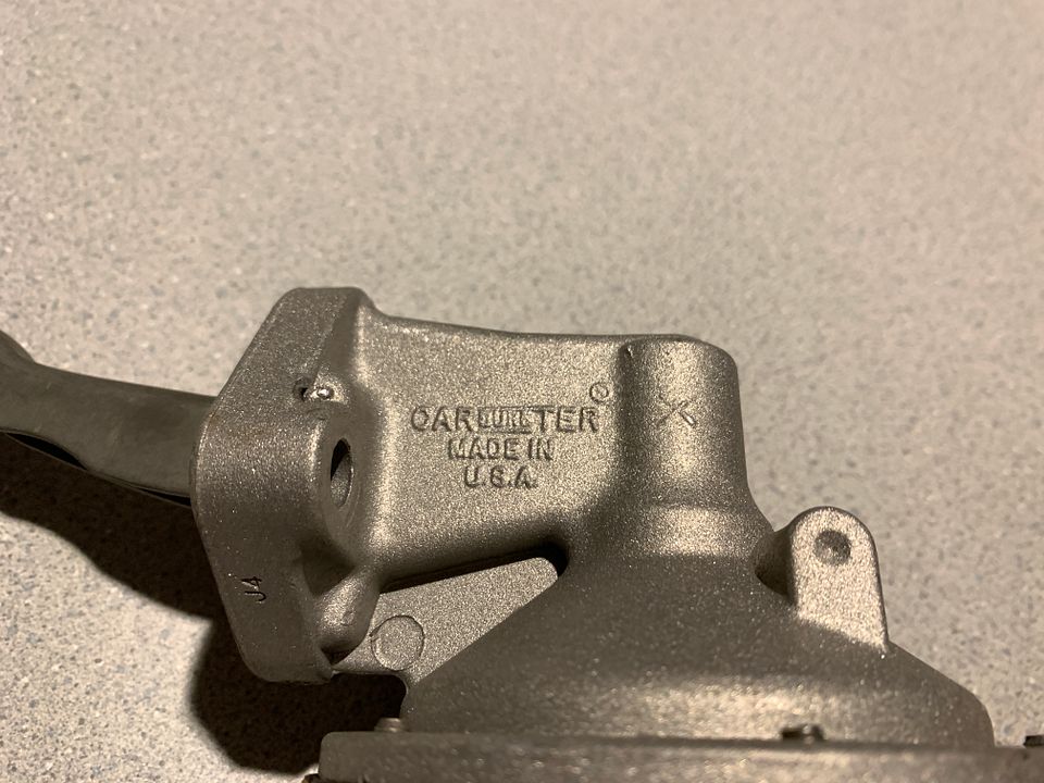

Swamp rat, there are quite a few new or reman fuel pumps having the screw on canister on EBay, if you use them. I got one a while back that had the canister stamped with Motorcraft in ink.
