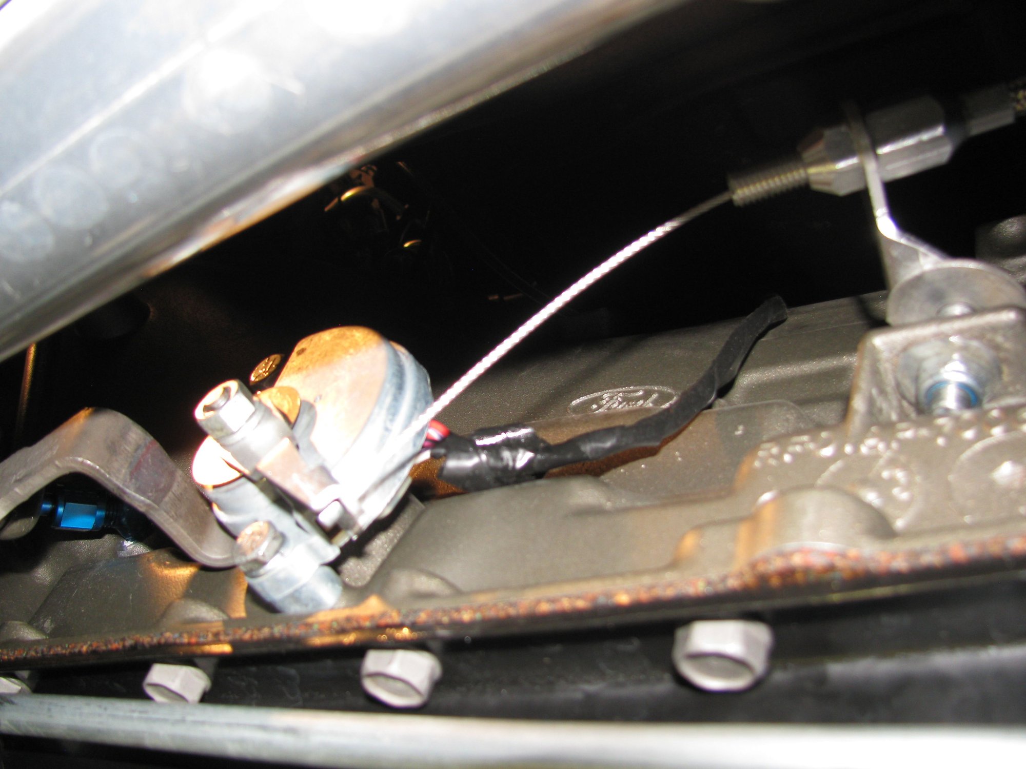

Kickdown
Here is a picture of a Lokar kickdown not the best picture but I'm not crawling under there to take another.

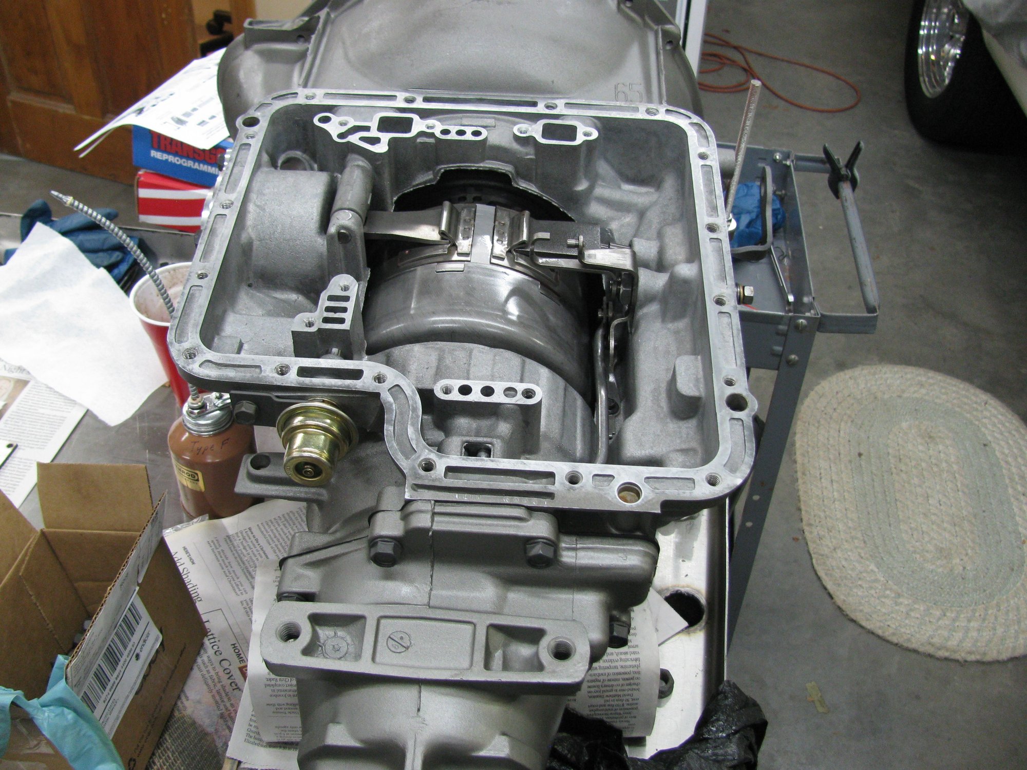

Here is a picture of a C6 I was rebuilding. As you can see even with the valve body out it is a tight place to try to get a wrench in to remove the 7/8 nut on the manual lever. If you are lucky enough to have a C6 with the screw in modulator the shift detents are in the valve body if it is a push-in type, then the detents are in the trans case, and you will have to fight the spring to get that lever changed.
