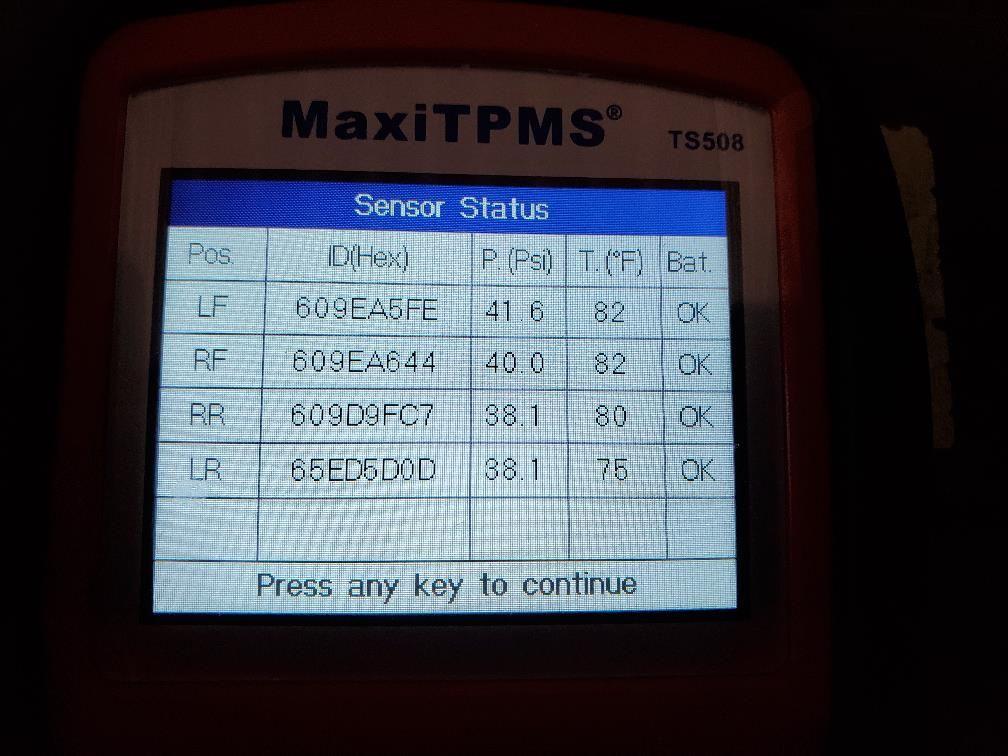

Just so you guys know. The factory sensors themselves do not get "programmed".
They each have a unique ID, and the TPMS system in the car is what has to
get "programmed", by recognizing that ID.
Now they do sometimes need to be "woken' up, as they stop displaying any signal
to save batt, if not in use for a while.
Aftermarket sensors like Autel's, can be programmed with any of these unique ID's.
On my Shelby, my second set of wheels/tires for track, I used the exact ID of the factory
sensors for each Autel sensor. No re-learning needed ever, you just don't want to store
the extra set of wheels tires, near the vehicle when parked.
