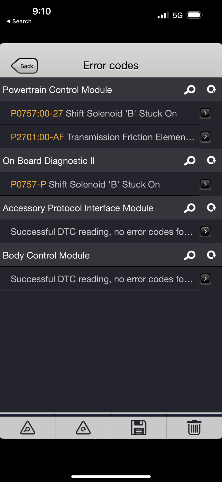

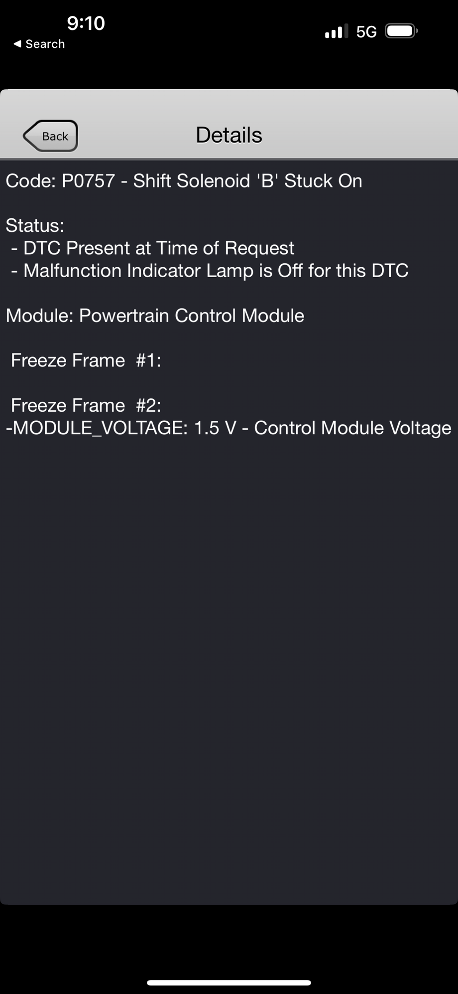

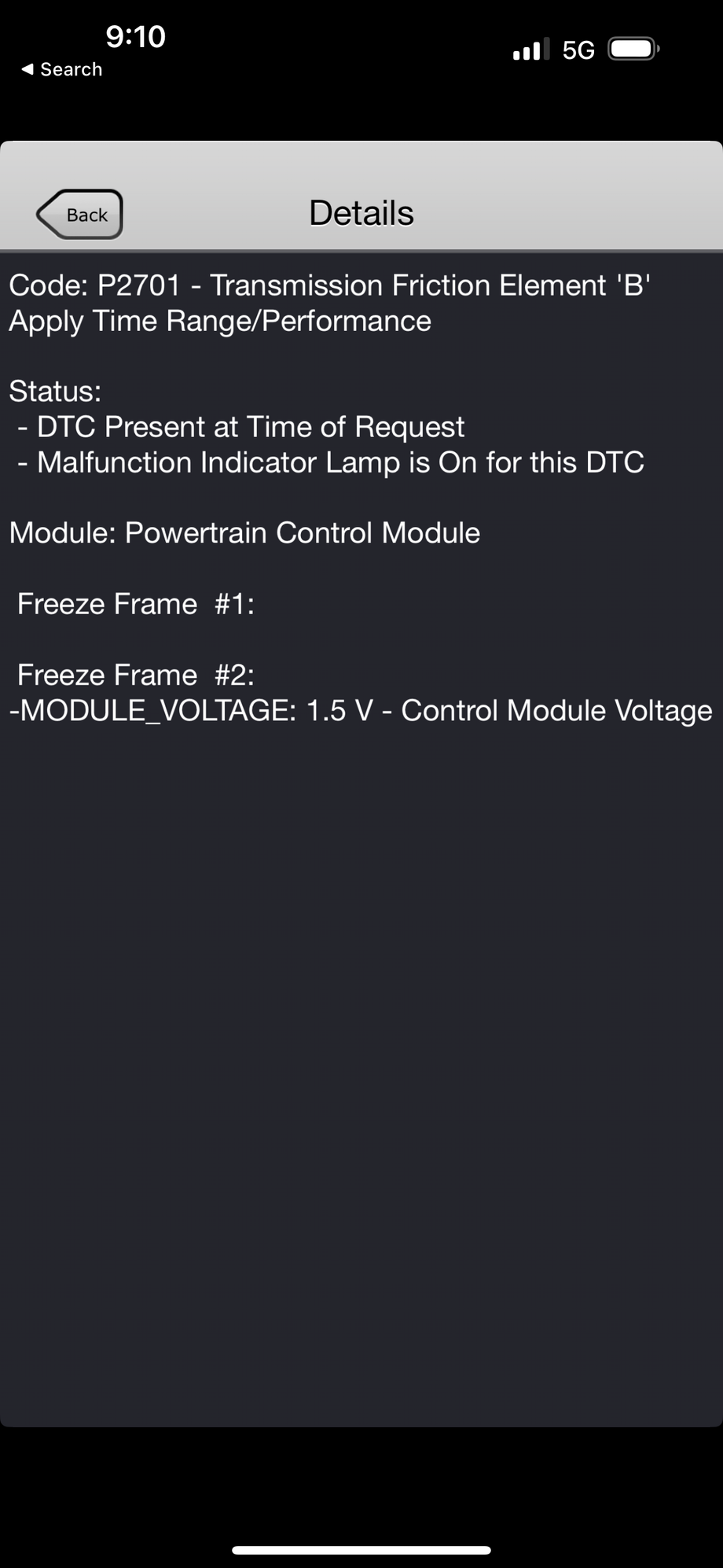

anyway, was pulling a trailer today, and got a wrench on the screen, truck jolted and seemed sluggish, plugged in forescan connector and getting 3 codes listed below.

Looks like shift solenoid B left the chat for some reason. Either it’s just faulty or it’s possible it got a little piece of trash in it. Either way, it’s probably the cause of your “jolt” you felt.
Not a difficult job to replace for your dealer. Hopefully, they get you fixed up quickly.

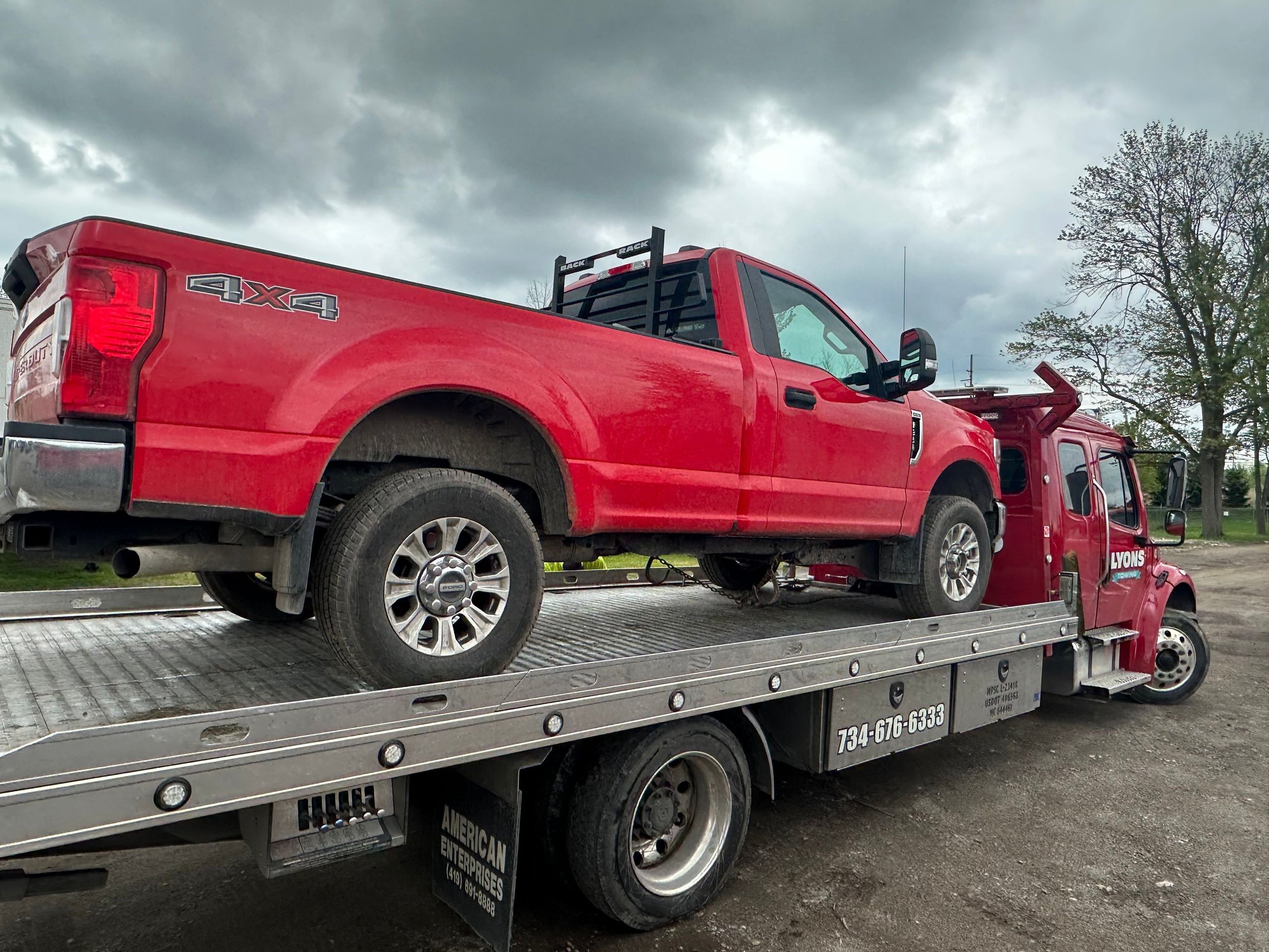

I drove it today in the yard, it jolts pretty good and shifts from 2nd to 8th and was super sluggish, it went on a flatbed to the dealership.

That's too bad, RCLB in red is a good looking set up.

The towing company was nice enough to color coordinate the wrecker.

they’re a top notch towing company, the FD uses them all the time.
