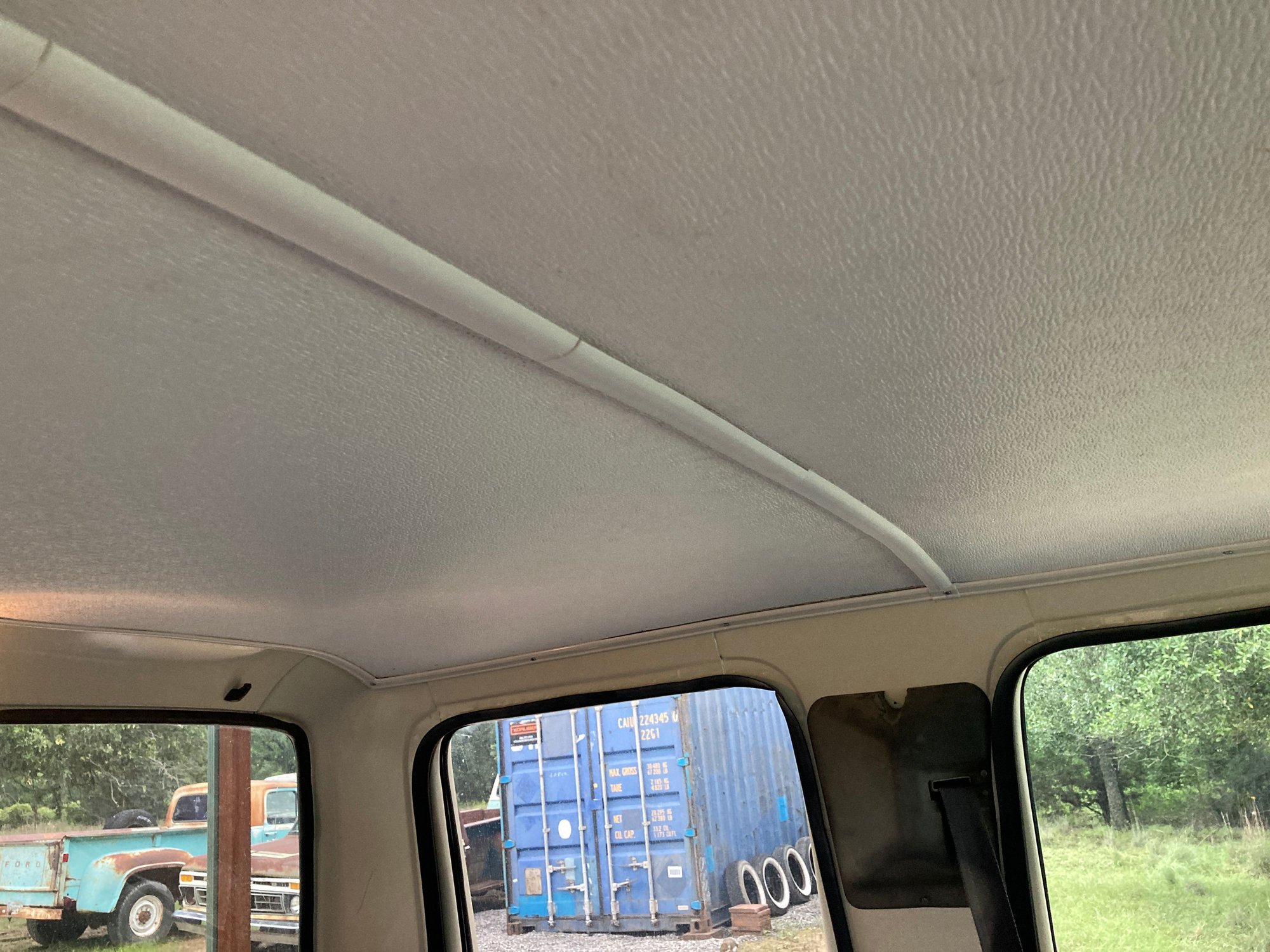

As promised, a plain white headliner in a plain white truck… also pictured is my 3D printed divider trim that is a work in progress.

^^ That looks like FRP ( fiberglass reinforced paneling). It's used around food prep areas in commercial buildings. There is trim made for it.
https://usfrp.com/products/FRP_Accessories.html

Tricky thing is that the headliner divider trim snaps in place and attaches to a rolled bead in the truck. It actually supports the headliner in the middle as well. As far as anyone knows it is not reproduced and was only found in ford crew cabs of this era and certain vans.
