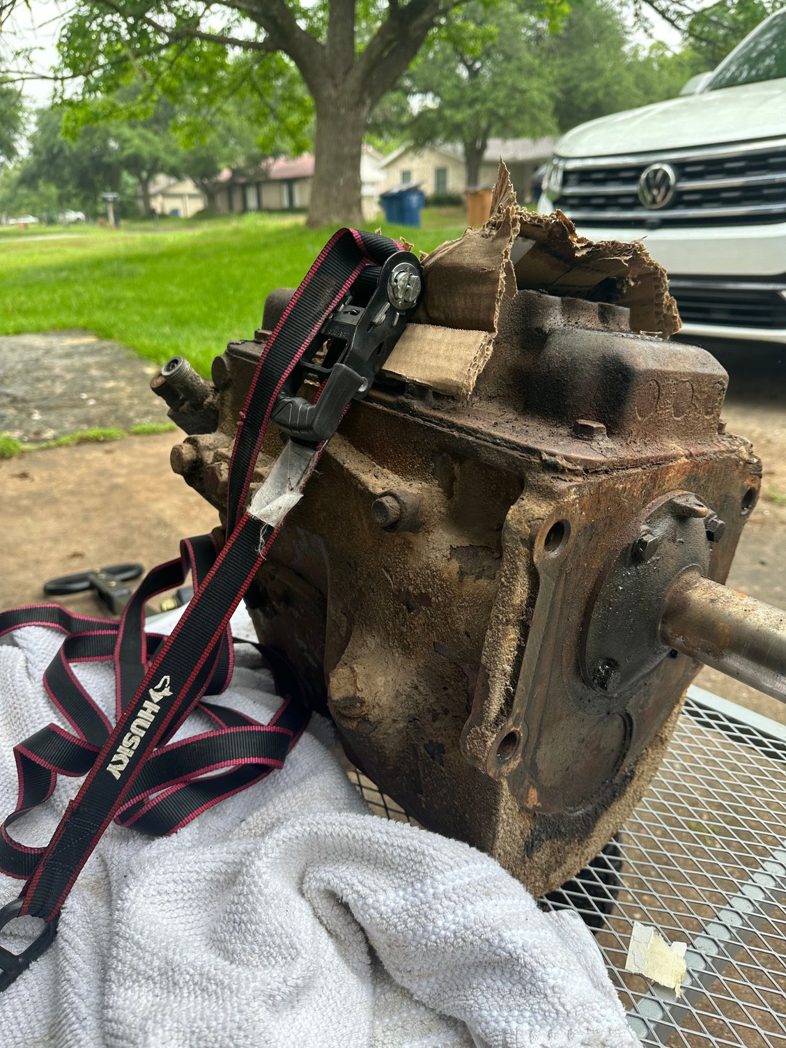

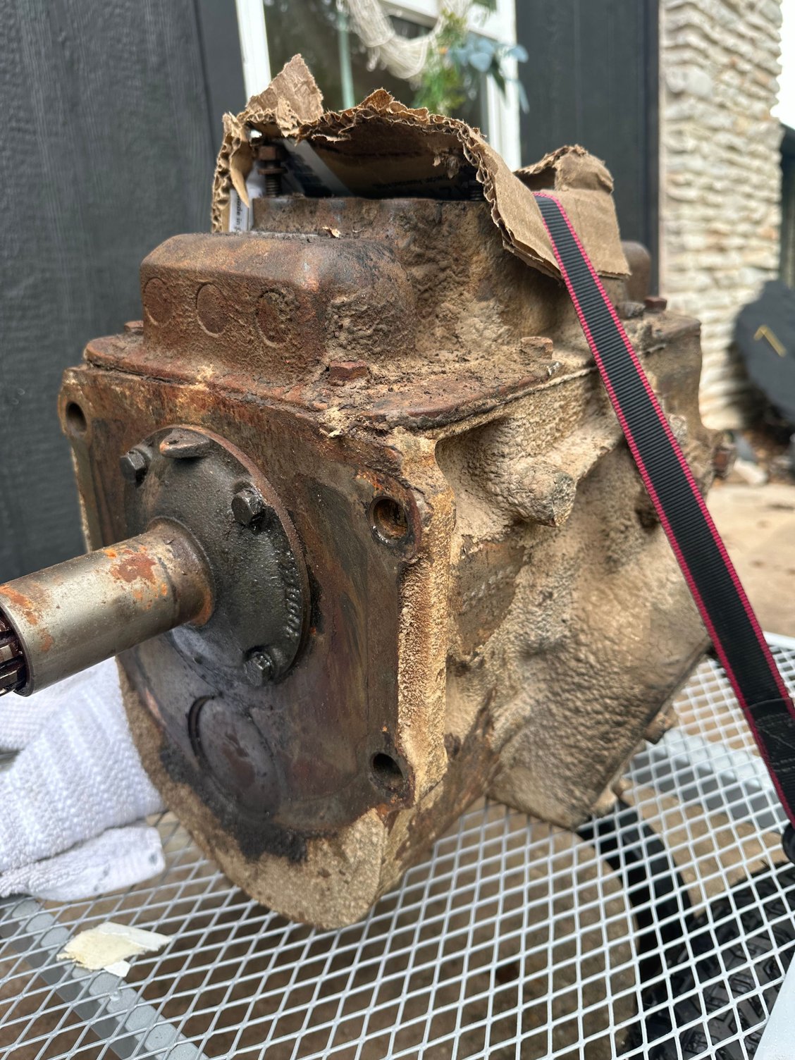

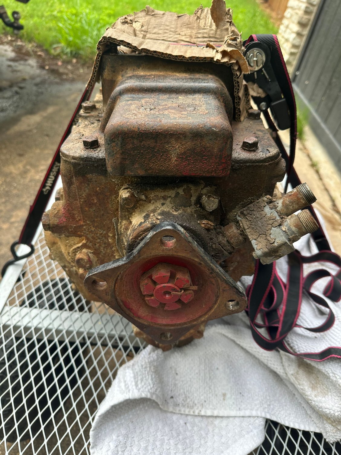

Hi all,
Bought this transmission and trying to get an ID on it. Researching 1940’s Clark transmissions is getting me absolutely nowhere since all I’m finding is 385’s.
204 VO?
205 VO?
anyone have specs or info?
Got lucky on an old eBay page. 204VO?

Assuming a Clark 204VO (48/52 Ford F7):
B9TT-4813-A Oil Seal 2 1/8" ID, 2 7/8" OD, 1/2" Thick (Crosses with National
417537, 470898, 510119, 6879H)
TGAA-7025-A Input Shaft Bearing 2.1651" ID, 3.9366 OD .8266" wide, .111" snap ring groove (Crosses with National 1211SL)
09B-7025 Rear Countershaft Gear Bearing (Crosses with National 308SL)
7EQ-7065 Output Shaft Bearing 3.5429" OD, 1.5745" ID, .9025" thick, grooved for snap ring (Crosses with National 308L)
7EQ-7118 Front Countershaft Gear Pilot Bearing 1.7328" ID, 2.8343" OD (Crosses with National M1207EL)
7EQ-7120 Output Shaft Pilot Bearing, Reverse Idler Shaft Bearings, 1 5/8" OD, 1 1/8" ID 1.38" long (Crosses with Timken J361644)
