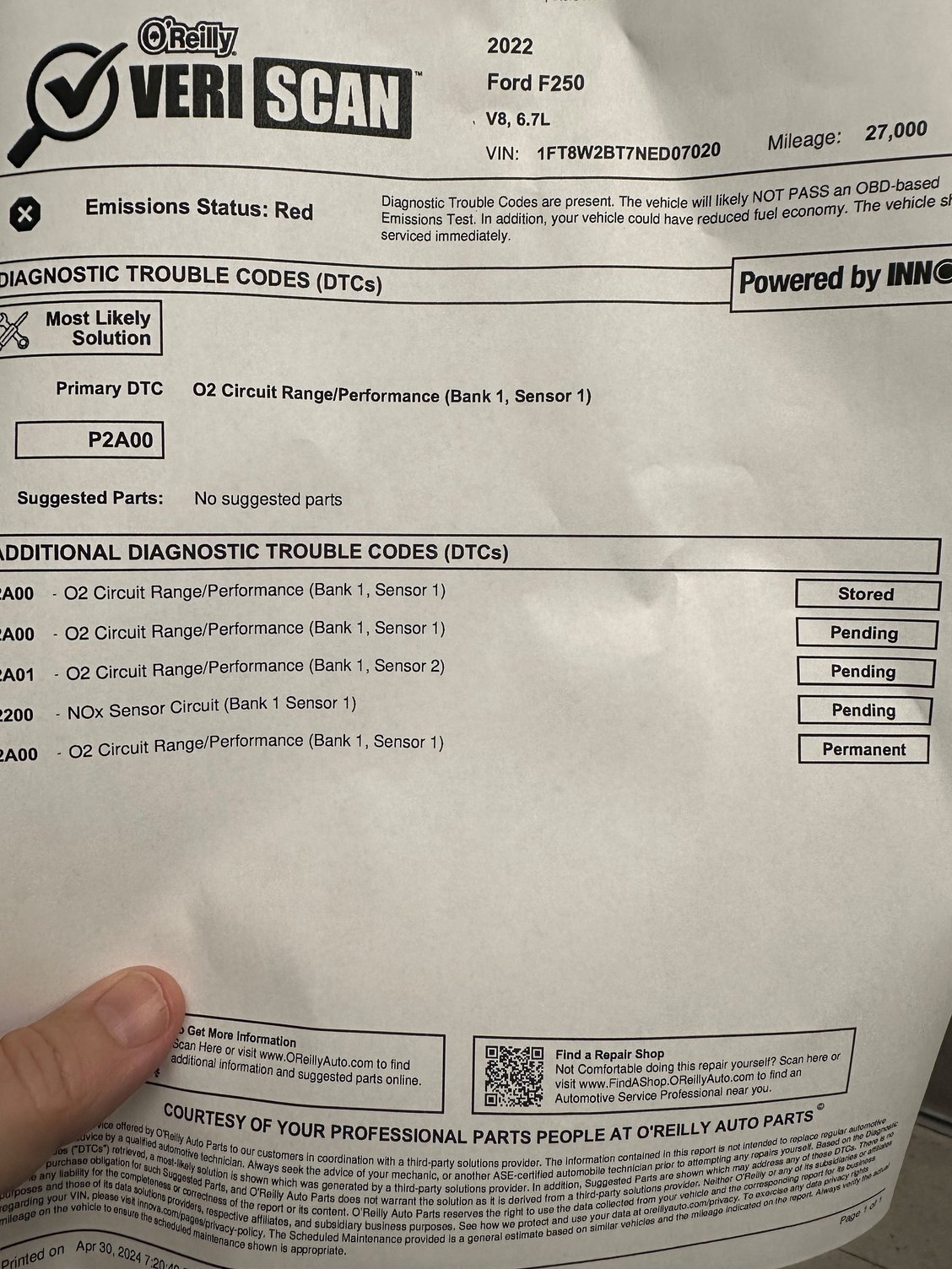

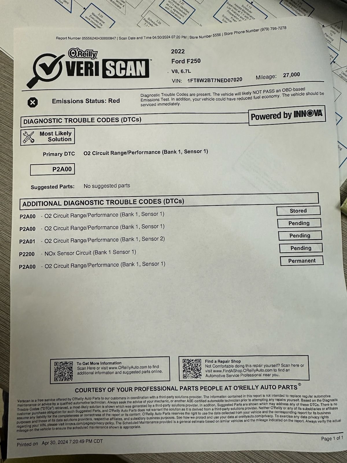

2022 F250 KR 6.7 PSD
Codes;
P2A00 O2 Bank 1 Sensor 1
P2A01 O2 Bank 1 sensor 2
P2200 NOx Bank 1 sensor 1
Old May 1, 2024 | 11:21 AM

A better photo.

Looks like either a bad NOx sensor or a issue with the sensor harness or harness connectors.
