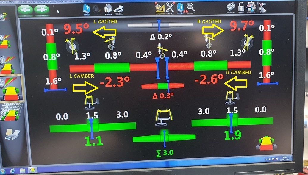

So here are the measurements as the truck went in.
Casters are way out but close to even, same with camber. slightly out but close to even.
He toed it in slightly but that's it.
still pulls to the left, just have to live with it. It's not severe or unsafe, just annoying.

If I'm reading that right the numbers in white are for a 1985 Courier and are meaningless. The ones in red are your specs. if that's correct your truck is ridiculously out of alignment and needs those "I" beams bent or replaced. If you leave it like it, is you will be buying a lot of front tires.

i agree that i'd be looking for new beams or hoping to find the unicorn alignment shop that can bend them... you "can" do it yourself with a torch and jack. if you wanna look up youtube videos of people lifting their 2wd trucks and correcting the camber and caster, it's pretty straight forward, but just because its straight forward doesn't mean everyone should jump in and do it. it's easy to mess up and it's the type of thing you want to be meticulous about.
not sure i'm reading that screen right but it looks like you need a lot more caster. you "could" do that by lowering the frontend with shorter coil springs, but that would also give you more negative camber though. more caster wouldn't necessarily stop it pulling to the left, but it would make the force pulling less as it would help it want to naturally center better. i can't find the specs, but i bet the minimum caster you want is 3-4 degrees. when people experience death wobble with 4wd's its generally recommended to shoot for 6-7 degrees.

Other than changing ride height, how exactly is caster usually adjusted/tweaked on a 2 Wheel Drive?
is it also from bending/twisting the beams?
And I can’t say I’ve ever seen an alignment readout screen with that look. I like symbols just as much as the next person, but in this case, it would be nice if they simply spelled out what you were looking at!

This is how I read it.
Yes, out of spec when compared to the Ford document.
(fact specs optimum desired: caster +4deg, camber +1deg.)
Haven't seen excessive tyre wear, except some on the inside of front right.
Yes, I believe the white figures are not for f100, but the machine should still measure correctly.
