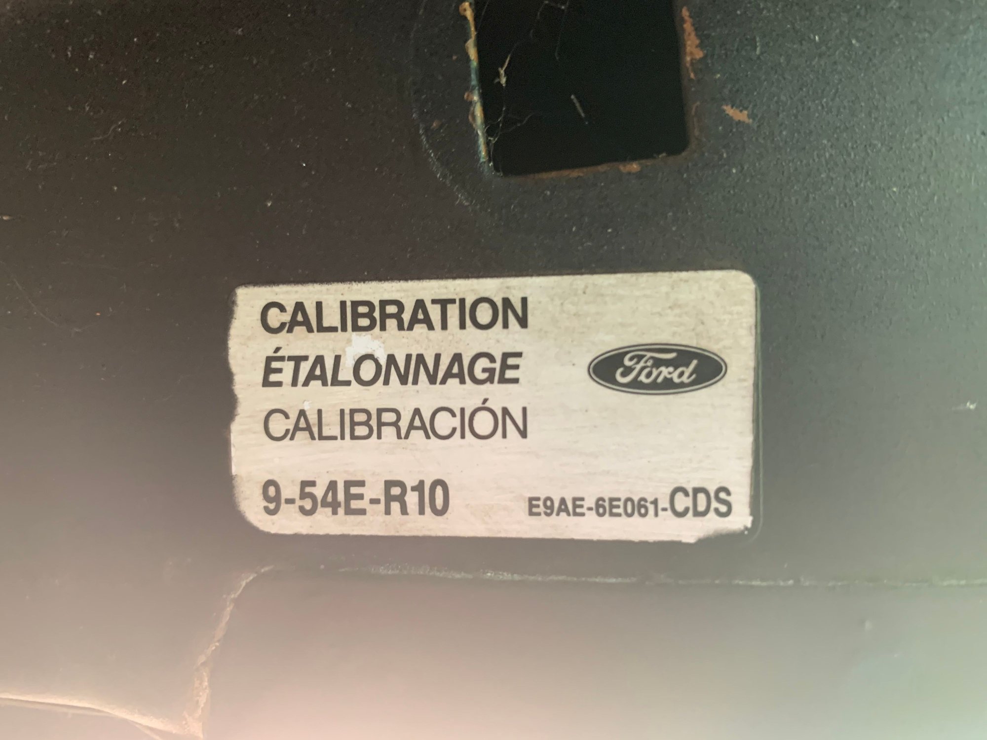

I really just need to get a new ECM. it was in pretty rough shape and my sketchy soldering job didn't do it any favors. I can't seem to find what ECM would go with a 5.0 V8 and C6 tranny bronco. to make matters worse the emissions sticker is missing from under the hood.
I have the calibration code. think I can figure anything out with these numbers?
VIN number is: 1FMEU15N3KLB45079

There is no processor for a 89 with a C6 IIRR
By 89 the C6s were gone out of US trucks
You will need to replace the processor with one for your original application / calibration
Use the numbers off the processor you have to find another.
