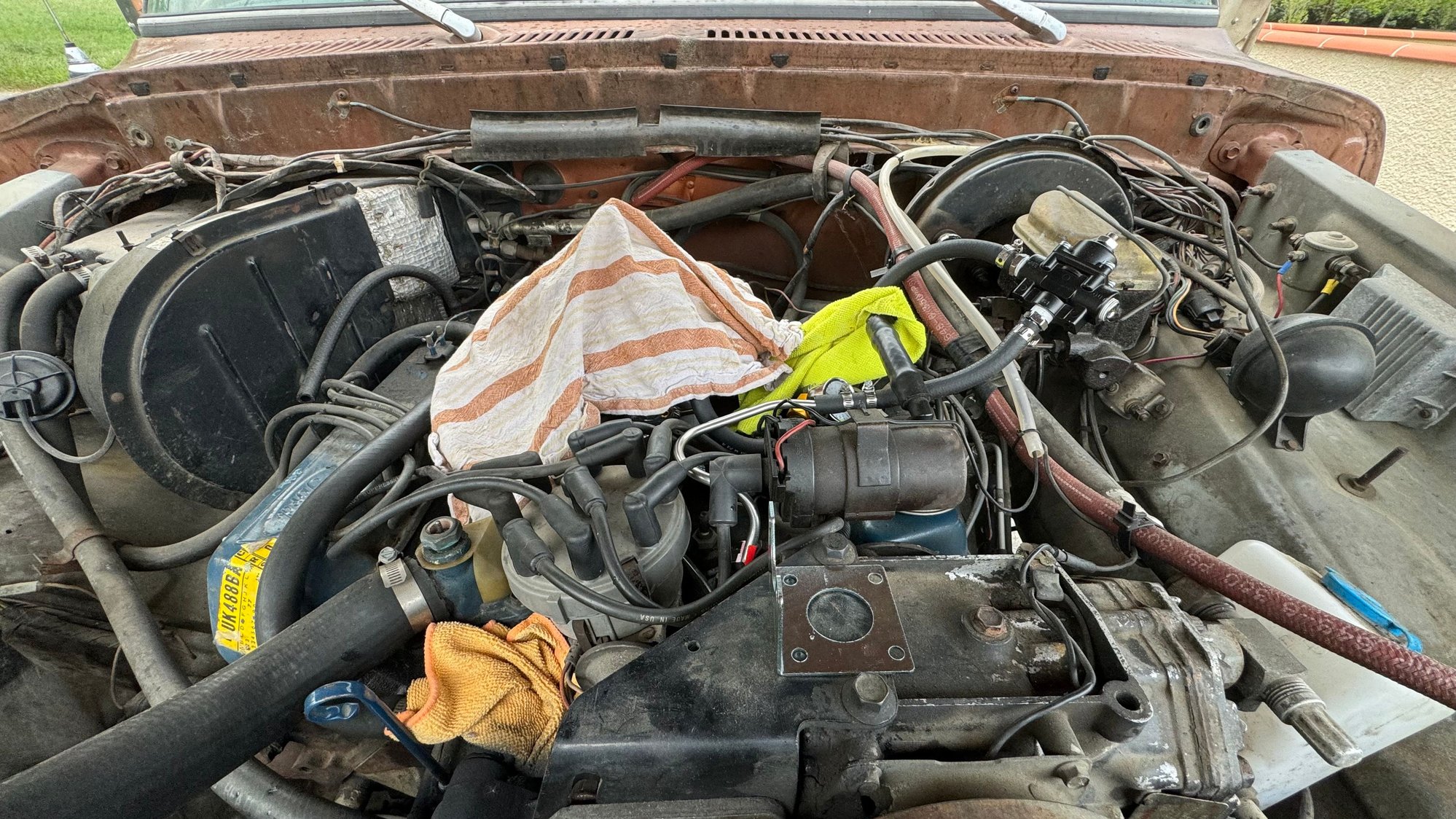

Hello guys
according to you, what would be the better place for my fuel pressure regulator ?
i was thinking on the ac compressor ?

Old May 10, 2024 | 04:05 PM
Ericfromfrance's Avatar
Ericfromfrance
Joined: Aug 2021
Posts: 144
Likes: 21
This the setting i choose
