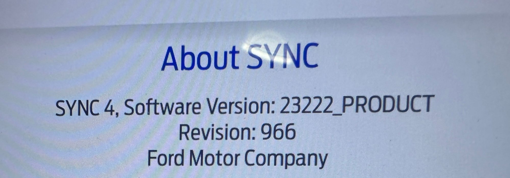

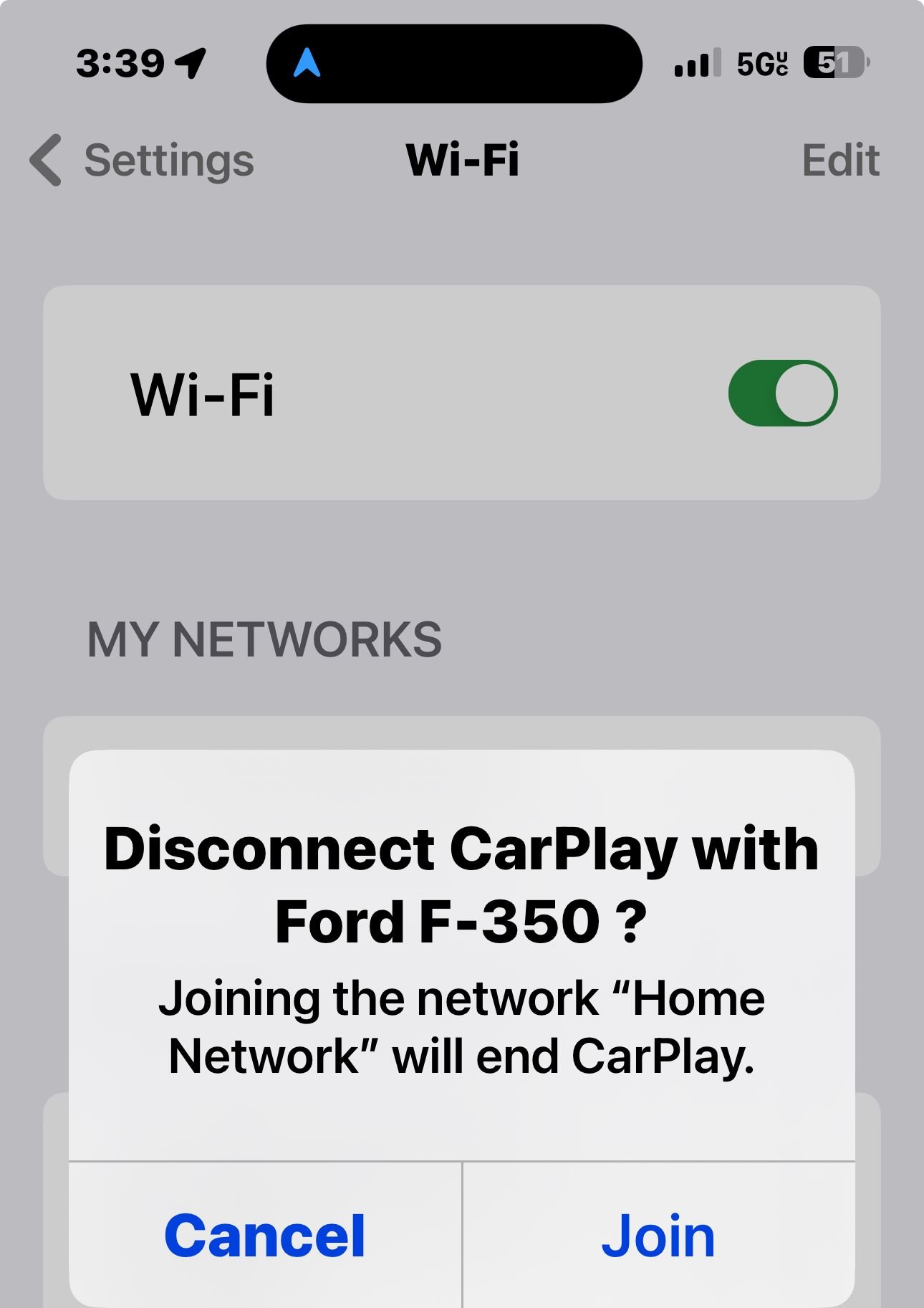

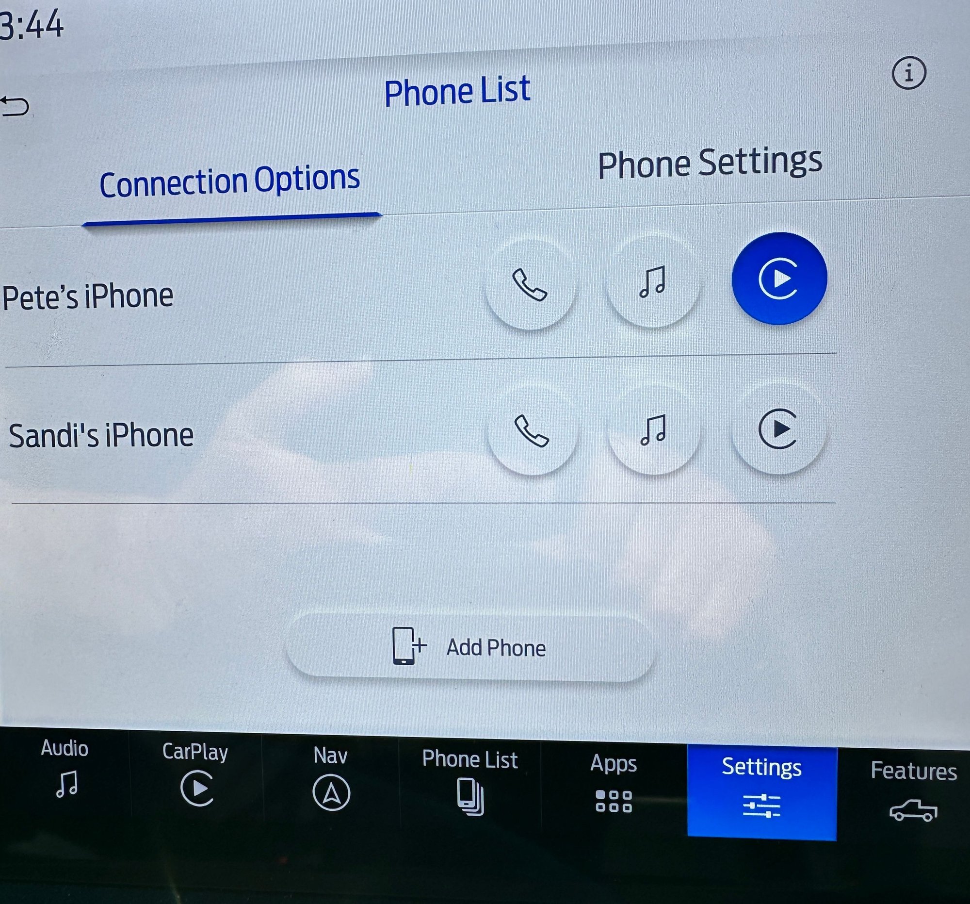

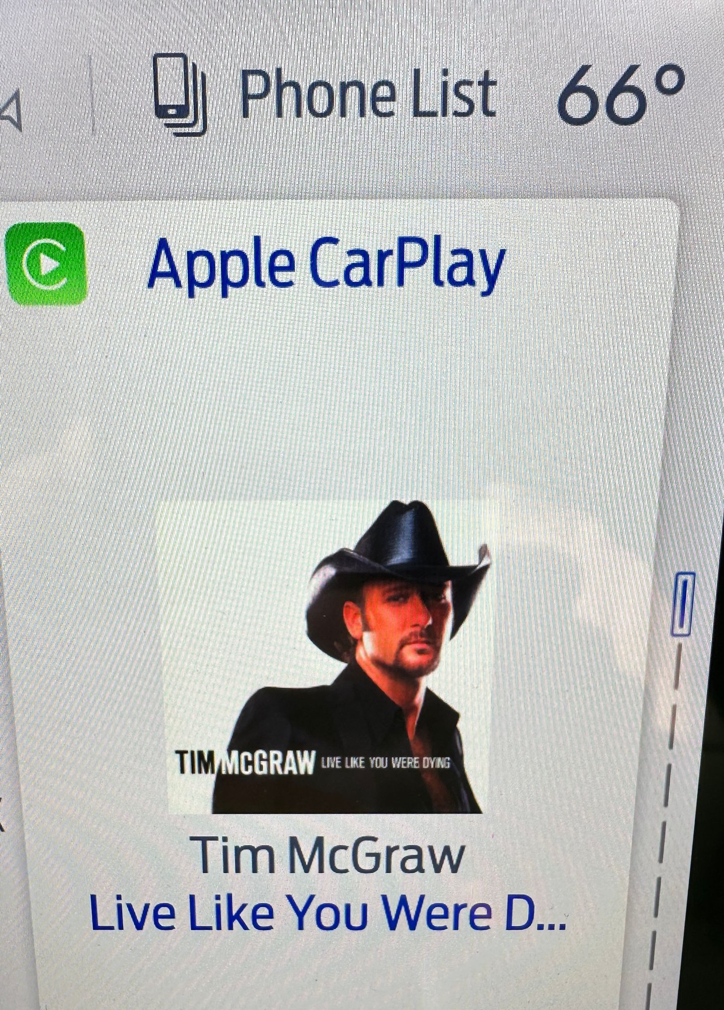

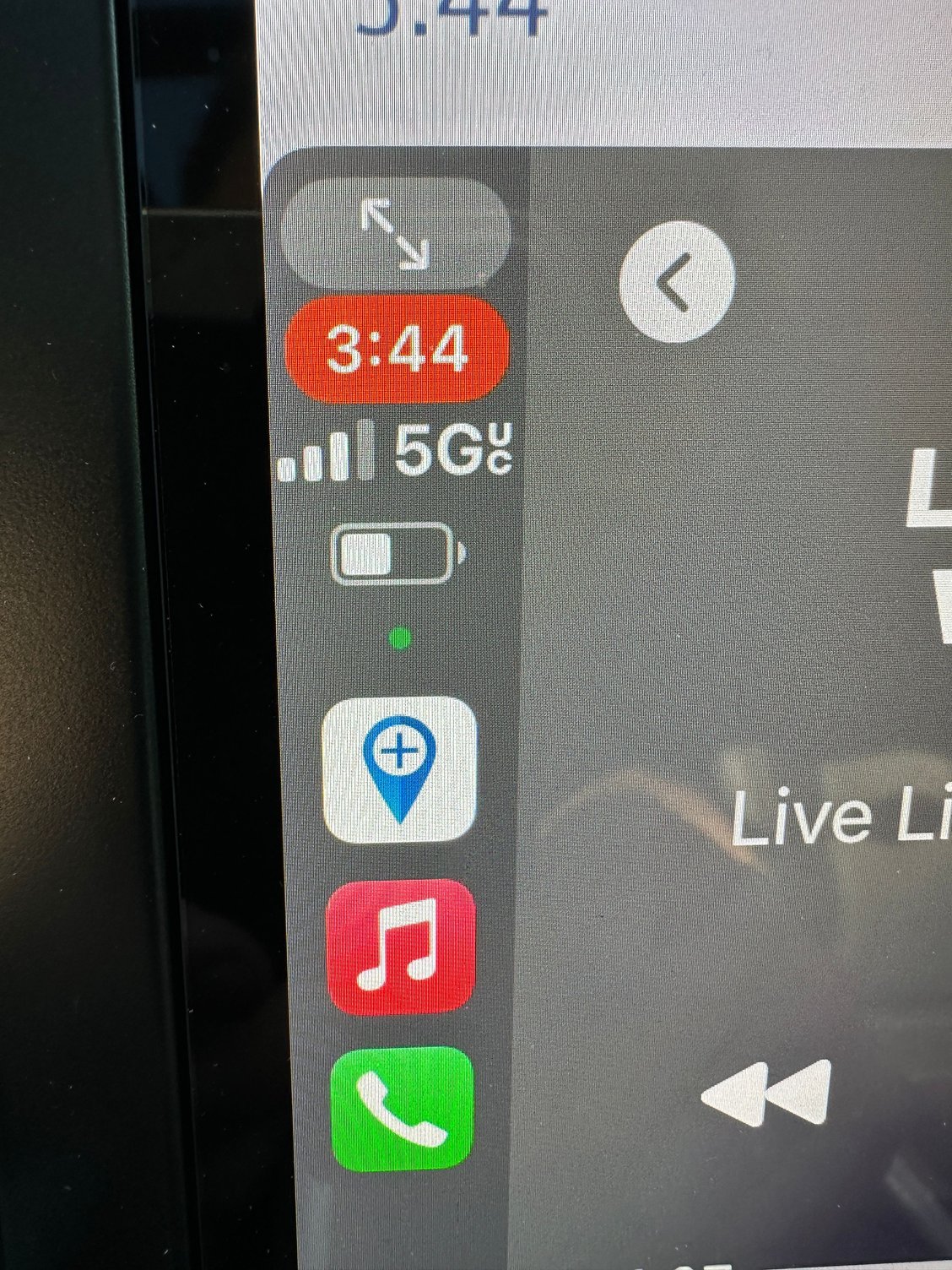

I was interested in finding out as some stated CarPlay will work connected to a different WiFi source, others said no.
So at least on my 2024 Lariat with the Ultimate and BAP packages, it will not.
Here are a series of pics I took in somewhat a chronological order to show before, and after CarPlay connected. First one shows the SYNC software version.
If nothing else comes of this, maybe it will help someone who is researching this.
SYNC Version Info
Phone list

Trying to connect to Home WiFi will disconnect CarPlay
CarPlay active, phone list in side menu screen
Edited bottom menu to add shortcut to phone list
