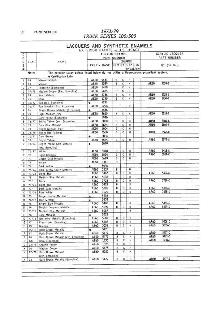

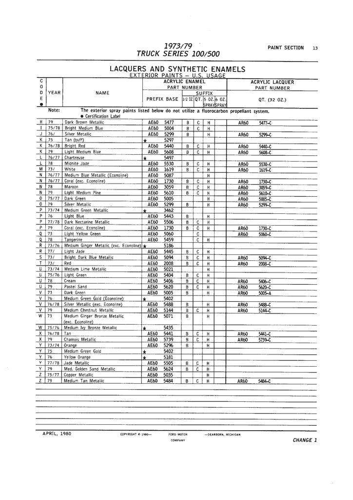

Old Apr 24, 2024 | 01:36 PM
tbear853's Avatar
tbear853
Joined: Feb 2004
Posts: 10,809
Likes: 2,605
From: The Shenandoah Valley
Originally Posted by tbear853
These may help?
Ignore my red marking.

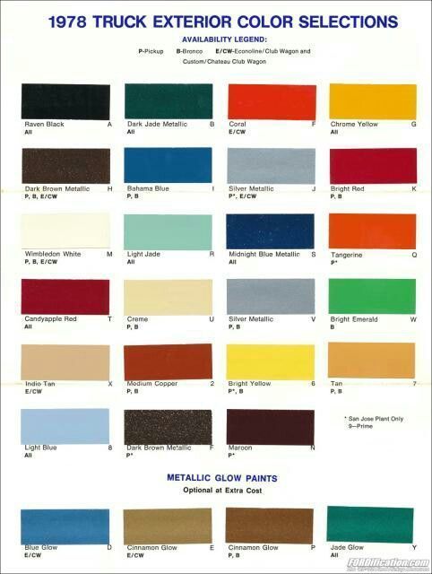

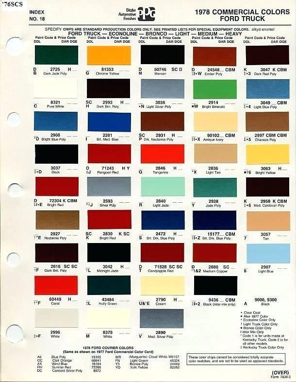

Old Apr 24, 2024 | 01:44 PM
77&79F250's Avatar
77&79F250
Moderator & parts slinger
Posts: 50,194
Likes: 5,795
Pay no mind to the yellow highlight.
