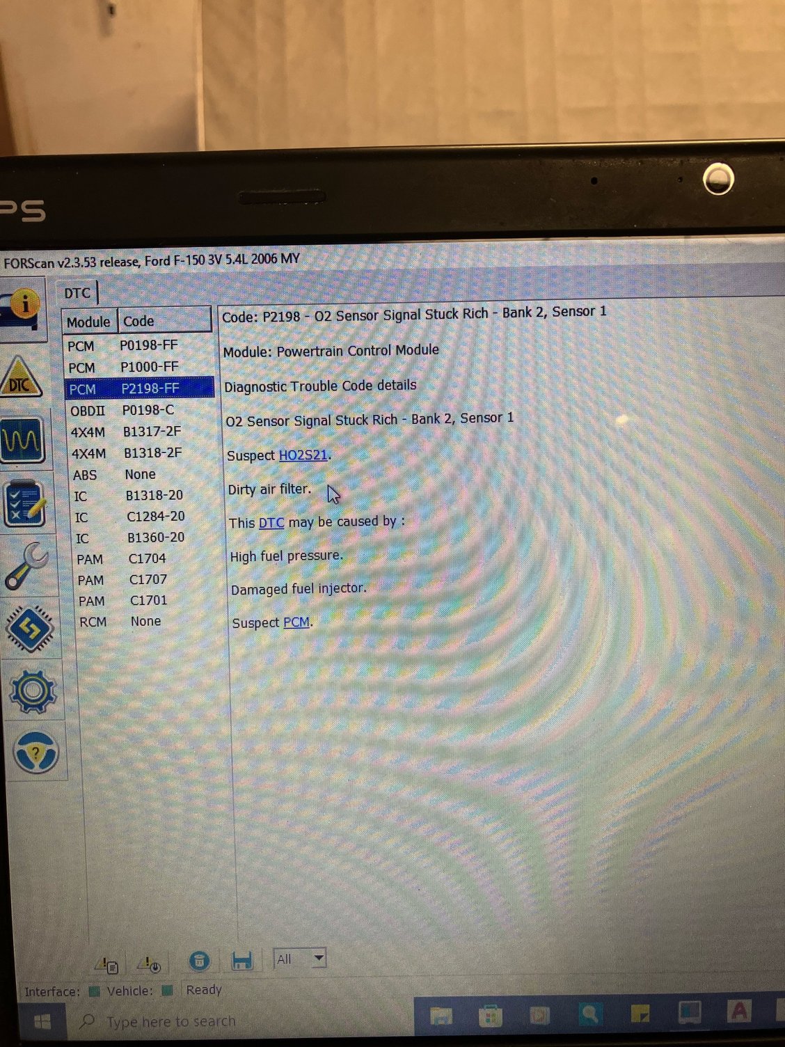

Hello all,
Its been a while since ive been on here but i could really use some help decifering whats going on. I have a 2006 F150 king ranch with 204k on it. Last summer, the motor locked up. Lost oil pressure and spun a few bearings in the bottom. I decided to replace the engine with a running engine from a salvage yard. Before i put it in the truck, I pulled the from cover and replaced the entire timing set with all Motorcraft parts, oil pump with a melling mv360hv, and new manifolds. I finally got it in the truck and when i finally got it fired up, its only running on bank 1. I verified this by unplugging each coil pack. I then swapped coil packs from side to side and didint follow, swapped spark plugs side to side and didnt follow. I then unbolted a coil pack, left it hooked up and put a plug in the boot and started it up to verify I had spark on bank 2. I have verified that the injectors are at least operating by taking a long screwdriver and listening to each one.
I have included in this post a video of Forscan live data and a screen shot of all codes. I am not real fluent with Forscan so i am hoping someone can help me but after seeing what forscan is showing, I'm starting to lean toward i got somthing messed up with the bank 2 cam cuz as you can see in the video, if i understand it correcting, bank 2 is way off.
P.S.- there is no backfire through intake or exhaust.

I'm assuming the blown engine was running acceptably despite its issues? If fo I would suspect the PCM has developed an issue OR that the PCM>injector/COP wiring harness for Bank 2 isn't connected properly or has its own problems.
If this isn't the PCM then look to a problem where that wiring harness connects to the PCM for loose fitment etc.
Hope this is easily solved.

Last night in my diagnosing, i did pull all connectors at PCM and checked for corrosion and bent or damaged pins. I found nothing. After pondering over it all day while driving down the road, I am wondering if the oxygen sensor is whats causing my issue. I have a code reader that also lets me see a few parameters and it was showing that the Bank 2 oxygen sensor was reading -25% while the Bank 1 oxygen sensor was reading +25%. plus with the code of bank 2 oxygen sensor stuck on rich. i am starting to lean towards a bad oxygen sensor.
