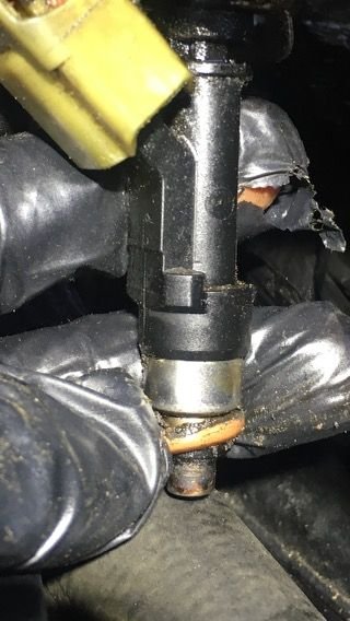

So today, I replaced the O- rings in on the Fuel Injectors. I mean I had them pulled out, they were all gunked up looking, so I figured why not?
also I tried to clean the best I could the fuel injector hole/ports. where the injectors sit, it was full or oil gunk or oil/carbon idk (see pictures)
Yes I still think y'all are correct, the Convertor/s are bad. The ford dealership said so last year. So once I get it back together the convertor will be the next job.

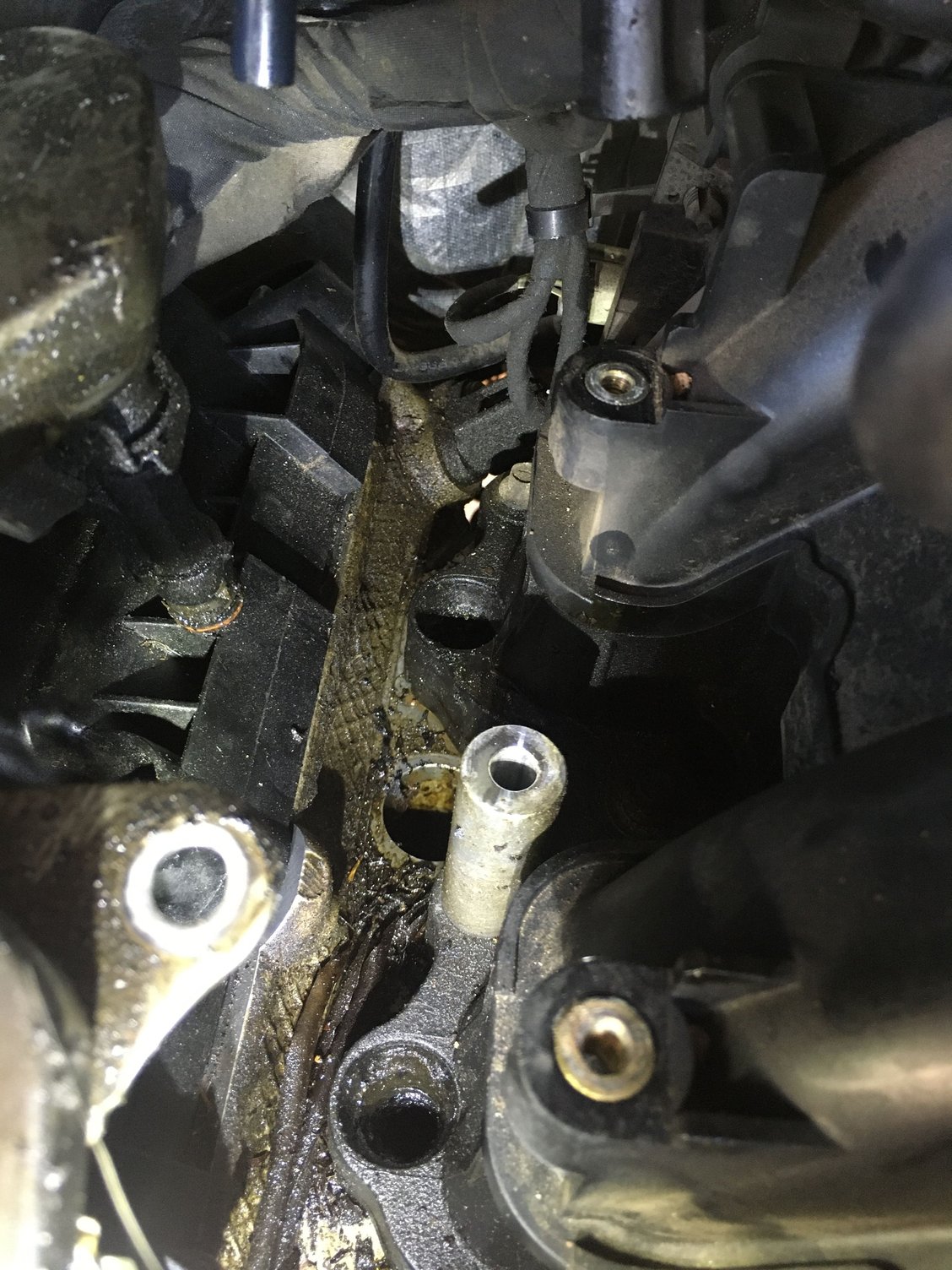

see the two spots where the gasket was.. weird
This is the rubber gasket that melted? or whatever happened here
check out the brown residue that's like only in the front part

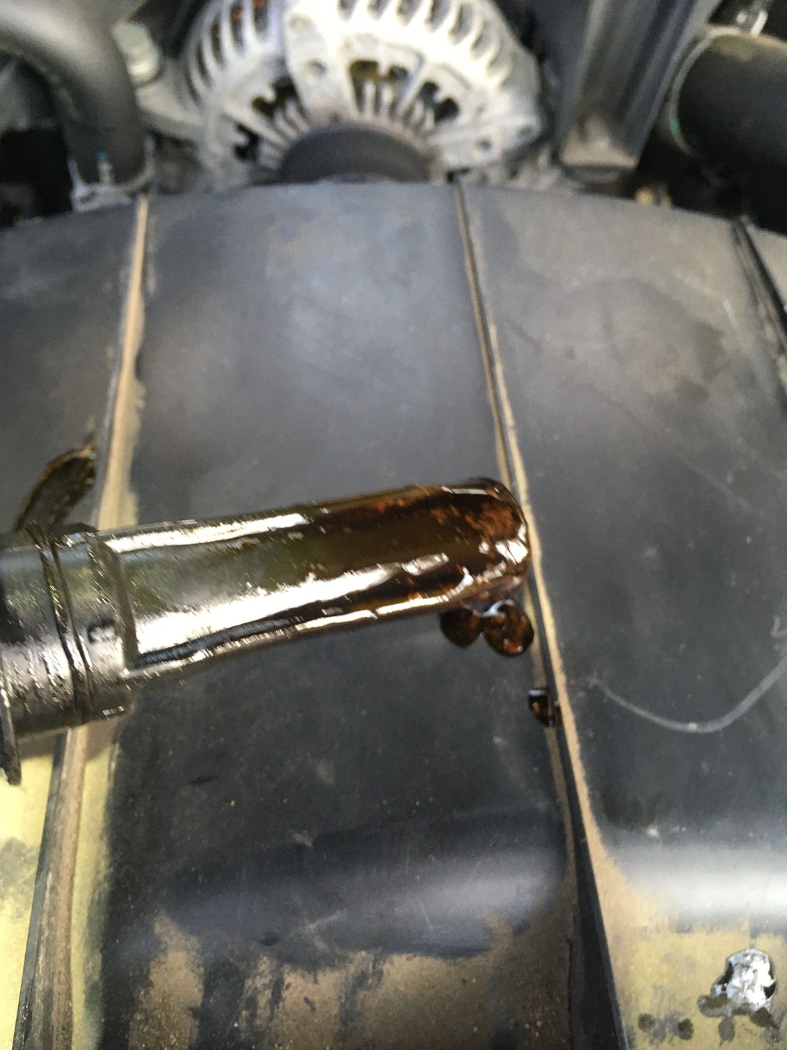

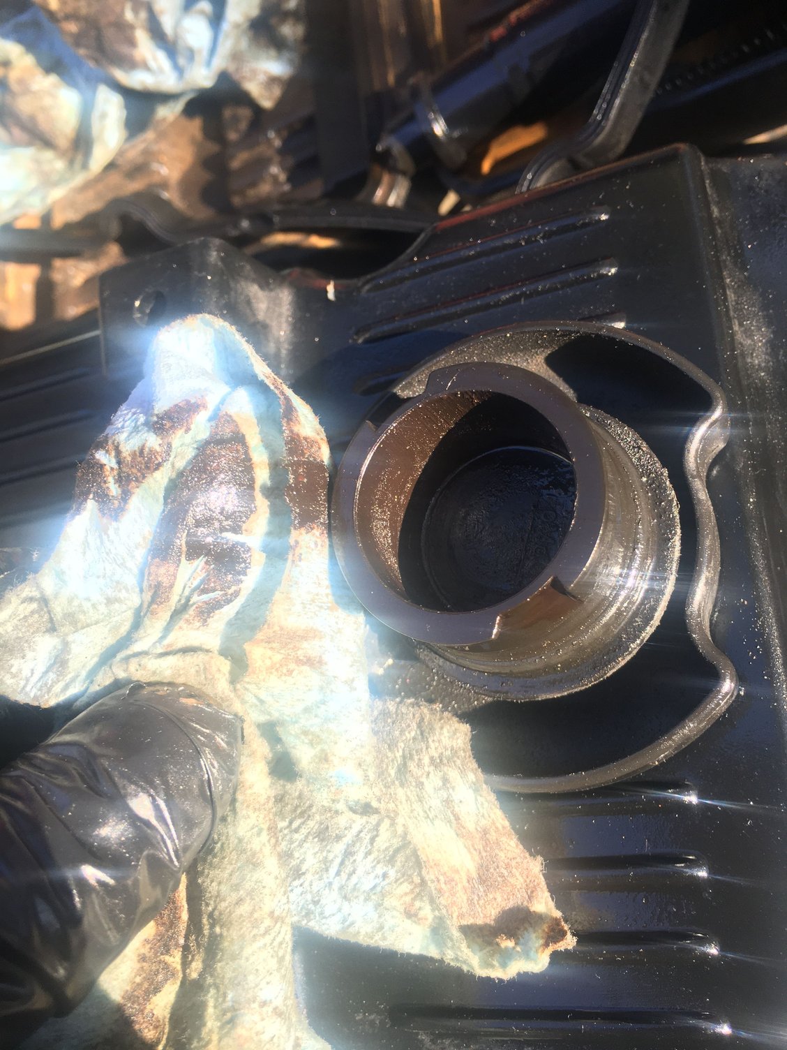

oil fill cap, has that brown sludge residue stuff, it was all underneath the valve cover as well.

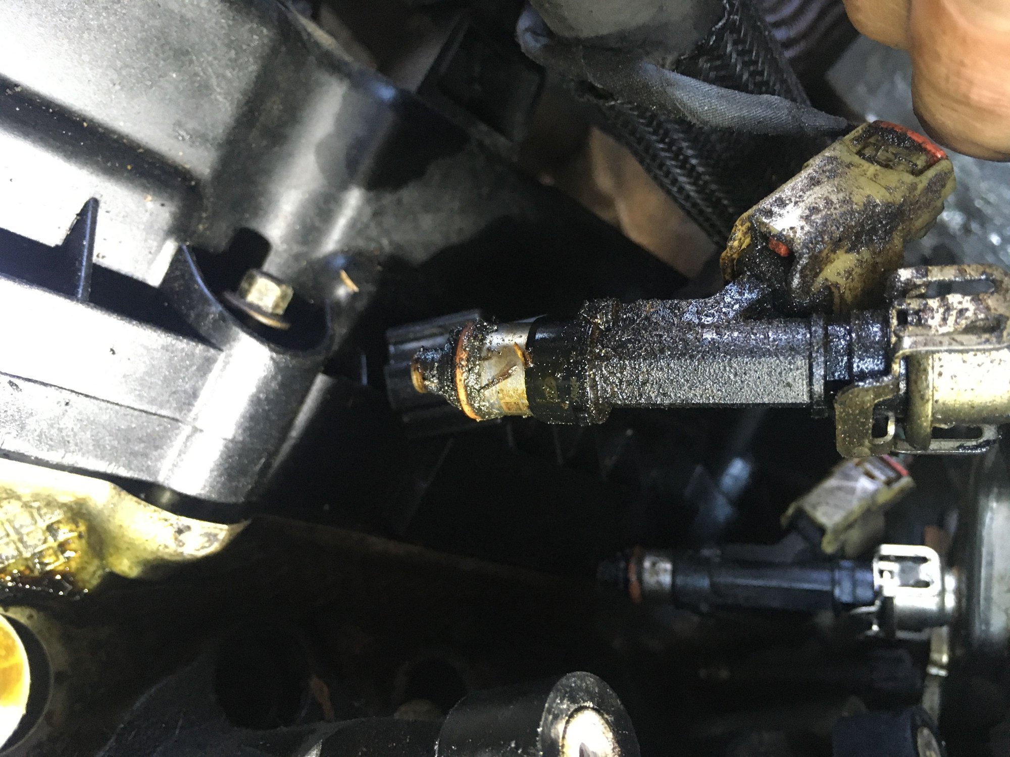

o ring with gunk all around it
fuel injector port.

Just an FYI. Those two spots with what you thought to be melted gasket are actually where the cylinder head meets the timing cover. The gasket was not melted, its actually proper practice to apply gasket maker to those spots prior to fitting the complete valve cover gasket. If you cleaned too aggressively and didn't apply gasket maker those two spots will leak oil as they are the start of a vertical seem and the horizontal valve cover gasket wont fill in that seem.
Same can be said for the guy before you who replaced that valve cover gasket and that spot on the top/inside to engine edge of the cylinder head is a leak point that would put oil right where you have your current problem.
