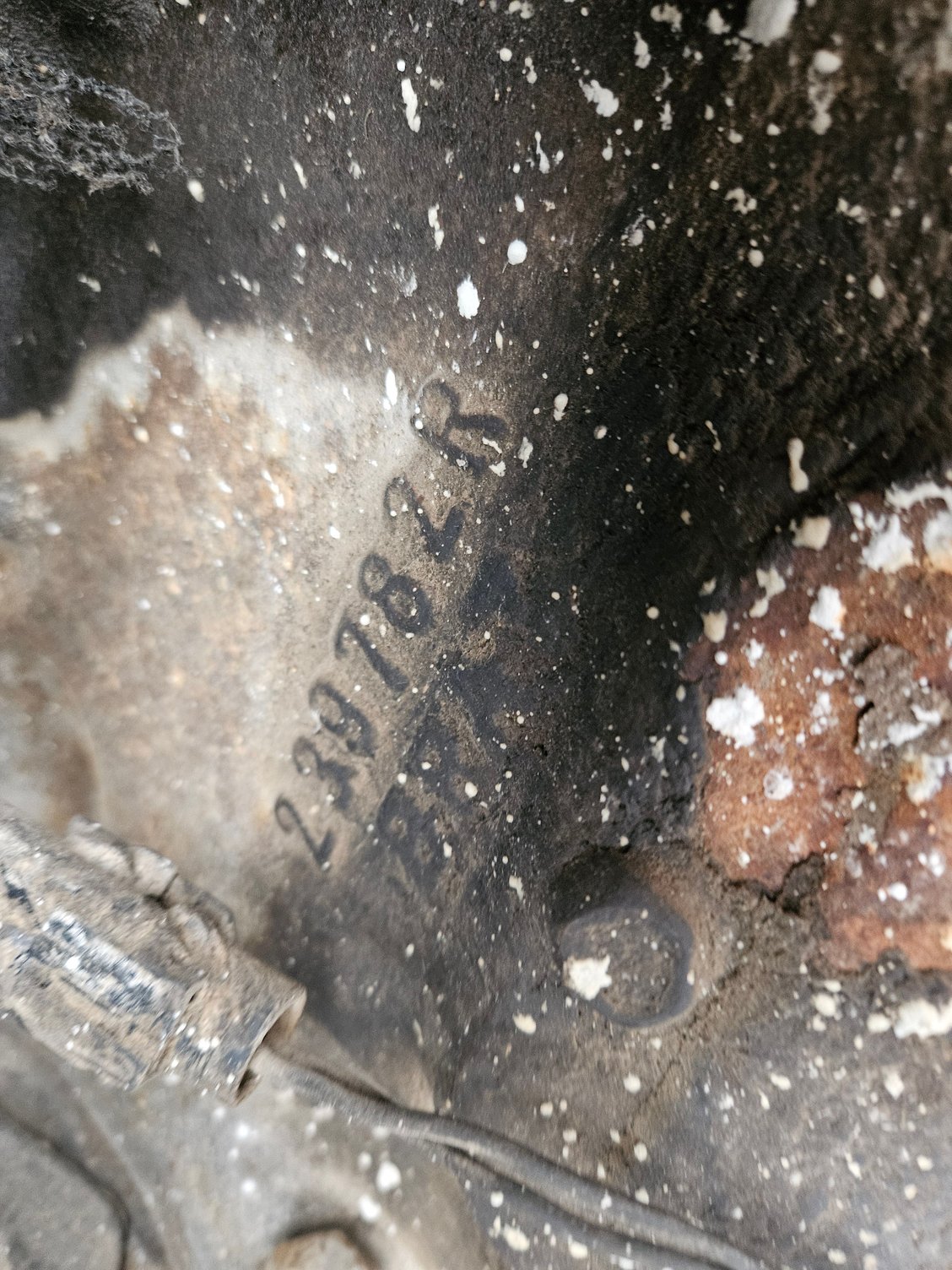

here is a picture.

Can you post pic of the certification label? (while plastic label with VIN, GVWR, GAWR etc)
The transmission and rear axle codes are two characters, the front axle is a single character but Y isn't showing.
Using the case number of 239782R, I find it is probably a variant of the Eaton/Clark CL450/455 transmissions, also cataloged as FS 4205_, again with several variations.
The MPC does not list FS 4205 transmissions, but does list 4005s and others.
Consolidation and takeovers and buyouts of transmission makers add to this issue, along with the infinite number of models.
The MPC I have is a very early copy and subsequent ones may have better info. Without paying for one, I have not found access to a later copy or anything easier to use.
Cross reference:
http://www.roadranger.com/ecm/groups..._apmt-0069.pdf
