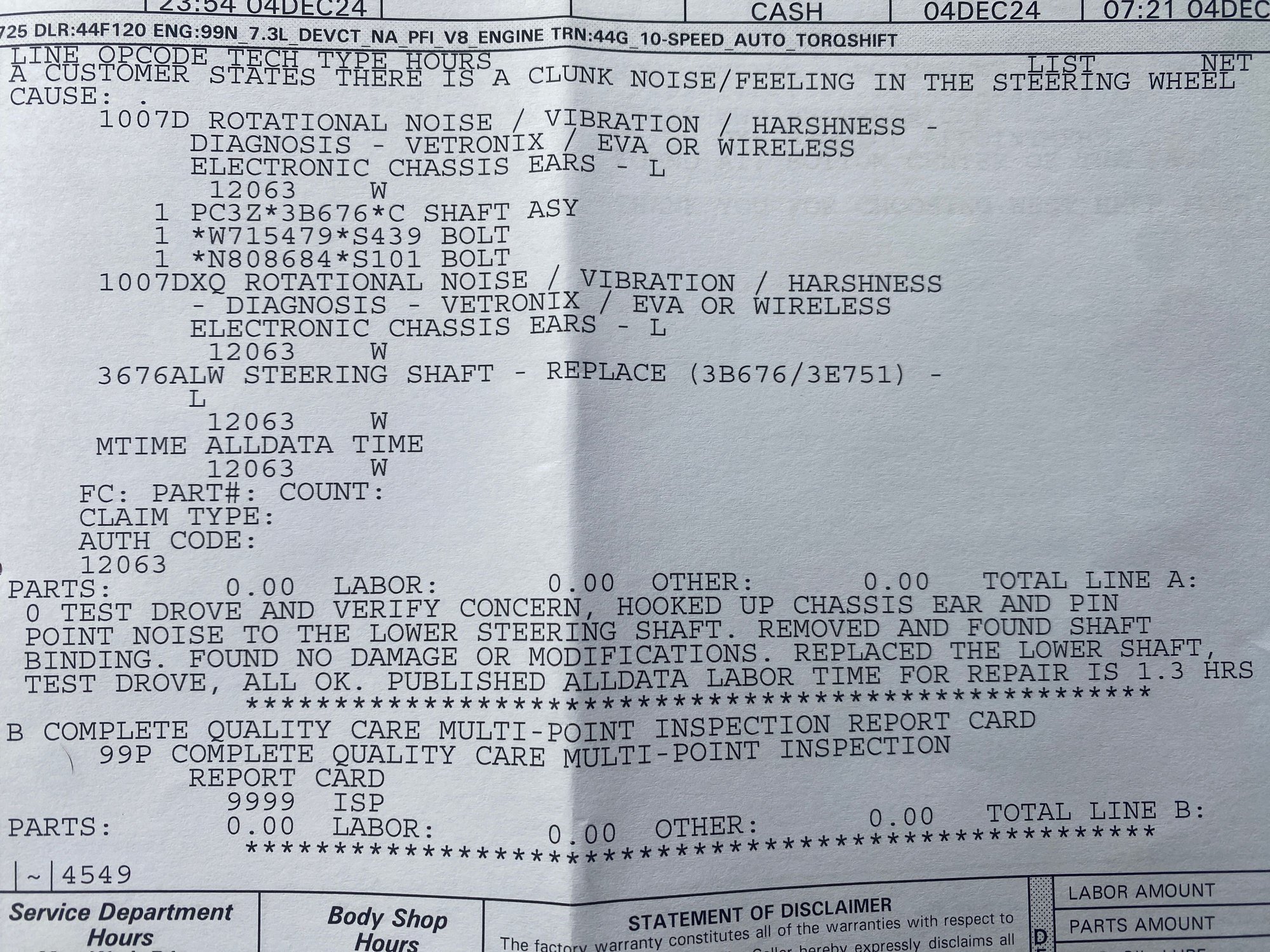

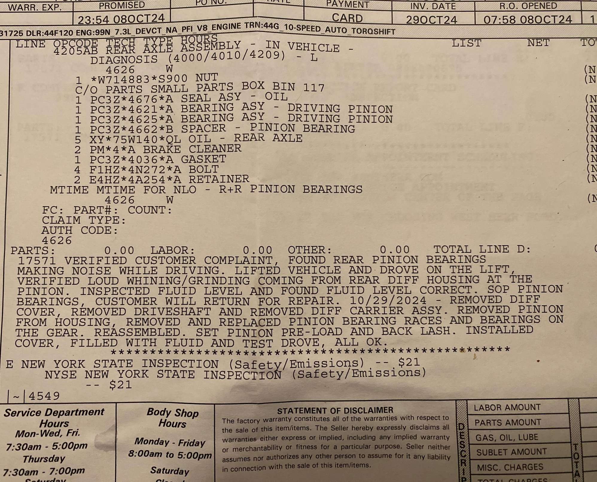

Just had it done.
Along with a rear axle work……
