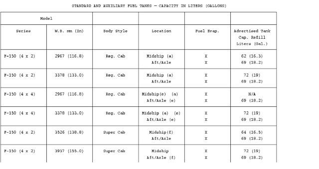

I own a 1994 f150 4x4 with a 133 wb, and the factory manual tells me a have a 19 gallon fuel tank in the front and an 18 in the back. But I recently ran the front one dry to test what it was, and it filled up with 16.8 gallons. I know that a 16 gallon was an option for shorter trucks, but was a 17 gallon an option?

You're always going to have a little left in the tank even after it runs out. 1-2 gallons of fluid spread out over a 1.5x4 foot area isn't going to be enough for the pump to pick up. I did the same thing with the rear tank on mine. Took 17.4 gallons to fill it back up after I ran it empty.

Sounds right to me. The sending units are set up to be pessimistic.
