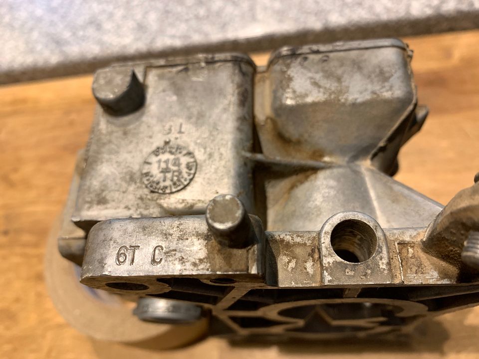

Ford used 9510 as the base number for most of their carburetors. To that a Prefix and a Suffix were added.
I like to use original Autolite 2100 carburetors. I had just picked up a couple of used ones to rebuild for my 1964 F100 with 292. The carburetors are fairly simple to rebuild as long as there are no hideous problems like cracks in the body or serious corrosion. All the small parts and gaskets are available in kit form.
A person can get just about as picky as they want with these projects. Carburetors were somewhat specific to engines and transmissions. For example, if the truck had Thermactor emissions system on it from the factory it may have prescribed one number of 2100 carb while a truck with an automatic transmission might have another number of 2100 carb.
The number or really a portion of the full number was often stamped into the base of the carburetor on the driver's side lowest flange. If you get lucky it might also have its original tag on it as well.
The original stamped identifying ID numbers (not part numbers) for a 1965 F100/250 with Standard transmission were.
C5TF-9510-B - aka C5TF-B - sometimes stamped just 5T B.
C5TF-9510-Y - aka C5TF-Y - sometimes stamped just 5T Y.
Other carbs from a 1966 that would fit the bill but not be 100% correct just because a 1966 carb on a 1965 truck wouldn't have happened.
C6TF-9510-T - aka C6TF-T - sometimes stamped just 6T T.
Since a 1965 didn't have Thermactor emmisions and your truck is not an automatic I'm not including any of those.
Part numbering with Ford sometimes works out fairly simple.
First digit C = 1960. A = 1940, B = 1950, D = 1970
Second digit 5 = 1965
Third digit T = Truck
Fourth digit F = Engine Accessories
9510 - it's a carburetor but that's all it'll tell you.
Suffix - this is the one thing that changes the most and distinguishes which exact carb it is.
For example, my 1966 F250 2WD with 352 and automatic transmission uses a C6TF-9510-C identifying number and this is what the stamping on the correct carb for it looks like.
At the link below is an example of a highly restored 1966 C6TF-T that one member posted recently.
1966 F100 352 stock carb question - Ford Truck Enthusiasts Forums (ford-trucks.com)
All of these ID numbers do cross reference to a part number which is oddly very rarely the same suffix. Talk about keeping it confusing...
And, just to take it one level further the ID tag on the @ibuzzard carburetor has a date code stamped on it. The 6FD signifies.
6 = 1966
F = June
D = Fourth week
So that would have most likely been on a July or August built 1966 truck. Possibly an early 1967.
